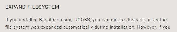

    You can achieve the same result using raspi-config. I think you'll find NOOBs already expands the SD card. Mark

    A quick note for all the Raspberry Pi users out there... You can achieve the same result using raspi-config.
    mcb1 over 11 years ago in reply to gadget.iom

    mcb1 over 11 years ago in reply to Problemchild
    No selection required...
    http://www.raspberrypi.org/documentation/configuration/raspi-config.md

    NOOBs installs Raspbian onto the SD card, which does the expanding as part of the process.
    It installs the normal raspbian menus, utilities and of course raspi-config is available.
    Unfortunately even if you copy it all to a new card that has more room you still can't expand it, so there must be a flag set somewhere.
