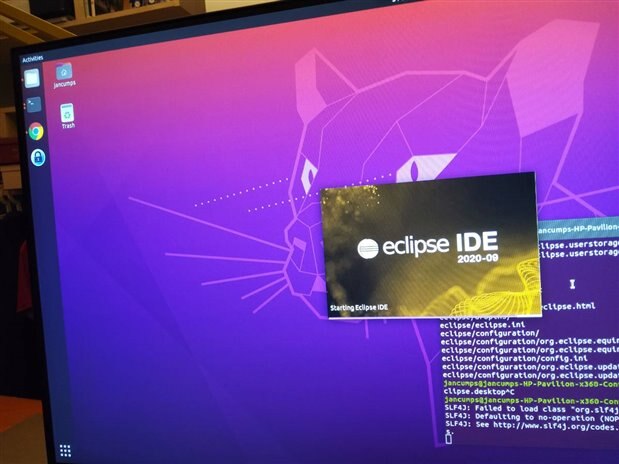

    Jan Cumps over 5 years ago in reply to Jan Cumps
    What happened:
    • One of my children had a defect laptop, and she needed a working one because in her last year of study.
    • HP declined support a week after purchase because a user issue (it turned out to be a real hardware issue - defect hard disk -  on the freshly purchased laptop but that is how the world turns if you have a student. HP and the reseller in Belgium are worthless if you are a customer).
    • I bought a new laptop so she could graduate.
    • Fixed the hardware issue without the support of HP and the reseller. With a solder iron.
    • Replaced Windows with Linux.
    Now I have a linux system that's strong enough to run a desktop and development  environment.
    No thanks at all to HP who declined service for a one week old laptop with a defect hard disk and no thanks at all to Van Den Borre Nieuwstraat Brussel where I purchased more than 5.000 Euro in year (including the laptop)  and could not care a single damn.
    Thank you to the internet friends that learned me how to fix.
