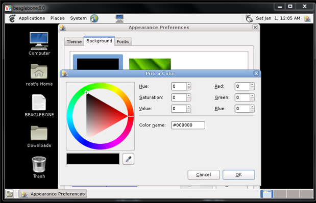

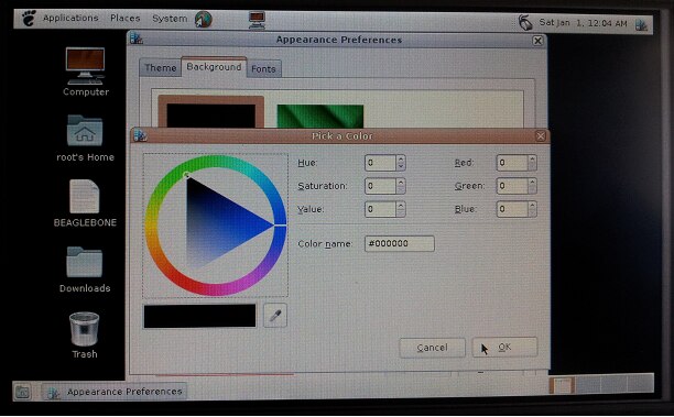

    Okay I thought I'd clarify the issue just so there is no confusion. I've attached two images which show the colour problem. One is a photograph of the LCD showing the colour wheel from the setting the desktop background colour.
    The second is the same image taken as a screenshot from a VNC connection of the same screen.
    You can see how the colour wheel is different in each.
    So after installing the software updates for BB view as supplied with the board for Angstrom on the standard build supplied with the Beaglebone Black the colours are incorrect.
    I know with the Debian beta there are issues as selsinork kindly identified but I would have thought that someone else with this combination of 7" LCD board and Beaglebone Black would have seen this. I don't think my board is faulty because the TI Demo software downloaded from this site works with the correct colours as far as I can see.

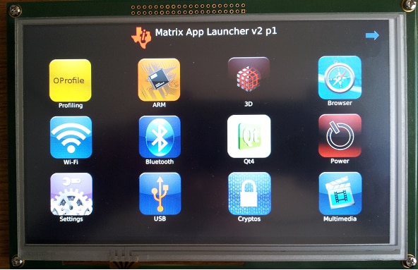

    This is an image from the TI Sitara Linux Trainng page
    http://processors.wiki.ti.com/index.php/Sitara_Linux_Training:_Hands_on_with_the_SDK
    Here is a picture from the LCD. (I know the icons are in a different order but the colours look correct, sorry about the picture quality)
