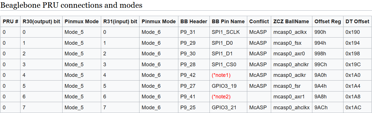

Enable the PRU output
Each pin on the BB has multiple modes. In the case of our simple blinky, we're expecting pin 27 on the P9 header to be used for PRU output. From the PRU's point of view this is PRU0, register R30 bit 5, but to the BeagleBone it's P9_27. You will find all these pin mappings here. To enable it, you will need to execute the following:
config-pin P9_27 pruout

    The problem is with the initial setting of the gpio variable (gpio=0x000F).  The 5th bit (0x0020), needs to be high "1" as it's routed to P9_27 pin (see table below).
    So setting gpio to 0x0020, or 0x00FF, or OxFFFF all works, but starting with 0x000F doesn't.
    I guess __R30 (bit 5) starts off as "0" so performing the XOR operation ( __R30 ^= gpio; ) with another "0" (0x000F) doesn't change it's value and no toggling occurs.
