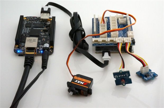

First though, lets make a start by getting the controller assembled. First, attach the Grove shield to the Arduino. Then, in the components you'll find a temperature sensor, a light and a light sensor  we'll get to the servo later. Plug the temperature sensors into the A0 (analog 0) port, a sideways connector on the lower left side of the Grove shield. This port and its other four siblings are able to read an analogue voltage from an electronic device making them ideal for non-digital sensors. Plug the light sensor into A1, just above A0.
And that's the hardware assembled:
Note that though the Arduino can be powered over the USB port from the BeagleBone it is better, especially when adding power-drawing devices like servos, to use a 9V power supply (or battery) for the microcontroller.

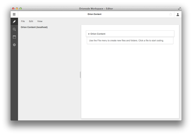

Go to your browser and browse to "http://beaglebone.local:8081/" if accessing remotely (localhost:8081 if local) and you should be greeted by the Orion user interface.
The icons at the left hand side set the view in the Orion IDE, the pencil shows the workspace and other directory/file views, the magnifying glass takes you to a search centric view and the rectangular icon, representing a console session, gives access to the Orion shell.

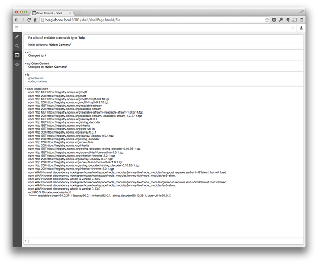

To install it, we use npm as we did earlier to install Orion, but now we can run it from within the shell. Go to the text field at the bottom of the Orion shell view and type:
npm install johnny-five
It'll look like this when it's done installing:

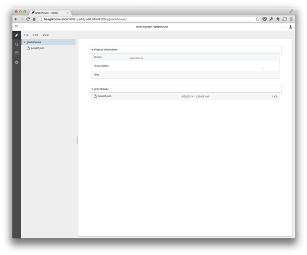

Click on the pencil to get the file view back and select from the Orion menu File » New » Project » Basic and enter greenhouse as our new project's name. This will move us into the directory for the new project in the viewer. Now select File » New » File and create a file called greenhouse.js.

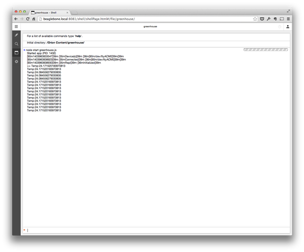

For now, we'll print the result to the console and end the tempsensor callback and the program's code.
        console.log("Temp:"+temperature);
Once we have selected File » Save to write the code to disk, we now have a program ready to run from the Orion shell. If we switch to the shell using the sidebar and click into the command entry panel at the bottom, we can begin typing. The shell will attempt to autocomplete for many things. Type "no" and it will suggest "node". To accept that suggestion, press Tab. We want to start a Node.js program, so type "st" and autocomplete will suggest "start", again press Tab to accept. At this point you can enter a filename but the shell is already anticipating that and will be offering filenames from the current directory; select greenhouse.js from the list and hit return.
The program should start running and, after initializing, start printing readings from the temperature sensor.
To stop it running, go to the command panel and enter node stop at which point the shell will offer process ids you can stop. There should only be one at this point so select that, hit Return and the process is stopped. We are now reading the sensor, the next step is to get that information out to the world.
Going MQTT
We're going to use the MQTT messaging protocol to send our data out. MQTT is built for this kind of task because it's lightweight and flexible. For this part of the example, suffice to say that with MQTT you can send messages with tags to what looks like (but isn't) a file-system hierarchy on a server. To make life easier, Eclipse runs a sandbox server at iot.eclipse.org so we'll use that as the MQTT server. What we need is MQTT support so go to the shell, make sure you are in the top level "Orion Content" directory (if not enter cd .. till you are) and then enter npm install mqtt to install the Node.js MQTT library.
After that's installed, return to Edit view and bring up greenhouse.js. After the require for johnny-five we want to add code to bring in MQTT and connect to the Eclipse sandbox...
