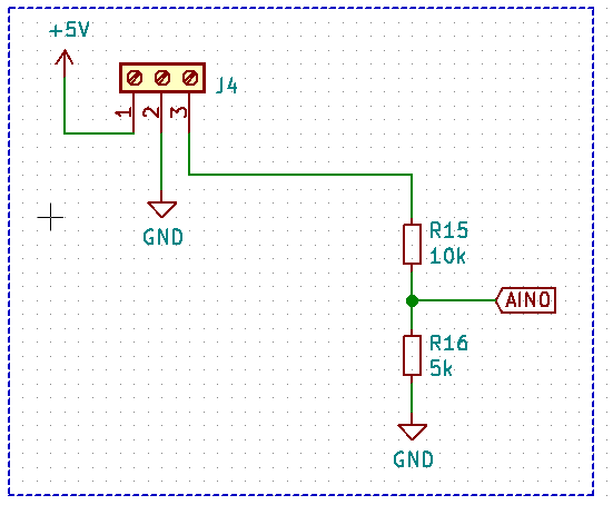

I am using this pressure sensor
https://www.amazon.com/dp/B07WR3NV3F/ref=cm_sw_r_cp_apa_i_csbSDbBGT3NZ1
for zero pressure/ room pressure, it outputs 0.5V and for 30psi it outputs 4.5V. I am trying to measure it with AIN0 (P1.19) on pocketbeagle . I am using iobb library.
This is my schematic
The ADC reads random values when sensor is connected to J4. But the multimeter reads correct voltage on Pin 3 J4 and on AIN0. Also If I try any other voltage via an additional voltage divider using +5V  connected to J4 and give 0.5V to pin 3 on J4, and not use the sensor  AIN0 reads correct value of 0.16V. Is this related to current ? I have also tried replacing R15 and R16 with 200K and 100K values hoping that it will reduce current leakage but that also doesn't work. Below is my example code.

    Just to give update, I have tried connecting the pressure sensor directly to AIN0, at normal room pressure, there is 0.5V output from the sensor, I can also measure 0.5V on the AIN0 pin but the ADC keeps…

    Do you have a spare opamp available? You could breadboard a buffer between tooutput and divider to check if it's due to the load at the output of the transducer.

    The first thing you should do is find the description of the ADC hardware in the data sheet and understand exactly how it works.
    If you would rather try a few more experiments then, based on you observation that 0.5V from a power supply work OK, try putting a 100nF cap in // with R16. - the reasoning being that if a meter shows 0.5V  the average voltage must be 0.5V, but if the ADC sees 0.5V from a low impedance source but not from the pressure sensor and its divider then there is likely something about its source impedance that doesn't work with the ADC. However, I wouldn't be that hopeful because most uP ADCs give consistent but wrong results if the source impedance is too high.
    You could try increasing open_dly and sample_dly, but this would be much better done when you know what they actually do !

    Thank you everyone for reply, it was a noisy power supply, 1000uF capacitor across power lines just before the sensor made it work, still not perfect but getting better results. If anyone has a better idea, I would appreciate.
