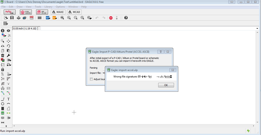

    0 echrisdenney over 9 years ago in reply to e14softwareteam
    I'm trying to do the same thing. I have designed a board in CM but I think I'd like to switch to Eagle. When I try to import the .CMPCBDoc I get an error. I'm using CM version 1.3 and Eagle version 8.0.1. Here's a screenshot of the error I'm getting
