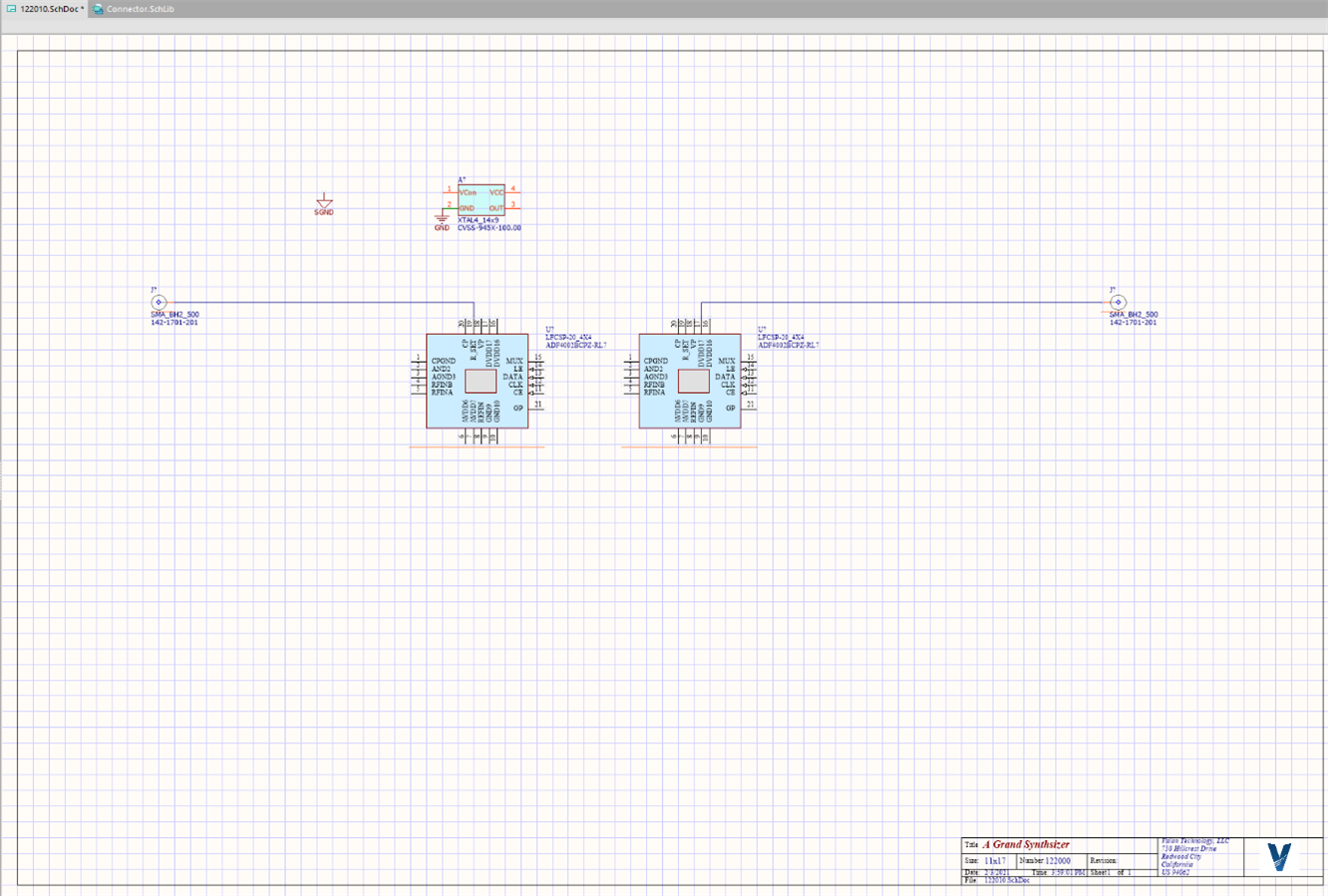

I am having a problem with scaling incorrectly when printing a B-size (aka tabloid or 11"x17") schematic document.  Here is where I'm at.
1. I have created a custom schematic template that is B-Size (11"x17") with custom title block and border.
2. Then I created a new project and new schematic using the B-size template.
3. The problem is the preview and hard copy have the schematic page scaled about 1/5th what it should be.
Shown above is the B-size schematic.
Above:  This is the printer preview and the resulting hard copy. Note the schematic has been reduced to about 1/5th scale.

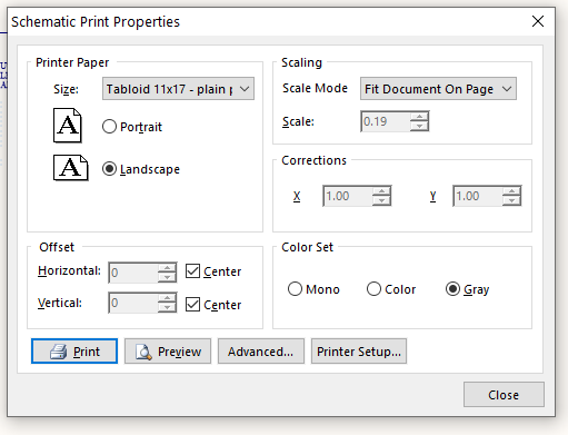

Here is the page setup, note the Scale: 0.19 or approximately 1/5th.

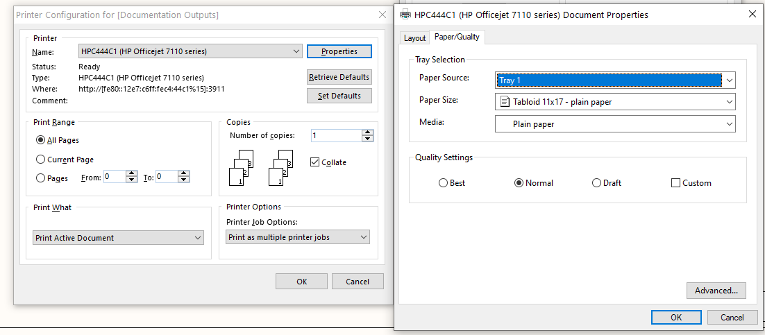

Here is the printer setup:

    Also, try printing to a different driver such as a PDF driver, instead of directly to the printer.
  • stuartrumley
    0 stuartrumley over 5 years ago in reply to tarribred61
    Okay Thomas, thank you for taking the time to find these previous post.  I'm looking into it in more detail.  I seem to be able to print the b-size.pdf okay and it fits the b-size sheet correctly.  Then when I print the b-size.pdf to my hp7110 the size comes out nicely as well.  I did make a color .pdf schematic and then printed that .pdf to the printer and that looks nice except for a very faint background color (should be no color-white paper).
