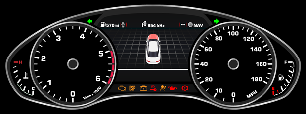

Figure 1: Car dashboard display with 1440 x 540 pixel resolution
Let’s take a typical modern automotive dashboard. The example shown in Figure 1 relies on a 12.3-inch stretched LCD display with 1440 x 540 pixel resolution. Given that the driver needs to be kept informed of all the different parameters relating to the vehicle’s operation (such as speed, RPM, tire pressure, fuel level, oil pressure, navigation data), the display requires real time response plus superior image quality.
The graphic controller devices currently available have difficulty in providing the required pixel clock necessary for certain standard or non-standard LCD panel formats. In our example, the 1440 x 540 resolution panel will require the pixel clock to be set around 50MHz in order to achieve the required 60Hz display refresh rate. Fast response is not just paramount in an automotive context though, in medical equipment or industrial hardware it can be equally important.

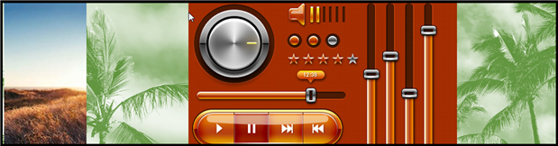

Figure 2: AV control panel with 1200 x 280 pixel resolution
