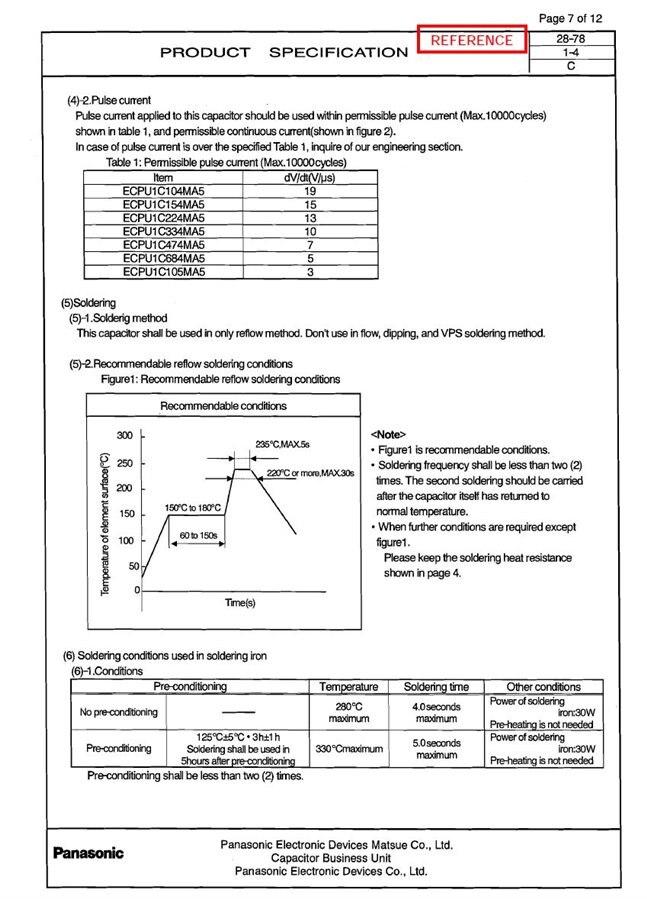

    moritzcehak over 4 years ago in reply to shabaz
    Dear Shabaz,
    Many thanks for using Panasonic Industry chip type film capacitors in your design - and of course for your comment!
    Beside soldering iron you mentioned, our chip film cap is also feasible for reflow soldering.
    As general recommendation for soldering condition, please refer to the following image of the specification data for ECPU(A).
    On this, you may find all possible soldering condition we recommend in detail.
    I hope this will be helpful for you.
    Best regards,
    Jing Liu
    Panasonic Industry Europe
