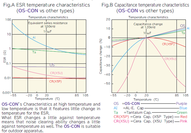

OS-CON: stable ESR and capacitance value over temperature v.s. other types.

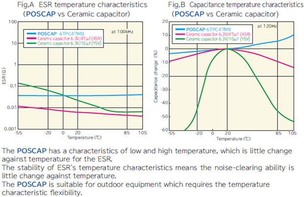

POSCAP: stable ESR and capacitance value over temperature v.s. ceramic capacitors.
