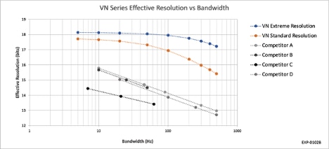

The VN026CM and VN131CM come with extreme resolution, which enhances the sensor's effective resolution, amplifies the dynamic range, and further lowers the noise floor by an additional 20db. With the industry's lowest noise floor, the VN026CM and VN131CM offer manufacturers unique single-sensor solutions that cater to a wide spectrum of respiratory requirements, from neonates to adults, for the first time.
Graph 1 – Comparing Extreme Resolution to Standard Resolution and Competitive Offerings
