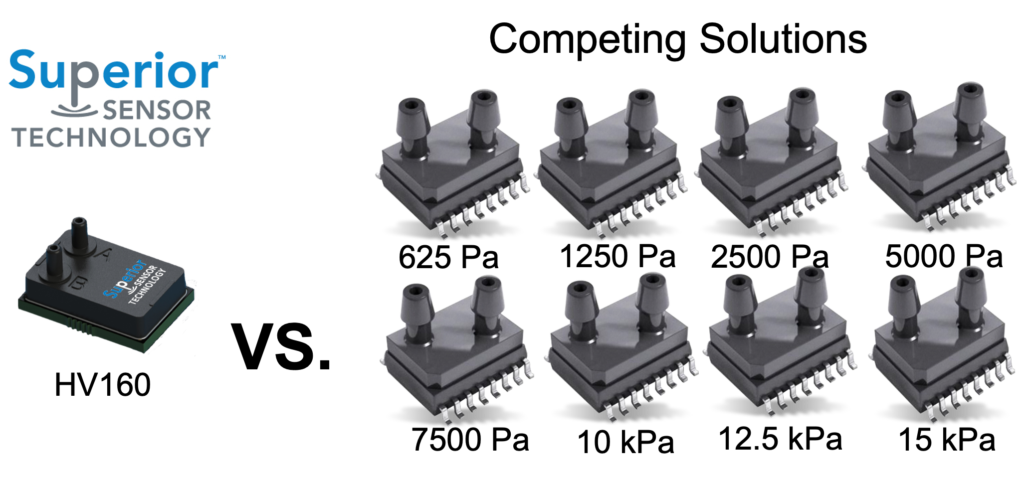

Figure 1:  Typical Pressure Sensor vs. Multi-Range Pressure Sensor

Figure 2:  1 Multi-Range Sensor Replaces Up To 8 ‘Ordinary’ Sensors
