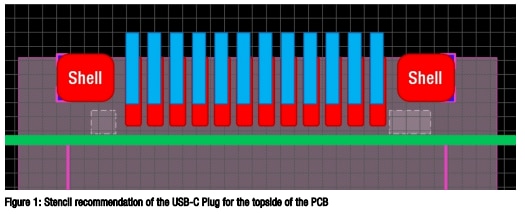

3. Processing the USB-C plug
The USB-C plug connector is not a classic connector assembled onto the PCB, but this component is shifted to the edge of the PCB. As a result, its component pads are located both on the underside and on the topside of the PCB. This poses a major challenge for effective and cost-effective process design. In order to achieve this, some adaptations are required in the stencil design as well as the production of a solder deposit on the underside of the PCB. The exact sequence of tasks required is listed below. 3.1. Stencil recommendation:
Underside of the PCB:
  • Reduce the stencil opening by 4% circumferentially relative to the pad (as an oblong opening)
  • Create a solder depot on the underside of the PCB with this first process step
Topside of the PCB:
  • Reduce the stencil opening (shown in blue in Fig. 1) in the pad area to a width of 0.20 mm (pad width 0.30 mm is shown in red in Fig. 1)
  • Place the stencil opening to the back by 1/3 of the pad length relative to the start of the pad (overprinting on the solder resist is intended and is important for the soldering process)
  • The reduction in width and the shift of the stencil opening prevents excessive extrusion of paste during the assembly process. The risk of short-circuiting is thus significantly reduced.
3.2. Assembly process:
1. If possible: Carry out solder paste printing on the underside of the PCB. With this process step, a solder deposit can be created (according to stencil recommendation for the underside of PCB in section 3.1).
2. Reflow soldering of the underside of the PCB.
3. Solder paste printing of the topside of the PCB using the stencil recommendation shown in Figure 1.
4. Assembly of the USB-C plug (whether automatic or manual assembly is possible depends on the production equipment).

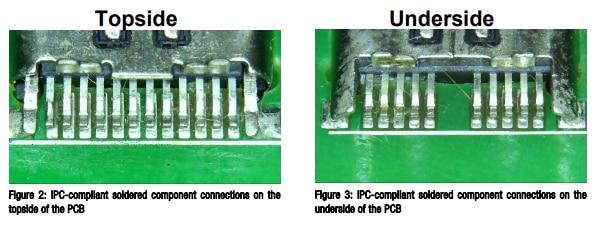

5. During the reflow soldering process, it is important that the USB-C enters the reflow oven with the connector face or pin row first. This prevents the USB-C from bending. This bending can occur if the solder paste of the pin row does not melt simultaneously.
6. AOI (automatic optical inspection) (see Figure 2 and 3)

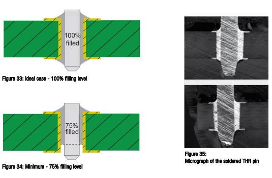

In USB-C hybrid variants, the 24 contacts are made up of twelve SMT and twelve THR contacts. In addition, there are four more housing pins in THR design. The mix of SMT and THR contacts confers significant mechanical advantages. The most decisive factors here are significantly higher retention forces on the PCB compared to a fully SMT design and minimization of soldering problems as a result of insufficient coplanarity of the consecutive rows of pins. The pin mix and the very compact design of the USB-C hybrid type means it is a challenge to get enough solder paste around the THR pad as well as into its hole. The required process parameters as well as the exact stencil drawings (see Figs. 4 to 7) are listed in the following bullet points.
4.1. Solder paste print parameters:
  • Use solder paste with a grain size of 5.
  • Implementation of a second printing process (i.e. a second printing cycle immediately follows the first without lifting the stencil from the PCB). This favors greater penetration of the solder paste into the depth of the hole.

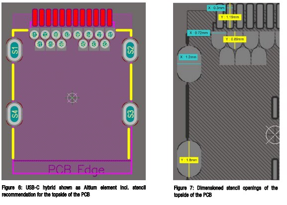

4.2. Stencil recommendations:
Topside of the PCB

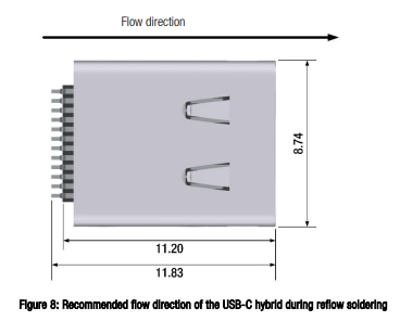

4.3. Assembly process:
1. If possible: Provide for solder paste printing on the underside of the PCB. Please use the stencil recommendation shown in Figs. 4 and 5. This process step can be used to create a solder deposit on the underside of the PCB. However, it must be ensured that no solder paste enters the hole. This would make it difficult or even impossible to assemble the USB-C later in the process.
3. Solder paste printing of the topside of the PCB using the stencil recommendation shown in Figs. 6 and 7. It is recommended to carry out a print check for prototypes, initial series and production starts. The solder paste print is optically inspected and measured. The filling level of the paste after the printing process is particularly important for the USB-C soldering process. This should ideally correspond to approx. 75% of the hole depth.
4. Carry out the assembly of the USB-C using a pick and place machine. The component 632723100011 can be used up to a PCB thickness of 1.3 mm. Please reduce the settling speed here too. The slower this is selected, the less likely it is to push or punch the paste out of the hole. This inevitably leads to a deterioration of the soldering result.
5. During the reflow soldering process, it is recommended that the USB-C enters the reflow oven with the connector face or pin row first (see Figure 8). This prevents the USB-C from bending. This bending can occur if the solder paste of the pin row does not melt simultaneously.
6. Perform AOI for the visible pins. The hidden pins can be checked and the filling level determined by X-ray.

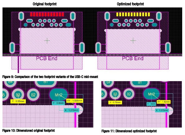

5. Layout tips for the USB-C mid-mount
To facilitate the routing of the differential pairs B2/B3 and B10/B11, it is possible to increase the distance to the milled edge in deviation from the layout recommendation. Assuming a milling cutter with a diameter of 0.50 mm and a resulting radius of 0.25 mm, which is common in PCB production, the distance from the center of the lowest row of pins to the center of the milling contour can be changed as follows:
According to the data sheet, a distance of 0.80 mm is specified for this. This results in a distance of 0.55 mm from the center of the row of pins to the milled edge. Thus, the width available for routing is only 225 µm. The area between the pad rest-ring and the milling contour can be increased by 200 µm by increasing the distance from the center of the lowest pin row to the center of the milling contour to 1.00 mm. Figures 9 to 11 show the dimensioned displacement of the milled edge. The 425 µm now available is sufficient for routing the differential pairs (125 µm per track).
Contrary to the data sheet, the oblong holes B1 and B12 can also be designed as drilled holes similar to B2 to B11. This simplifies the PCB manufacturing process.

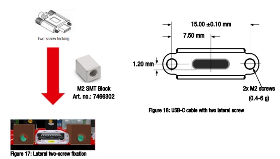

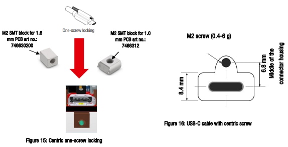

7. Use of the SMD spacer for cable fixation
Würth Elektronik offers SMD spacers in addition to the existing USB-C connectors and cables. These allow screwable USB-C cables to be integrated into the system. There are two types of locking, cables that are fixed with a central screw and cables that are fixed with two screws along the edge. The layout excerpt in Figure 14 shows the placement of these spacers in relation to the USB-C connector. The two SMD spacers for lateral two-screw locking are shown in red and the one SMD spacer for centric one-screw locking is shown in blue. Solder bridges may occur when locking the cable with the two lateral screws, due to the very small distance between the USB-C shield lances and the SMD spacer. However, these do not adversely affect the system functionality (same potential) and do not necessarily have to be corrected / reworked.
7.1. Locking types:
7.2. Types of installation:
Integration of the PCB into a housing:

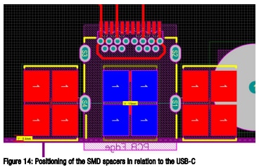

  • The spacers must be positioned at the edge of the PCB (solder pads of the spacer are located 0.40 mm behind the edge of the PCB and therefore do not interfere with PCB manufacture or the assembly and soldering process) (see layout Figure 14 & Figure 19 after assembly).
  • The USB-C connector is placed up to the front edge of the housing and thus beyond the edge of the PCB.
Assembly without housing:
  • The spacers must be positioned at the edge of the PCB.
  • Caution: For centric one-screw fixation, the USB-C connector must be placed at the PCB edge, contrary to the layout recommendation. Otherwise, the cable connector may bend when tightening the screw. As a result, mechanical and electrical damage can occur to the component as well as to the entire device.
  • This mechanical torsion cannot occur with the two-screw system. This allows the USB-C connector to be placed both at the edge of the PCB and beyond.

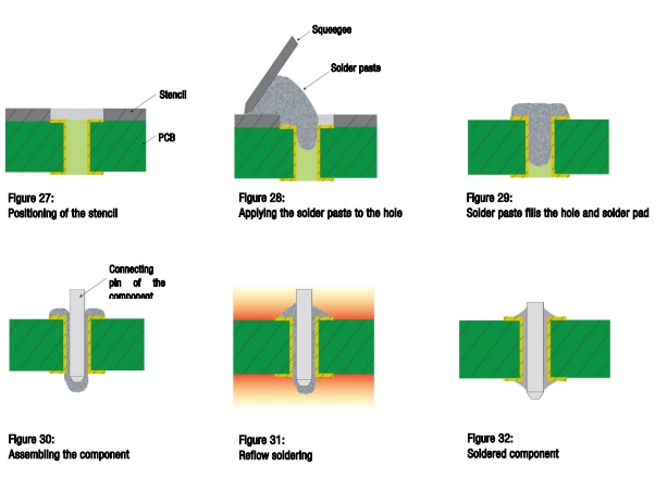

Appendix: Basis of calculation of the THR process
Layout suggestion and volume calculation of the PCB (drilled hole)
  • The volume calculation for the drilled hole
  • Tb: PCB thickness o Dh: Hole diameter = pin diameter + 0.3 mm for round pins
    • (0.25 mm for rectangular pins)
  • Dsp: Solder pad diameter = Dh (+0.6 to 0.8 mm)
Volume calculation for the pin
  • Vpin = π x pin radius² x PCB thickness
  • For round pins: image
  • For rectangular pins:image
Volume calculation for the fillet according to the Pappus-Guldin formula
  • Vfillet = 0.215 x C² x (0.2334 x C + pin radius) x 2 π
  • image

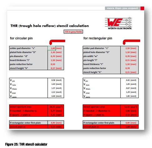

Calculation for the solder paste volume and the stencil opening
  • Volume of solder paste = Vpaste = (2x Vfillet + Vpcb - Vpin) x 2
  • The total volume is taken x2, as standard solder pastes have a metallic content of 50%.
  • image
  • Caution: How deep the paste is pressed into the hole
    • depends on the diameter and height of the stencil.
    • This is also influenced by the printing parameters: print cycles,
    • force, speed and the squeegee angle.
