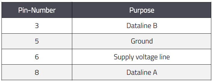

Table 1: Pin assignment.
Before the selection of the components for the filter circuit is made, the required effect is defined. The selected RS-485 interface requires a high level of protection against common mode interference over the entire frequency range. In addition, all signals with frequencies that do not correspond to the transmission standard should be attenuated. There must also be protection against overvoltages on the data lines. The supply voltage line should provide a uniform and interference-free voltage.

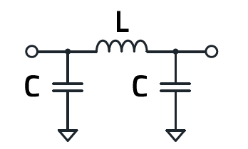

Figure 9: 3rd order low pass filter.
As a result of its design, which is looking like a π, it is often referred to as a Pi filter. In order to select suitable components that meet the requirements of the filter, the online tool REDEXPERT is used.
The first step is to select the right inductance. It should be noted that a current of 200 mA flows on the supply voltage line. This is important because an inductor designed for lower currents would be strongly heated. To prevent this, a PCB ferrite with a rated current of IR = 500 mA is selected. This means that the ferrite heats up only 40 K at a current of 500 mA. In addition, the inductance should counteract currents and voltages with frequency components with a certain impedance. The following figure 10 shows the impedance curve of the selected PCB ferrite, which increases with frequency. Furthermore REDEXPERT makes it possible to display impedance curves at different currents. Here 200 mA was selected based on the application.

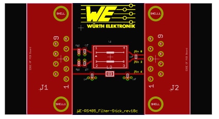

In general it is important to keep the filter stick as compact as possible. The components are all placed on the top side of the board. Only the connectors have to be soldered on the underside due to their THT construction. In order to avoid reflections, care must be taken that the tracks are not at right angles. Rounded paths and 45° angles ensure a better signal flow. In addition, it is also important to place the components directly on the tracks to keep the paths short.
Figure 16 shows the complete board design. In the layout of the data lines, the ESD suppressors are placed near the input connector to divert ESD pulses as quickly as possible. All other components follow at short intervals. However, the components should not be placed directly next to each other, otherwise undesired capacitive coupling could occur. Both data lines should have the same length due to the symmetrical signal transmission. Plated, through-hole vias are used for connection to ground. They are placed next to the pads and form a conductive connection to the underside of the board, which represents the ground potential. In the layout of the supply voltage line, the two pin 6s are connected with a straight line. In the same principle as explained above, the components are placed directly on the line. Due to the available space, several vias are attached to the capacitors in order to make the connection to the ground potential as low-impedance as possible.
Both pin 5s and the housing surface are connected to ground. The black edges represent the space required by the protruding D-SUB connector.
Figure 16: Complete filter stick design.

    just uploaded the new schematic. Thanks again for drawing attention.
  • Würth Elektronik
    Würth Elektronik over 3 years ago in reply to beacon_dave
    hi beacon_dave , thank you for the feedback there really was an error from our side. It would be correct like that:
    we will change it asap.
  • beacon_dave
    beacon_dave over 3 years ago
    The pin numbering for pins 5 & 6 on CON 2 looks like they have been accidentally flipped ?
