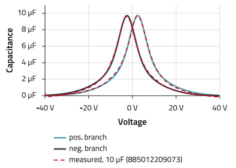

Ferroelectric polarization is well studied and shall be reviewed briefly. [1][9][13] The polarization behavior of ferroelectric materials depends on the actual state of polarization, as shall be discussed with the capacitance-voltage and polarizationvoltage graphs of a 10 µF MLCC (class 2), shown in Figure 2. During the measurement, a sinus probing waveform of frequency f is applied to measure the capacitance of the capacitor. The ac probing waveform has a fixed amplitude throughout the measurement and induces a periodical change of voltage dV. On the sinus signal, a dc voltage is superimposed, allowing the reorientation of the domain polarization.
Figure 2: TOP: Measured capacitance-voltage characteristics of 10µF MLCC, for a voltage cycle, shown in the inset graph. BOTTOM: Polarization-voltage characteristics with corresponding schematic depiction of dipole orientation.
Branch 1:
The capacitor, with randomly oriented domain polarizations, is subjected to the test signal. With the increase of dc voltage, the dipoles eventually become aligned, leading to increased polarization (Figure 2). Saturation polarization is reached when all dipoles ideally point in the direction of the external electric field. As the voltage increases, the dipoles become aligned and the dipole movement becomes more restricted, which leads to a reduced charge change of charge dq. Hence, the capacitance C = dq/dV decreases with increasing dc voltage.
When the applied external field E, which is proportional to the applied voltage, has aligned the majority of the domains, the dipoles remain in this position even without the external field. The collective alignment creates an internal stabilizing coercive field, Ec. As the applied electric field increases, the overall polarization increases due to other polarization effects such as electronic, ionic and dipolar types.
The polarization at maximum voltage is referred to as saturation polarization Psat. In principle, the spontaneous polarization Ps is equal to the saturation polarization of the electric displacement extrapolated to zero field strength.
Branch 2:
As the voltage, and with that, the external field, is reversed from positive to negative, the dipoles relax slightly but remain in their overall polarization direction due to the internal coercive field, Ec. The polarization state at zero volts is referred to as remanent polarization Pr. Any reversed external electric field will have to exceed Ec in order to reorient all domains into the opposite direction. At the position of Ec the strain on the dipoles is least, thus the materials permittivity (susceptibility) is largest and the capacitance shows a local maximum. With the increase of polarization into the opposite direction, the capacitance decreases to the same value as for positive voltages.
Branch 3:
If the voltage is driven from negative to positive, the dipoles reorient again when the externally applied field exceeds the coercive field. This, again, leads to a peak at the capacitance at positive voltages. The process is similar to the one described before. Branch 3 is similar to branch 2, except it is shifted along the x-axis toward positive voltages. The above-described hysteresis requires the distinction between the polarizations for voltage sweeps from positive to negative and vice versa. Therefore, in the further course, P+(E) denotes the polarization (branch 2) for voltage sweeps from positive to negative and P- (E) (branch 3) the polarization for voltage weeps from negative to positive voltages.
Hence, any increase in dc voltage leads to a decrease in capacitance. However, the capacitance is further decreased with an increasing application time of dc voltage. That further decrease is related to the retarded movement of the domain walls, caused by domain wall pinning. [14][15][16][17] Domain wall motion takes place on a longer timescale than the initial reorientation of dipoles, which occurs on a sub-second timescale. [19] Domain wall movement generally leads to an additional gradual decrease of the capacitance of up to 20 %, which can take place over a period of up to 1000 hours. [14][15] This long-term effect should only be mentioned at this point for the sake of completeness and to hint at the complexity of dc measurements. However, for the sake of clarity, the note will keep the focus on the dc dependency.

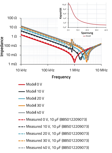

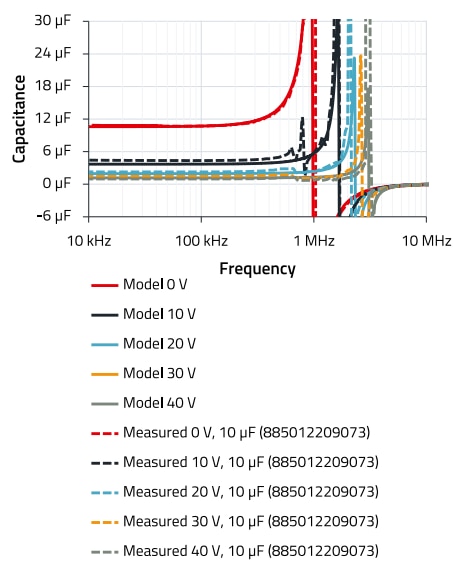

06. IMPLEMENTATION: FREQUENCY AND VOLTAGE-DEPENDENT MODEL
In the previous sections, we mainly discussed the voltage dependence of the model. However, for applications such as filters and converters, it will be important that the model describes the frequency behavior correctly as well. Typically, the impedance of capacitors are modelled with
image(7)
with ω = 2 π f as angular frequency, i=√(-1) as imaginary unit, RESR as equivalent series resistance, Rins as insulation resistance, L as parasitic inductance and C(V) as the voltagedependent capacitance, given by equ. (5). Each capacitor is consequently modeled by an individual set of parameters: a, b, h, Cs, Vmax, RESR, Rins as well as L.
The impedance model Z(ω,V) (equ. (7)) assumes the same frequency behavior for Cs and Cp, which might not be the case in reality. The hysteresis behavior depends on the scanning frequency, i.e. the voltage rise time, of the dc voltage. [19]That implies the model is most accurate when the ac voltage is about or smaller than the coercive voltage Vc. Thus, we estimate that the model is accurate, if the ac voltage amplitude is below 10% of the rated voltage.
Figure 5: Measured and calculated impedance spectra for different dc-voltages. Inset graph shows corresponding C-V function.
Figure 6: Measured and calculated capacitance spectra for different dc-voltages.
Figure 5 and Figure 6 show a good agreement of the calculated graphs with the measured impedance and capacitance spectra, respectively, for different voltages. The spectra were taken after a pre-conditioning time of 40 h to include the effect of domain wall switching. The inset graph in Figure 5 shows the corresponding capacitance-voltage function, as obtained with the parameters, given in Table 1.

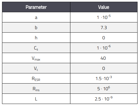

Table 1: Fitting parameters with units as used for graphs in Figure 5 and Figure 6.
In this example, the deviations between the theoretical and measured spectra are caused by the slight deficiencies the capacitance model may have at intermediate values. Considering the difficulties in precisely measuring the longterm dc effect, we assess the accuracy as satisfactory for practical application. The cause of the small spikes (noise) just below 106 Hz in the graphs measured with applied dc-voltage could not be clearly identified. The fact that they are in different graphs roughly in the same frequency range could indicate a setup-related measurement artifact.
Due to the manifold of influencing parameters on ferroelectricity such as temperature, domain wall switching dynamics, voltage aging and slight variations of chemical compositions of raw materials, the exact modeling of C-V characteristics is a challenge. Because of the complexity of the issue, it remains necessary that electrical engineers complement model-based data with application-based tests and measurements.

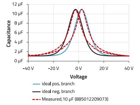

A.1 Alternative Mathematical Model
As an alternative approach, we propose the modified equation
image(8)
which allows the change of the slope gradient by the exponent c. Although c is not directly related to a physical quantity, its introduction significantly simplifies the model. Thus, the measured capacitance can be fitted with
image(9)
With this set of five parameters a,b,c,VC and Cs it is possible to model the measured voltage-dependent capacitance with sufficient accuracy as demonstrated in Figure 7. The first term of equ. (9)
image(10)
models the voltage-dependent contribution of polarization to the capacitance and Cs, the voltage-independent pure capacitive part.
Figure 7: Measured capacitance-voltage characteristic of 10 µF MLCC with the corresponding fit of equ. (9). Dimensionless numerical fitparameters: a=10.85, b=1.3, c=0.17, Cs=1.09, VC=2.5.
Although the numeric and symbolic integration for equ. (9) is always possible, the symbolic integration may involve hypergeometric functions, which may not be supported in the simulation software. This can be avoided for c=1 and c=2 as shown below. Under these conditions, the model of the capacitance and its charge, Δq, as calculated with equ.(6), can be expressed with trigonometric functions. Trigonometric functions are usually implemented in the script language of the simulation tools, such as LTspice.

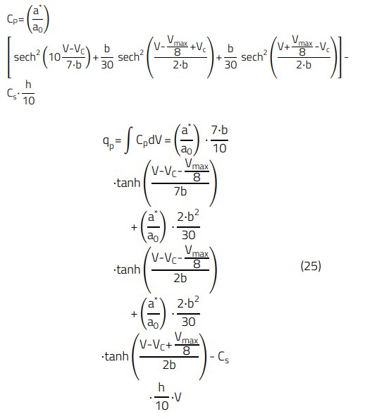

Example of calculation for CP in equation (3):
