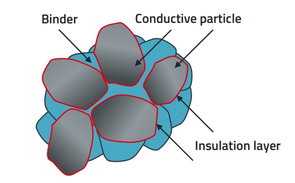

For composite material, percolation phenomenon occurs when the increasing amount of added conductive metallic particles reaches a point where the electrical conductivity increases abruptly. This is the so called percolation threshold[6] . Particularly, many experiments have demonstrated that the conductivity of composites has a nonlinear relationship with the doping of conductive particles[7] . Composites are materials made by combining two or more elements, natural or artificial, which are stronger together than individually.
In the case of molded power inductors, the preferred solution for better performance is Soft Magnetic Composites, or SMCs. These composites are advanced materials engineered for their magnetic properties. Unlike traditional magnetic materials, SMCs are comprised of iron alloy powder particles coated with a thin insulation layer dispersed in a non-conducting matrix, such as epoxy or polymer binder. Molded power inductors based on SMCs depend on the insulation layer and binders to reduce the overall amount of eddy current losses, i.e. conductivity between particles[2] , as shown in the Figure 1:
Figure 1: Typical components on SMCs [2]

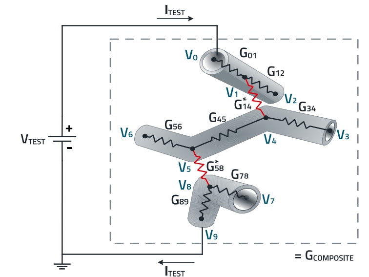

Figure 2: Equivalent electrical circuit used to illustrate the growth of a percolation network on composite materials based on [11]
In the figure the red resistors represent the new conductive connections between the exposed iron particles of the material itself. This connection leads to the creation of clusters that can deteriorate the molded power inductor, from small areas to the complete material, as illustrated in the Figure 3.

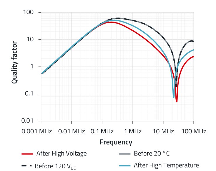

To corroborate the percolation phenomenon due to higher voltage or higher temperatures, a new setup has been prepared for this application note. A total of 20 samples of a 4.7 µH molded power inductor was taken from the same production lot number, all with similar electrical performance. Ten samples were used for a high voltage test and 10 samples for a thermal aging test. The inductors were measured at an ambient temperature of 20 °C.
The degradation mechanism was triggered by the continued exposure at a temperature of 160 °C for an extended period of 300 h for the aging test. The high voltage test was accomplished by using a modular impulse generator to expose the inductors to a series of controlled pulses.
In the voltage test, the first round of voltage pulses was chosen close to be 120 Vdc, which is the limit recommend by the manufacturer’s datasheet. The applied pulses had a duration of 36 µs per pulse, following the recommendation of the IEC61000-4-5 standard for the rise and fall time of the pulses. In total 35 pulses were applied to each inductor to assess any impact.
After that validation, the inductors were subjected to an overvoltage round of pulses. The summary of pre and post test results is shown in Figure 5.
Figure 5: Change of the Q factor due to high temperature or high voltage exposure.
The black dash line refers to the average quality factor Q vs. Frequency curve of the first 10 samples before exposure to higher temperatures, and the gray line corresponds to the other 10 samples after the first round of pulses below the 120 Vdc. As can be seen, both curves show the same behavior. The red line corresponds to the average of the Q value vs. Frequency after high voltage exposure with pulses around 190 Vdc.
The voltage represents a 60% increase over the voltage limit supported by the non-conducting matrix mentioned earlier. From previous experience with the selected inductor, a voltage of 240 Vdc generates cracks on the component with the first few pulses.
A total of 10 pulses of 190 Vdc were applied. No cracks have been found, but there is an evident change on the Q curve. Finally, the blue line corresponds to the average Q after high temperature exposure exhibiting an impact, as expected. It can be observed, both test averages show the same reduction of the quality factor at higher frequencies and a small change in the resonance frequency.
It is necessary to remark that percolation starts at different points inside the core of the inductor due to the physical effects induced by the test, which could be associated with either electrical or thermal percolation.
However, the trend is undeniable. Furthermore, with more exposure time the percolation will lead to a continuous decrease of the Q curve in a shorter time, as introduced in ANP128[2]. The results for the case or thermal aging degradation at 200 0 C for 5000 h is presented in the following figure.

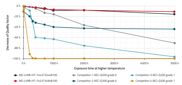

Figure 6: Decrease of Q value at 2 MHz during 5000 h at 200 °C.
The measured Q value at 2 MHz shows that even the best competitor shows a decrease greater than 40% while our High Temperature version of our new family WE-LHMI 7443732448100 and WE-LHMI 7443734948100 show a minimal decrease in the performance.

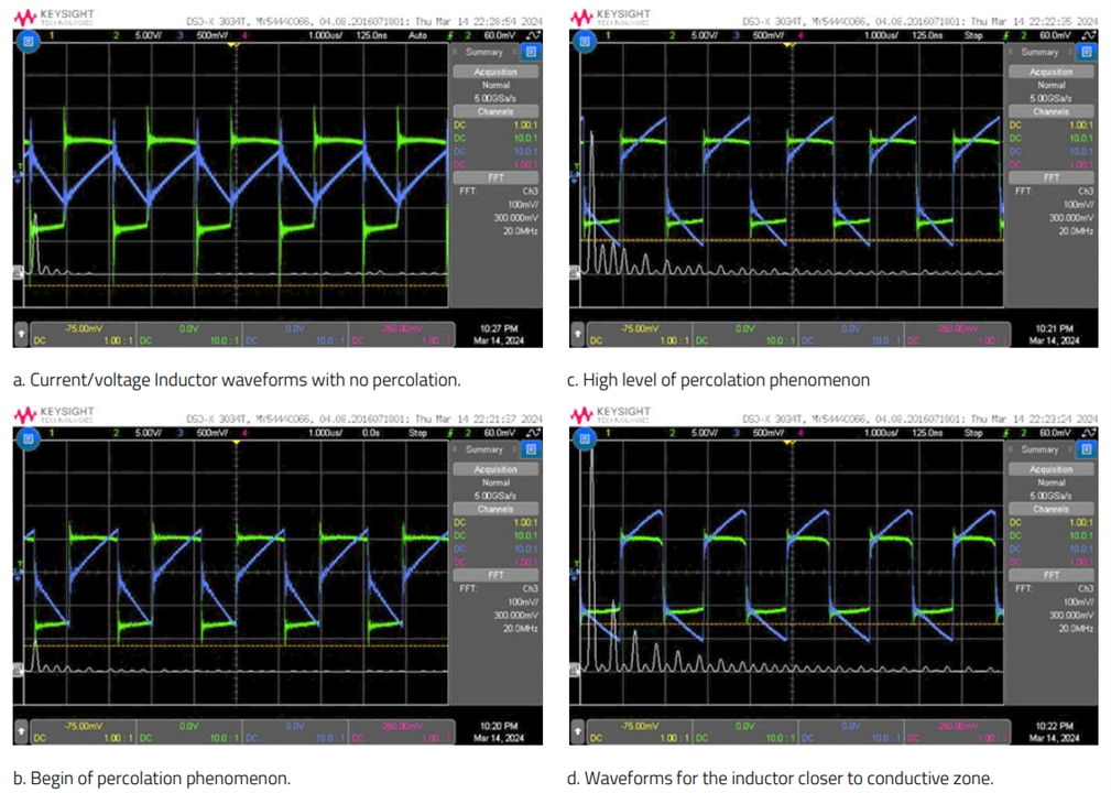

The oscilloscope screen captures of the ripple current for the different molded power inductors are presented in Figure 11. The voltage through the inductor is represented in blue, the ripple current in green and with gray the FFT of the waveform thought the inductor. What can be seen is that the shape of the ripple current has changed compared to the good part. The evolution of the change leads to very interesting findings. The first corresponds to the increase of the core material losses caused by the percolation phenomenon, equivalent to a resistor in parallel to the inductor, for the initial steps of the percolation, as already explained in our ANP126, and showed in Figure 12. However, when the percolation threshold is reached and is close to the conductive zone, as presented in Figure 11-d, the gradient of the ripple starts decreasing as well, and the parallel resistor model is no longer appropriate.
A second finding corresponds to the increase of the harmonics. The harmonics cannot be attributed to external noise sources, thanks to the filter used between the power source and the buck converter, or to the typical switching jitter evident in the Figure 11a. In fact, those effects start decreasing when the percolation phenomenon increases. The increase in harmonics is linked here to a considerable rise in DC offset. In terms of Fourier series, this corresponds to a step function, which is represented by an infinite number of harmonics. In this context, it is important to emphasize the overall distortion of the triangular waveform of the power inductor. This distortion impacts the ratio between the peak current and the output current of the converter. Consequently, the cycle-by-cycle current limit of the control IC is triggered at a lower output current than intended by the designer. Under certain conditions, this can coincide with the nominal current required by the application.
Figure 11: Evidence impacts on the ripple current due to percolation.
Figure 12: Illustration of the schematic resistor in parallel to the inductor[1]
This situation results in a drop in the output voltage. Ideally, the power IC detects this issue and shuts down. However, in the worst-case scenario, the application continues to operate with insufficient voltage, potentially leading to unintended conditions.

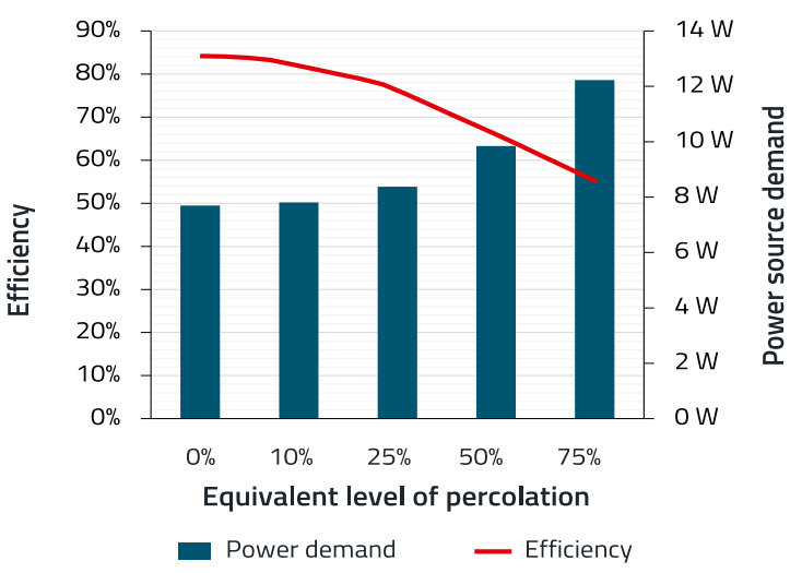

To validate the level of influence in the example application, the increased input power demand has been measured and compared in terms of percentage of efficiency relative to levels of percolation. The results as illustrated in the following Figure 13.
Figure 13: Efficiency decreases due to percolation of the molded power inductor.
It is observable how the efficiency of the buck converter decreases to low levels when the molded power inductor performs close to the conductive zone. It was not possible to measure values for higher level of percolation as the selfheating is faster, and the buck converter fails in few seconds.
In Figure 13, an efficiency of 85% is registered when there is a no percolation in the power inductor, with an input power demand of 7.6 W for a fixed load of 6.5 W. Initially, when percolation begins, the efficiency drop is less than 10%. However, once percolation reaches approximately 40%, the input power increases to 10 W. Over time, the input power rises to 12.5 W in a strong percolation scenario of 75%, resulting in a 60% drop in efficiency from the original setup.
The initial drop in efficiency is primarily due to core losses. However, beyond the inductor core losses, the varying current wave shapes and increased AC ripple contribute to additional losses in the winding and semiconductors.
Furthermore, with a strong percolation level the correct operation of the feedback control loop in current mode systems may also be compromised. The DC-DC converter may become less stable, leading to oscillations or erratic behavior in the output voltage or current. Components such as capacitors, and semiconductors may experience higher stress, potentially reducing their lifespan, if the harmonics apparition are considered as well.
