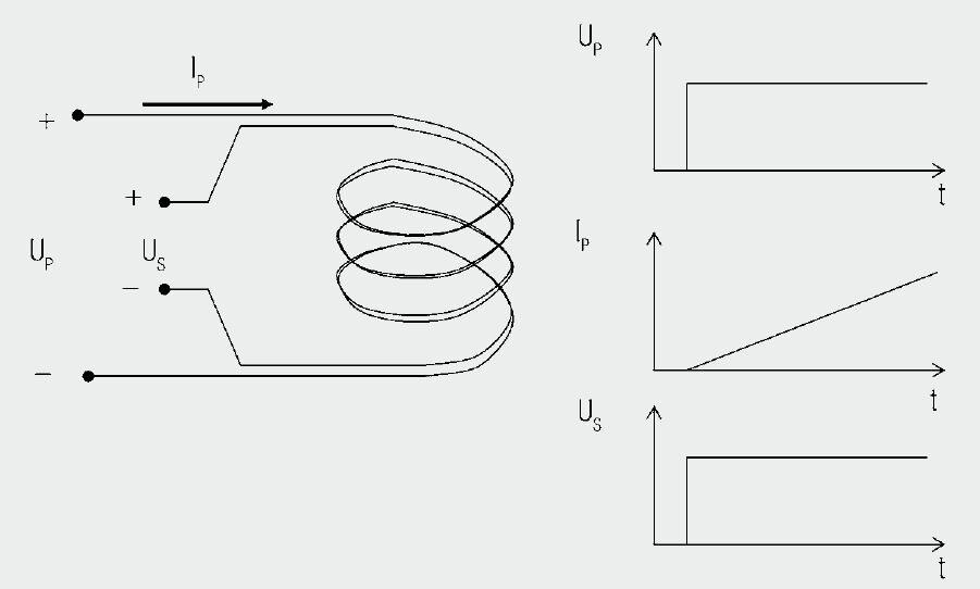

A transformer consists of at least two windings, with the winding turns Np on the primary side and Ns on the secondary side. For the sake of simplicity, we will look at an ideal transformer with a turn ratio of 1:1.
In a first step, we will look at a transformer with an open secondary winding Ns (Figure 1.32). A Up voltage pulse is created at winding Np. Due to the inductance of the winding, this pulse generates a linearly progressive current Ip. The following applies:
Fig. 1.32: Principle of a transformer with zero load. This ideal transformer is wound as a bifilar so as to ignore parasitic effects.

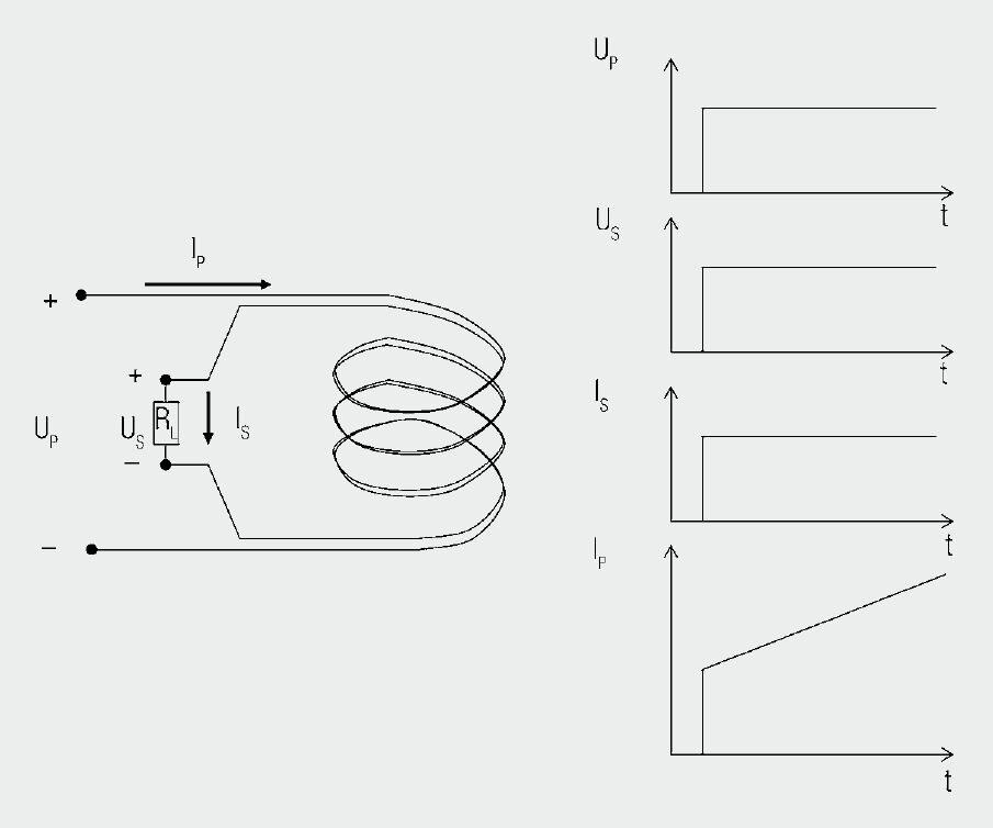

If we now connect winding Ns to a load resistor RL (Figure 1.33), the voltage induced in Ns generates a current flow through the load resistor:
Fig. 1.33: The same transformer but with a load.
The primary current now consists of the transformed secondary current and the linearly progressive magnetization current that is already available without load.

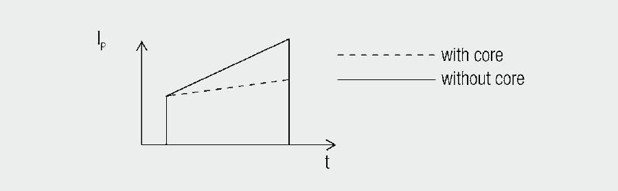

So the magnetizing current is not transferred to the secondary side. It is required to generate the magnetic field. The aim of the transformer design must therefore be to keep the magnetizing current as small as possible.
There are two possibilities here:
---> Insertion of a highly permeable core to increase the primary inductance. This causes the magnetizing current to rise less steeply and is therefore smaller (Figure 1.34).
Fig. 1.34: Magnetizing current of a transformer with and without a highly permeable core.

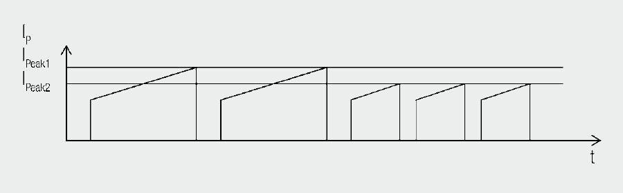

---> Shorter voltage pulses with higher frequency are generated, as the rise in current stops at the end of the voltage pulse and starts again at the original point for the next pulse. (Figure 1.35).
Fig. 1.35: Magnetizing current for a transformer at different driving frequencies.

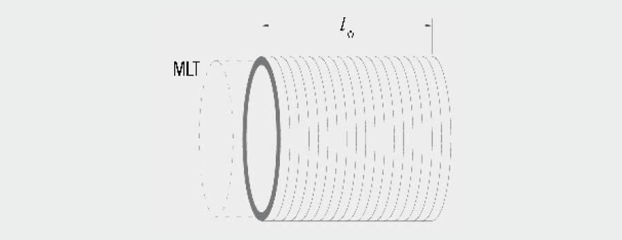

If you look at a long concentric coil (Figure 1.36), its inductance results from:
lw       Length of the coil
N       Winding turns
A       Cross section of the coil
Fig. 1.36: Long solenoid

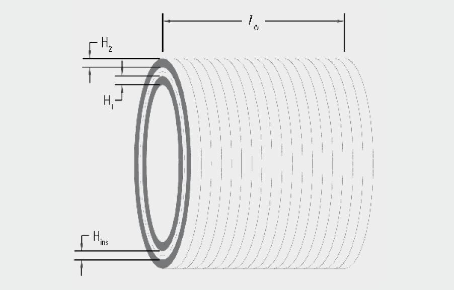

If a second winding is wound on top of it (Figure 1.37), the leakage inductance results from
Fig. 1. 37: Long solenoid with second winding
Where A here is the surface between the two windings. It can be calculated using:
MLT          Mean length of turn
Hins           Distance between the windings (isolation)
H1, H2       Winding heights of windings 1 and 2
The leakage inductance is thus independent of core material and air gap.

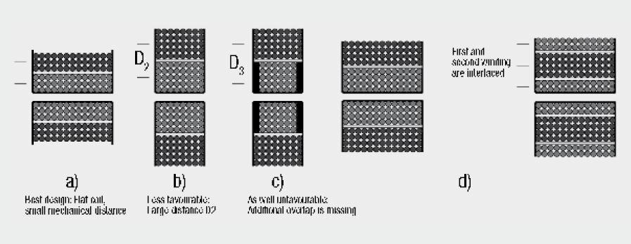

To minimize leakage inductance you must either increase the length of the coil (broad windings) or reduce the distance between the windings (e.g. bifilar wind).
Figure 1.38 shows various more or less ideal winding constructions. With existing geometry the most commonly used means is a sandwich construction (Figure 1.38d), in which the secondary winding is wound between the primary winding that is divided into two halves. This doubles the length of the winding.
Fig. 1.38: Different winding structures
