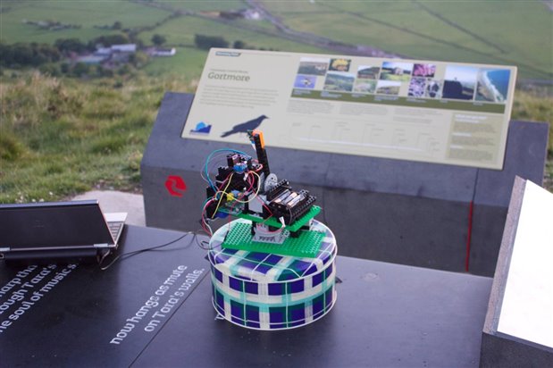

The robot is built using lego and lego RCX motors hooked up to a £3 motor controller and 6AA batteries for power.
It is normally wireless but for this panorama, I forgot the wifi adapter so had to use UART
The robot rotates round taking 3 layers of photographs resulting in 33 photographs taken. When I return home I then feed the photos into Hugin and stitch them together producing a panorama.
