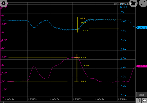

  2. Also, I think it is important to point that I did not use the sense input of the HMP2030: This measures the voltage at the DUT and allows the power supply to counter any voltage drops or rises. Lets zoom into this picture:
Again, I am surprised about the high level of voltage drop. I really didn't expect this. But as mentioned before, I didn't use the sense input. That's why I repeated the same measurement - but this time by using the sense input:
The above graph of the HMP2030 with the sense input used is probably the most "dramatically" looking graph. At the same time it is a great way to explain a sense input function of a power supply because the difference is easily visible when comparing the two curves (one with and one without using the sense input). It even becomes more clear when zooming in:
The actual voltage change is probably the highest of all power supplies in the last graph. But you might already guessed it: Again, there is no audible difference when comparing the sound. In fact I couldn't hear any audible difference with regardless of the power supply used at all. One thing to note is that the load changes are in no way aligned with the sound played - so a more powerful part in the song does not result in higher current being drawn.

Thanks everyone for the great comments so far - a very valid comment discussed my setup and the cable resistance that might explain the voltage drop. I have to admit that I completely ignored cables losses in my measurements and with hindsight that was a mistake. It bugged me that much that I went into the office this Sunday morning and borrowed a HIOKI RM3545 resistance meter. I have no possibility to measure the cable resistance with the iFi, because the iFi cable is fixed to the PSU. That said, the iFi has by far the longest cable (the cable length from PSU to USB micro connector is 210cm including a short adapter cable from 2.5mm to USB micro) yet the smallest voltage drop occurs with the iFi.
I could measure the cable resistance for all other power supplies, though:
Power SupplyCable Resistance [mOhm]
The cheapest wall adapter in the house225
My homemade TPS74A7 based power supply238
The Rohde & Schwarz HMP2030207
To me, these values explain a part of the voltage drop, but certainly not all of it. For the HMP2030 (with the lowest measured cable resistance yet the highest voltage drop) the cable loss in my setup is around 25% of the measured voltage drop.

    Jan Cumps over 4 years ago in reply to shabaz
    The current probe shows 5 V for 500 mA
    The wiggle is between 2 V and 3.5 V, so a current increase of 150 mA
    At that same point, the voltage drops from 4.95  to 4.83 V, that is a decrease of 0.12 V
    I bet that the power line + joints + probes resistance, between supply and the point where the voltage is measured, is 0.8 Ohm (Ohm's Law).
    claim: If you'd measure the voltage at the supply output, you'd see nothing.

    cookmesomekai over 4 years ago in reply to Jan Cumps
    Jan Cumps, you made me drive to the office this Sunday morning as I was so annoyed with myself that I didn't think of the cable losses (it's only a two miles drive though). I did cable measurements where I could and added them to the article. Thanks again for pointing this out!
