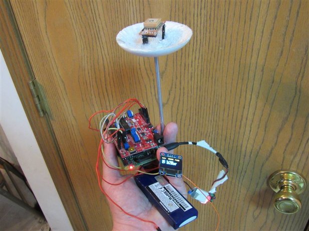

I am powering my RPI 2 with an external battery.  Its a 7.2V "LIFE" pack, which is a 2 cell battery.  The 7.2V is the max voltage, and the nominal voltage is 6.6V.  The current draw from a RPI 2 puts the voltage somewhere between the two.
I use a 5V linear regulator between the pi and the battery, along with a cut off micro USB cable attachment I made.  The connection between the battery and the regulator is the same as the connection between the regulator and the USB cable I modified. What this means is I can, and I did, plug the battery directly into the PI, inadvertently!  This will be an issue I fix so I don't do it again.
I had the pi 2 going for about 2 hours, pretty hard.   Here is what it had attached:
Chipkit Pi
Wi Pi
Wireless keyboard Dongle
OLED screen powered by the chipkit pi and connected vi I2C
A microstack GPS powered by the chipkit pi and connected via serial to the raspberry pi.
On top of that I was compling code and had the thread running that parses out the GPS data.
I DO NOT advocate trying to over power the Pi on purpose, I just wanted to share what may occur if you accidently do it like I did.  It appears the built in protection gives some leeway for errors and the Pi will just not go "poof" with a minor error like this.  Please only power the Pi with 5V from  a clean source such as a regulator.

I was logged in via SSH, so I am not sure if the little square was showing up that indicates power issues.   As you can see, in the end everything is really being powered through the PI.  When I get to production I hope to connect everything directly to the external regulator except the chipkit pi.
So....I smelled something HOT, not burning, just like hot electronics.  My RPI B+ smells similar when I have it mounted in the Pi Tin case but this was stronger.  I then realized my mistake.
So I just wanted to share, plugging in a 7.2V battery will not kill the Pi if you catch it soon enough.  I venture to guess it would of kept running for days if I didn't have all the extra stuff attached to it.    I've had going for a couple days now plugged into the right power adapter, and it does not seem to be damaged.
Its nice to know this but not happy I took such a risk to find out!  here is a pic of what I looked like on the table.  I have the regulator installed here but you get the point.
PS the white tape is not being used to insulate anything, I had used to hold the wires in place is all when I had it on the table.

    It's impressive that RasPi 2 survived 7.2V.  RasPi hasn't published the schematics for RasPi2 so we don't know what sort of protection circuits they have.  The have published the power schematics for the Model B+ and RasPi 2 is probably similar:  https://www.raspberrypi.org/documentation/hardware/raspberrypi/schematics/README.md
    The Model B+ has a 5V zener diode so if your power input voltage is higher than 5V the zener switches on and drops the voltage.  If your batteries can deliver a lot of current that zener will get hot.  There's also a PFET that the input current goes through, so it gets hot too.  If things get hot enough, a self-resetting fuse goes into the high resistance state.

    The parts that were hot:
    CPU
    The HDMI port
    The sound jack.
    CPU for good reason, the others probably since they have metal the heat was sunk to?

    Yes, the metal shields act as heat sinks in a well-designed board with good ground and power planes.  The USB/LAN chip used to get quite hot on some of the original boards, but that was because of a design error.  The rev 2.0 PCB fixed the error and added extra vias to conduct heat away from the USB/LAN chip.

    The 5V on the 'pi is used more or less as "unregulated power source". The CPU for instance actually runs on 1.2V. So there is a step down converter... in the CPU image that makes that 1.2V from the 5V power input. This works without trouble to below 3.0V. On the other side the specs say "max 5.5V". This is a "common spec" that the chip makers consider a "workable limit". Even if they test their chips and find they work fine up to 7V they still specifiy 5.5V which allows them to make changes that won't impact anyone who "follows the rules".
    That said, besides the CPU there are a couple of DCDC converters that make other voltages like 3.3V and 1.5V. The situation is exactly the same: an upper limit probably somewhere in the 6-10V range, but a specification of 5.5V.
    And lastly, the 5V is passed on to some interfaces that specify 5V. USB and HDMI. External hardware there might not like the high voltage you applied. This external hardware probably includes most of your external hardware as well. (i.e. powered by 5V).
    I've made exactly the same mistake: Connect a 2 cell LIPO to the 5V line of a project. In that case, the FT232 survived without a hitch. And that's a fussy chip: connect its reset line to the 5V and it gets really really hot...
    Oh! One more thing.... If John is right about the 5V zener then... First of all it must be at least 5.5V to allow for a normal 5.5V powersupply. Second, it will not divert power, but "consume as much current as necessary to force the powersupply to less than ...." (whatever the nominal voltage of the zener is). If your pack is capable of delivering 20A at 6V, that's exactly what will happen. (I didn't know they had 3.3V/cell nominal LIFE packs in that format).
