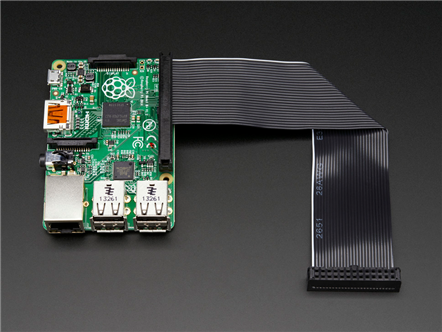

I purchased a Raspberry Pi 2 Model B 1 GB.  The accessory kit I purchased is from Adafruit industries.  Thus far, I used the SDcard that came with the accessory kit after downloading NOOBS 1.4.0 and installed the OS on the Raspberry Pi.  I was also able to get the "Ourlink" wifi adaptor to work.  I can connected to the internet.  I was watching the Getting Starter video #4 from element14.com entitled "Your First Pi Project".  It talks about the 26-pin cable to connect to the Raspberry Pi.  The Adafruit accessory kit does contain a 26-pin cable.  But my Raspberry Pi 2 Model B has more pins on it (I think 40).  So two questions:
(1) Can I use the 26-pin cable, or do I need to purchase another cable?
(2) Where is pin-1 on the Raspberry Pi?  Can you explain from the perspective that I have the Raspberry Pi in my hand with the USB and EtherNet ports on the left, and pins to the right, directly below the HDMI and EtherNet ports.

    Here is an image of Pi 2/B as seen with red light on left side:
    Raspberry Pi Model B+ GPIO Header Pin-out
    A better more readable version:
    Here is a PDF file too: http://www.raspberrypi-spy.co.uk/wp-content/uploads/2014/07/Raspberry-Pi-GPIO-Layout-Worksheet.pdf
    The 26 pin cable will NOT fit 40 pins without breaking pins 27 and 28. I recommend getting a cable like this:
    Downgrade GPIO Ribbon Cable for Pi A+/B+/Pi 2 - 40p to 26p ID: 1986 - $2.95 : Adafruit Industries, Unique & fun DIY elec…
    Enjoy your new Pi 2,
    Clem

    Great information on the pinouts and cable!  I will definitely order the cable you suggested.  Thank you so much!
