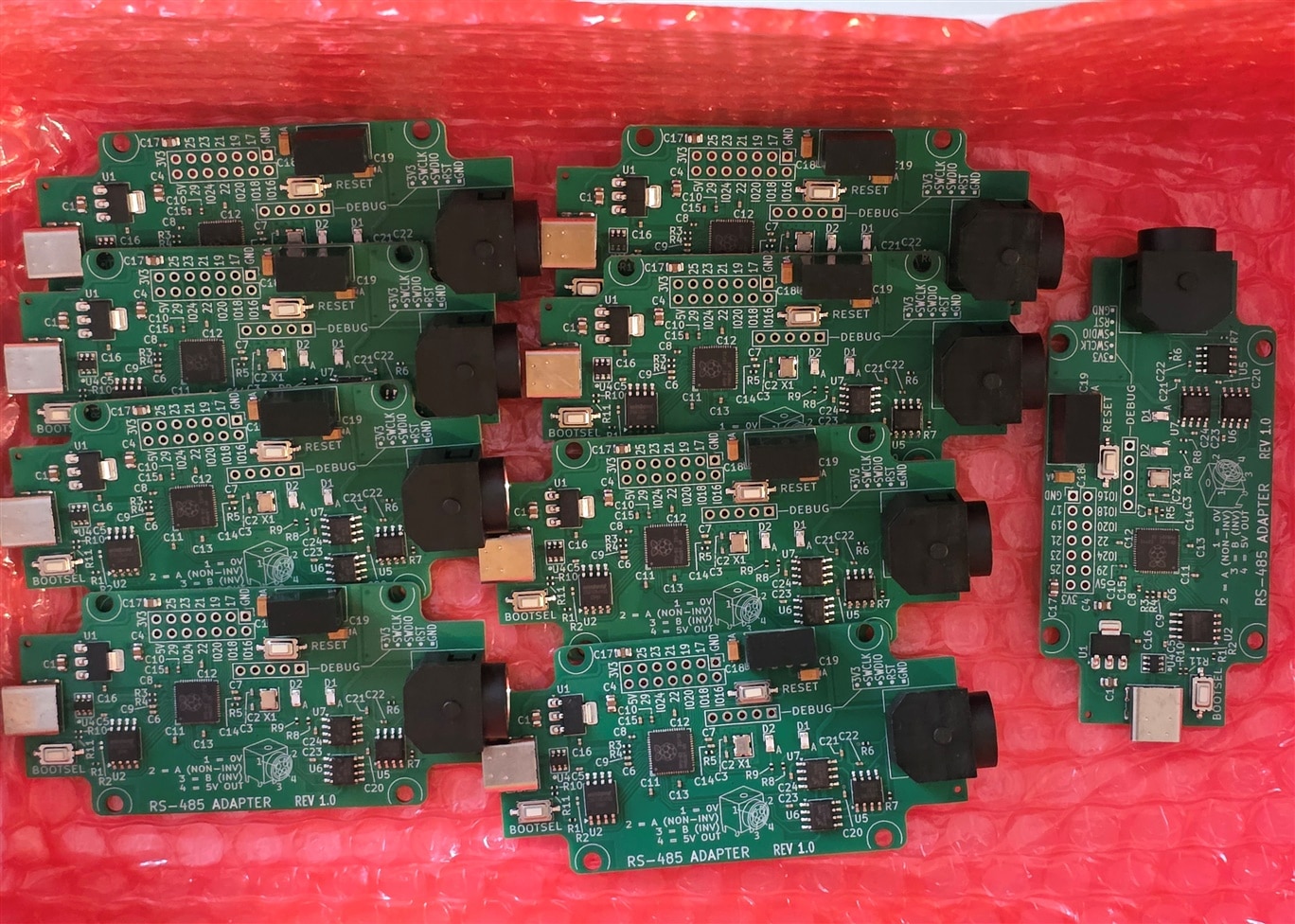

All the assembled boards were secured with tape on the underside. The amount of bubble-wrap was more than adequate, all the boards look great.

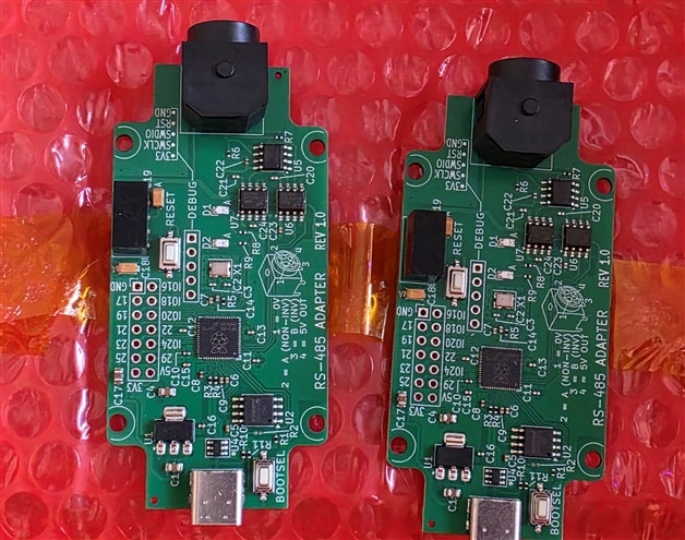

The first thing I did was to examine a sample board, to ensure components were oriented the correct way.
I'm glad we had an 0402 parts discussion, and the results of that can be seen in the photo below. I have not got out the protractor and set-square, but I think those parts are textbook-grade aligned!

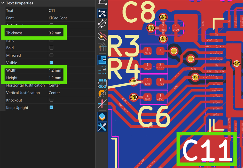

The PCB is not densely populated, so there was space for very large component reference silkscreen text. With the settings shown below, the text is extremely readable in my opinion.

A through-hole USB-C connector was used (this cost a bit more for assembly as a result) but it was needed due to the particular enclosure I hope to use. The soldering looks good.
I don’t know how the through-hole soldering was done. The manufacturer portal indicated that the board went through a wave soldering process, but that would have solder-plugged the deliberately unpopulated through-hole pads that are on the board. Those through-hole pads are just lightly tinned, ready for inserting header pins if/when needed. Maybe the manufacturer masked the unpopulated through-hole pads.

The LEDs that were chosen are overly bright with the particular resistor values, but that's a minor issue. I should have also created a silkscreen location for serial numbers, but I forgot.

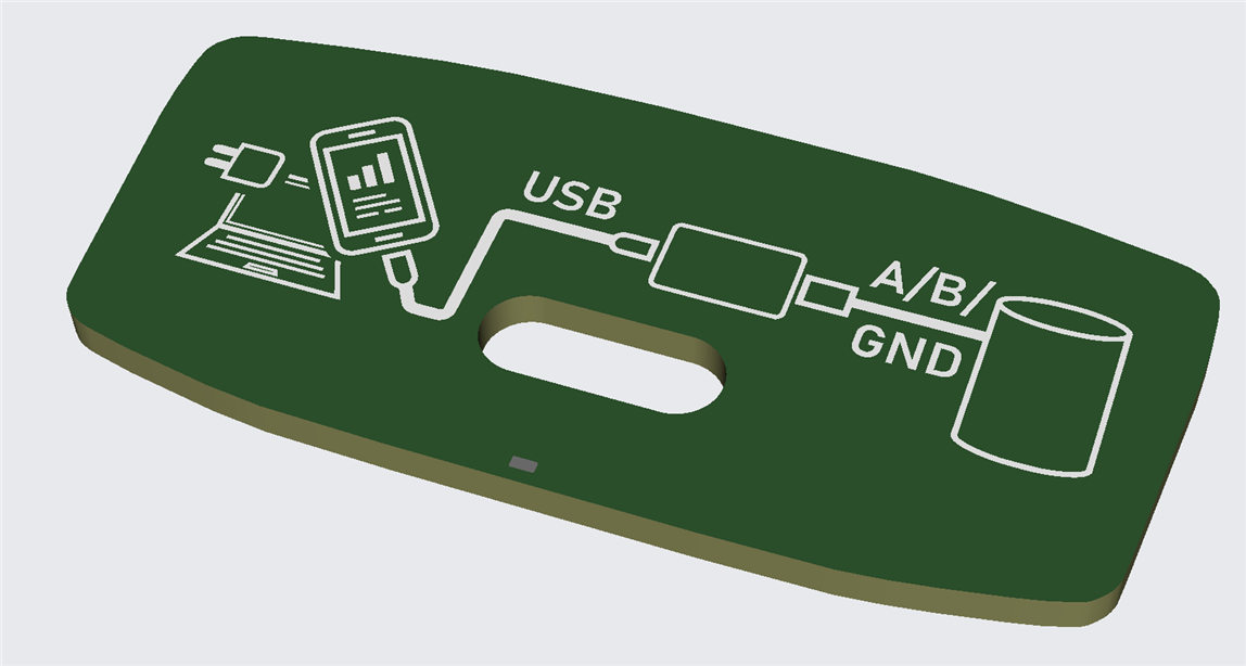

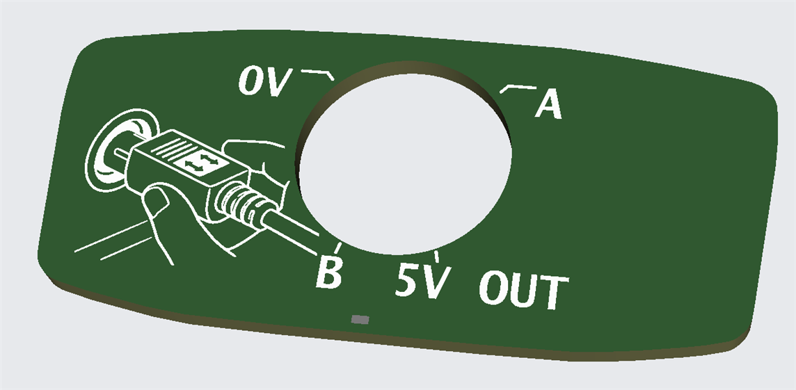

    Silkscreen is free on PCBs, so I used the KiCad Image Converter app a bit more.. the diagram shows how to orient the connector (AI generated image).

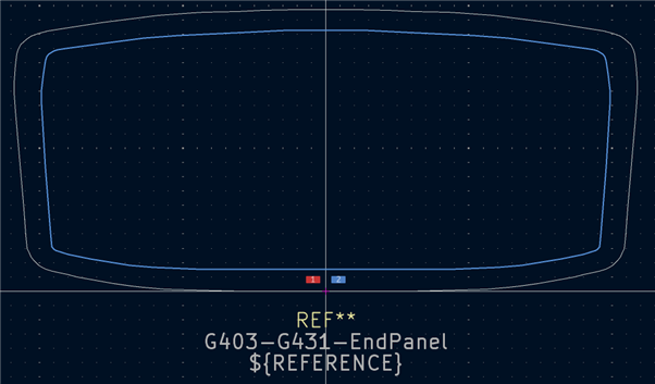

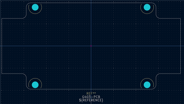

    I've placed the KiCad PCB and End panel outlines in an enclosures repo, for future projects.
