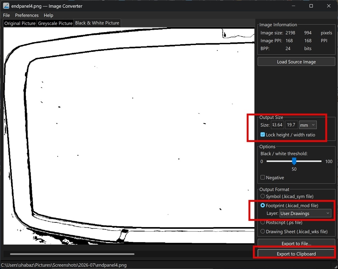

    shabaz 4 days ago
    Time to work on the enclosure; I really like the Multicomp G403 enclosures, and the PCB had been designed to fit that. The only minor annoyance with that enclosure is that the end panels are not a simple shape.
    With KiCad, it's not too difficult to create end panels. With calipers and a mobile phone, the procedure I tried was:
    (1) Take a photo of the end panel against a contrasting background. I used my mobile phone camera, but it's best to keep it some distance from the target, and zoom in (rather than bring the camera up close and zoom out), to reduce distortion which would not be good!
    (2) Use MS Paint, or PowerPoint, or any other image manipulation software, to first straighten the image if it's necessary, then crop it to the smallest rectangle that will fit the edges of the shape, and then "poster-ize" or do whatever you can, to make the edges very clear.
    (3) Use the calipers and measure the end panel piece, to the outermost edges, horizontally and vertically, and make a note of those two values.
    (4) Use KiCad's Image Converter app. Set the image size to precisely what was measured in step 3! Then pick a temporary layer of your choice, and Export to Clipboard.
    (5) Go into the Footprint Editor and create a new footprint. Now just set the grid to something fine (like 0.1 mm) and use the line tool, and trace out half the shape. Then, group it, copy it, and then flip it horizontally, and then drag it so that it connects precisely. Ungroup, and then change the lines (using the Properties panel) to become 0.05mm Edge.Cuts lines instead. You can now check with the 3D viewer, that all the lines did indeed connect, such that the Edge.Cuts layer becomes a complete board outline. You can now delete the content off the temporary image layer that was used.
