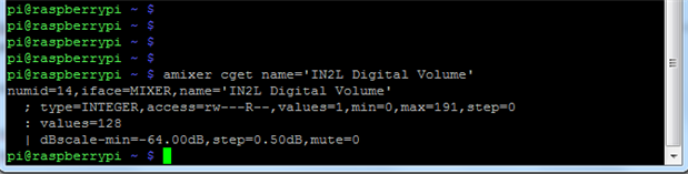

Displaying current values and control parameters
Current values for a device can be be obtained by using the command amixer cget name='xxxxxxx', where xxxxxx is the name of the control.
For example, to get the current input gain settings use amixer cget name='IN2L Digital Volume' which returns the following :
From this we can see the current value (i.e. 128) and also the settings for this control - i.e.
  • Minimum value -64.0 dB
  • Increment value 0.50 dB
  • Max value 191 (which works out at around 31.5dB - i.e. -64 + (191/2)
So with a current value of 128, the input gain is set to (-64 + 128/2) - i.e. 0dB.
