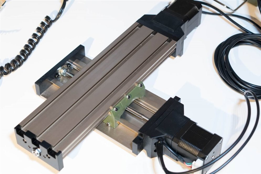

    Hi Hendrik, In the search for an Xmas project : ) I've purchased the version with inbuilt stepper motors version with inbuilt stepper motors , to experiment with building a motor control board. I've only…

    I didn't know that the KT70 already can be purchased in a CNC-ready version. Too bad it wasn't available when I got mine image
    For drilling thats the perfect solution, but I would not use one of IBS or FBS devices for milling. The horizontal forces might work too heavy on the bearings, so they could get too loose and have some play. For the high rotational speed to be used with small drills this is problematic. At least then you should have separated units for milling and drilling.

    I agree, I don't think these tools are ideal for milling. The motor controller project is not related to the rotary tools, really just a testbed to see if I can get anywhere with some motor control, and if so I may use it as some engraver if I'm lucky. There are more heavyweight products like the Proxxon KT 150 table and BFW 40/E motor for such uses, but then the cost is beyond experimentation area for me, so I'd rather play with just the table for now, to test out the electronics and software.
