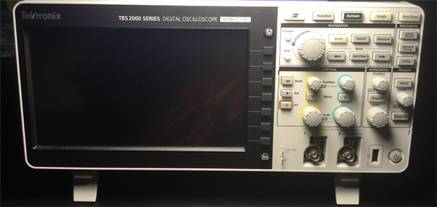

    Jan Cumps over 6 years ago in reply to Jan Cumps
    For entertainment, my beloved Tek scope:
    TBS2102, 2 channel, 100 MHz. <3
