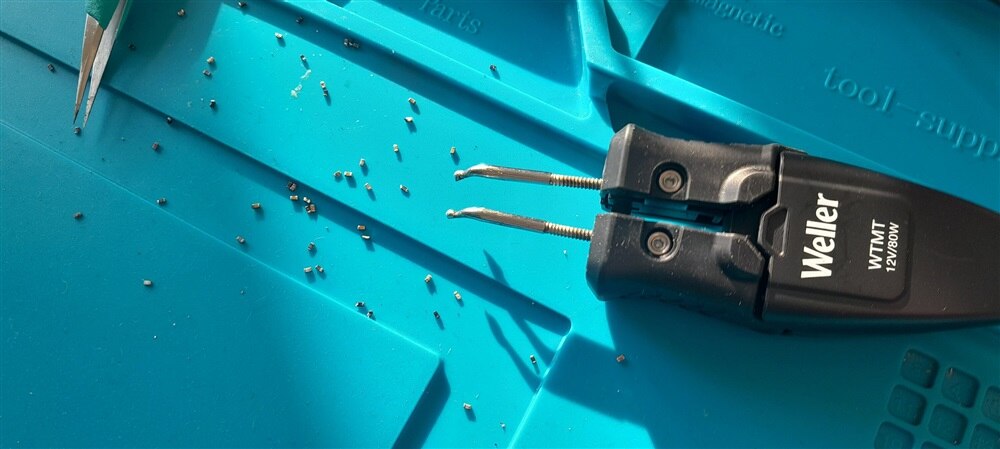

Testing the desoldering tweezers. I removed a set of SMD components from a multi-layer board:

    More frantic test with the tweezers. A series of 0402 resistors and capacitors removed from a multi layer board.
    90% went very easy - in a second. Some had a pad on the ground layer, and that took a few seconds. For those, it would have been better if I put the board on the pre-heater.
