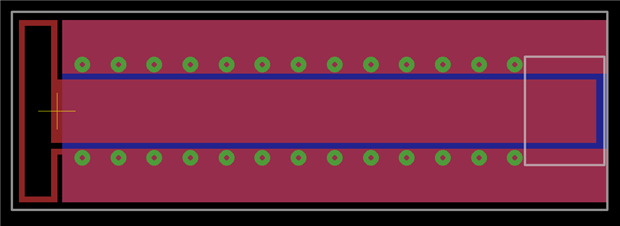

  • Hi Mark,
    If you like, we could try making one : ) I considered in the past about making a H-field probe, I've no idea how well it would perform, but I based it around some ballpark measurements from existing probe designs, and hoped to iterate manually millimetre by millimetre, by just seeing how it performed and then making some changes. It should be cheap to have half a dozen slight variants for $10 since they all fit on a 100x100mm board made in China perhaps.
    However, I've never finished it, I only drew it out in EAGLE. Not simulated it either, I wouldn't know how : ) it would require expensive software tools, so I favored just attempting it iteratively..
    If you're interested too, then that's a good reason for me to actually get the boards made : ) I'd be happy to send you across some boards for experimentation, I'd have loads spare since they only manufacture in quantities of 10 boards, and I only need one board.
    As for E-field, I'd not considered it for EMC purposes, but had just wanted a FET probe for connecting to sources that are not 50 ohms. But not got anywhere with that yet.

  • Having trouble attaching the image to the previous post..

    I also like the ideas you and are proposing to have , you, and I test a couple of home brew designs.  If I get the Bee Hive probes, then we will have at least one commercial offering to compare against.
