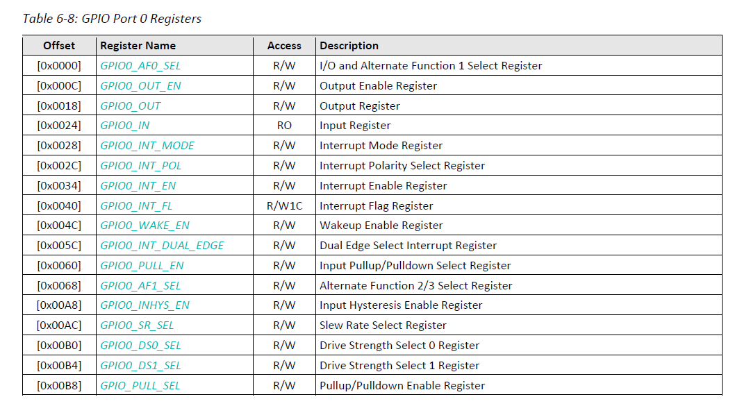

  • I think you need to set it for input with no pull (up or down).
    They don't quite say that but the clue for me is on page 58 of the user guide:
    • Input Mode Features
    − Standard CMOS or Schmitt Hysteresis
    − Input data from the input data register (GPIO0_IN) or to a peripheral (alternate function)
    − Input state selectable for floating (tri-state) or weak pull-up/pull-down
    That last line suggests that they see input floating as the same thing as tri-state.
    MK
  • Does anyone know how to put a GPIO pin in 3-state mode? Is that by setting it to Input?
    I've been searching the User Guide and the register settings. It mentions tri-state but I didn't find which register combination sets that.

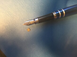

  • I'm writing the road test review. Here's a preview of the size of the MAX32660.
    Spoiler Alert. This is one tiny baby.
    Also a thank you to Maxim to send them to me as samples (in just a few days!). That helps me to complete the road test.
