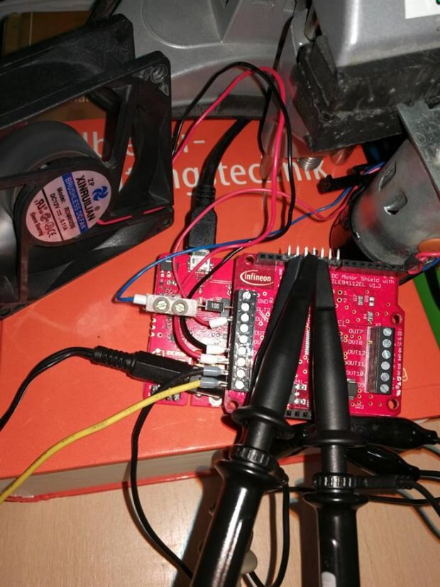

  • Hello Thomas,
    is the Arduino also powered from the PS, or just USB?
    It may happen your wrong functioning above 5V.
    Powering just via USB may not enough.
    I connected the Arduino controller (XMC1100) also the driver board to the power supply.
    I use the USB port just for communications and programming.
    Best Regards
    Gerald
  • Yes, i think so too.
    But, hm... can it also happen that the Arduino was not powered correctly?
    Powering the Arduino just via USB seems not enough.
    Best Regards,
    Gerald
  • Yes, you are right. Now I remember. Thanks for the reminder.

    I just received a package from Infineon. It's the DC Motor Shield itself, not the XMC 1100 board.
    I know why had some failures of the 1100 boards; I believe my assistant sent them to the specific RoadTesters.
    I wasn't aware that there was a failure of the motor shield itself. Whoever had a shield failure, please add a comment to that effect, or massage me at
    Thanks.

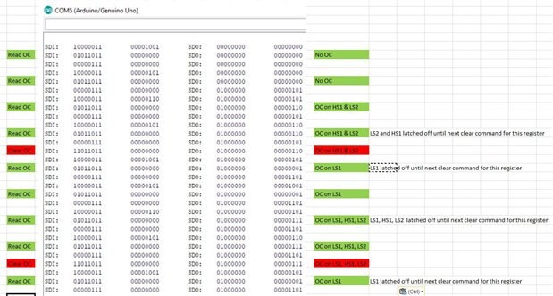

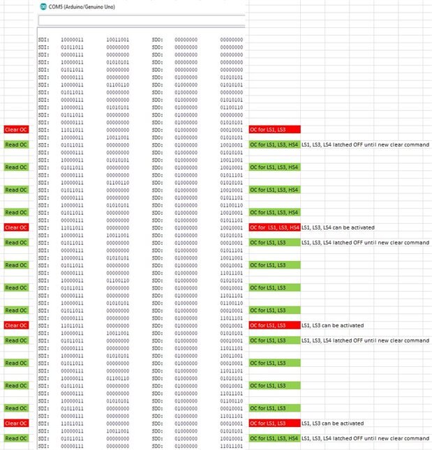

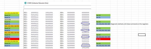

  • Hi Thomas,
    you have done a very very nice and structured video. Thanks for making it.
    I have commented the serial monitor screenshots.
    5.1V
    6V
    9V
    At 5.1V: only open load are reported on
    LS1 to LS4, which is normal after a “brake low command”
    At 6 and 9V we can see that the
    activated outputs are latched off due to an overcurrent detection.
    This shows that the inrush current of
    the motor exceeds the device overcurrent detection.
    Note that the overcurrent filter time is
    short in order to protect the output stages (~ about 16 µs).
    Try to use for one motor two or more outputs in parallel, I pretty sure the motors will turn at the higher voltages.
    Best Regards
    Johannes

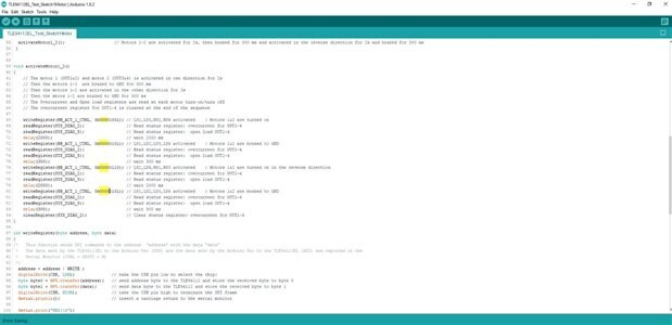

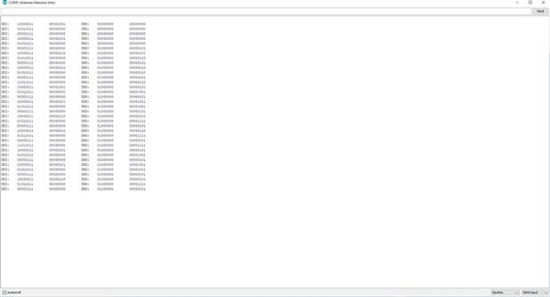

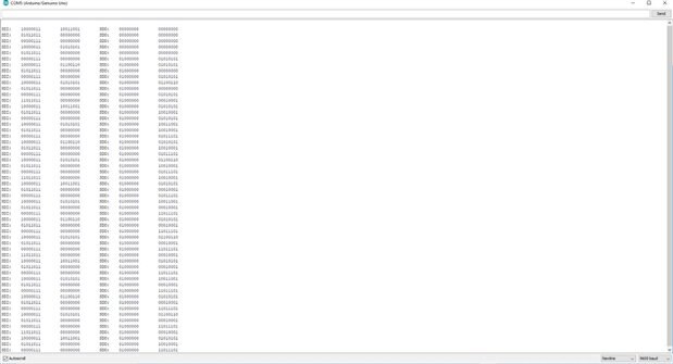

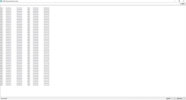

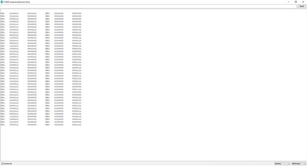

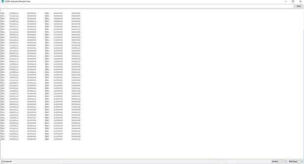

  • I modified Johannes' 2 motor sketch to run just one motor.  This is a screen capture of the sketch, demonstrating the "Zeroing" out of the bits for the second motor:
    This is the Serial Monitor screen capture for the 9V motor (ducted fan) at 9V (reminder nothing happened during the test.):
    This is the Serial Monitor for the 9V motor run at 5.1 Volts (optimum for activity as demonstrated by the video):
    This is the 12V motor run by the Power Supply at 12V:
    This is the 12V motor run run by the power supply at 5.4V (optimum maximum for getting things to work):
    Finally, this is the Serial Monitor capture for using the 12V motor with the 12V 5Ah lead-acid battery:
    I hope this helps!!!  Please let me know what you think.

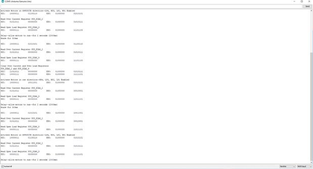

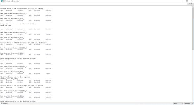

    Sorry it took me a while but here is the test results using Johannes' sketch as well as mine.  First, this is an approximately 7 minute long video of the various "test procedures."  Make sure you have the SOUND turned ON I dubbed over the video with some narration.  I think it is pretty self explanatory.  If you can't read the Serial Monitor printout captures don't worry, I will post them here following upload of the video.  Once again, I apologize for the delay but I was the "tester, Videographer, Sound man, and editor"....lol...so it took a while.  Thanks!
    The following screen captures of the Serial Monitor correspond and are the exact same ones that appear in the video.  This is the 2 6V motors using Johannes sketch, but running them at a voltage of 5.1V.  (5.1V was chosen  because it seems to be the optimum voltage to get anything to work).
    This is the same setup using my sketch which is basically the same, except it is loaded with Serial Monitor Print outs for debugging purposes:
    This is the same setup as above but using a 6V setting, Johannes' sketch:
    Repeat, but using My Test Sketch:
    Continued on next post......

    Thomas has tried eliminating the power supply by using a 12v 5AH gell cell.
    The only question I have is during the video you make the comment that you power up the USB (Arduino) before applying the power to the shield.
    The Arduino does setup the SPI during this time, so the better approach might be to press the reset button on the Arduino with the motor power ON.
    The arduino will start at zero and then run through the setup with the shield active. It may make no difference but it's worth a shot. image
  • Thanks, Johannes!  I'll look forward to the replacement shield!  I understand fully what you are saying, but these motors I am using are relatively low current motors.  It would appear that no one else has had this issue, so this is why I think the shield may be defective.  Actually, after receiving the replacement XMC1100 card, the first time I started it up, it worked great!  So, considering the "physical" damage it had when I received, I just can't help assume that the package that was shipped was treated harshly in some way and that may be why the shield is not operating properly as well.
    Nonetheless, I will run the sketch/tests today and publish the results here.  Did you see my sketch on Github?  I wrote one a few days ago (which is basically the same as yours) except I added a lot of Serial Print comments to annotate the program specifically for debugging.  I will run both and try to make a video and print the results.  I will also modify the sketch to run 1 motor so that I can use a couple of other different motors with different specifications.
