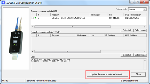

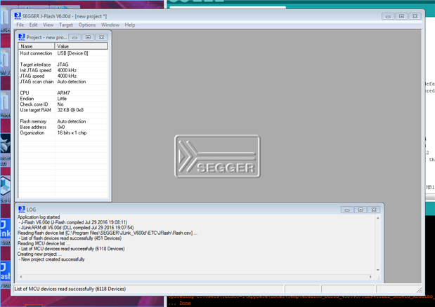

    As the sketch uploading to the board is flashed with the J-Link SEGGER I have lunched the JFlash-V6.00d icon and got the windows shown below
    As shown the device board is recognised correctly. SO I have tried from the menu the following opton: Target >> Test >> Hardware then one of the available choices (no matter what)
    • Activate BUSY
    • Deactivate BUSY
    • Activate OK
    • Deactivate OK
    The idea was to see if some kind of reactivity exists between the flasher and the board, possibly without impacting on the board features. This was not possible (I mean the bootloader and CPU setting) as this tool just manages the J-Link lite - the detachable part of the board used as the programmer.
    As I have launched one of the commands I saw a dialog message: the board j-Link firmware is not updated. Do you want to update now?
    I have confirmed and after a while with a log showing me the uploading process (less than a minute) I have closed the program, removed and attached the board again (the USB virtual serial port has changed) and tried to upload the sketch from the Arduino IDE again.
    It worked! Upload is very fast and what is shown after the upload on the IDE console now has more sense image image image image image image !!!!

    The J-Link configurator has a dedicated button for updating the firmware as well:
    I'd like to mention this as it might be helpful for manual update.
