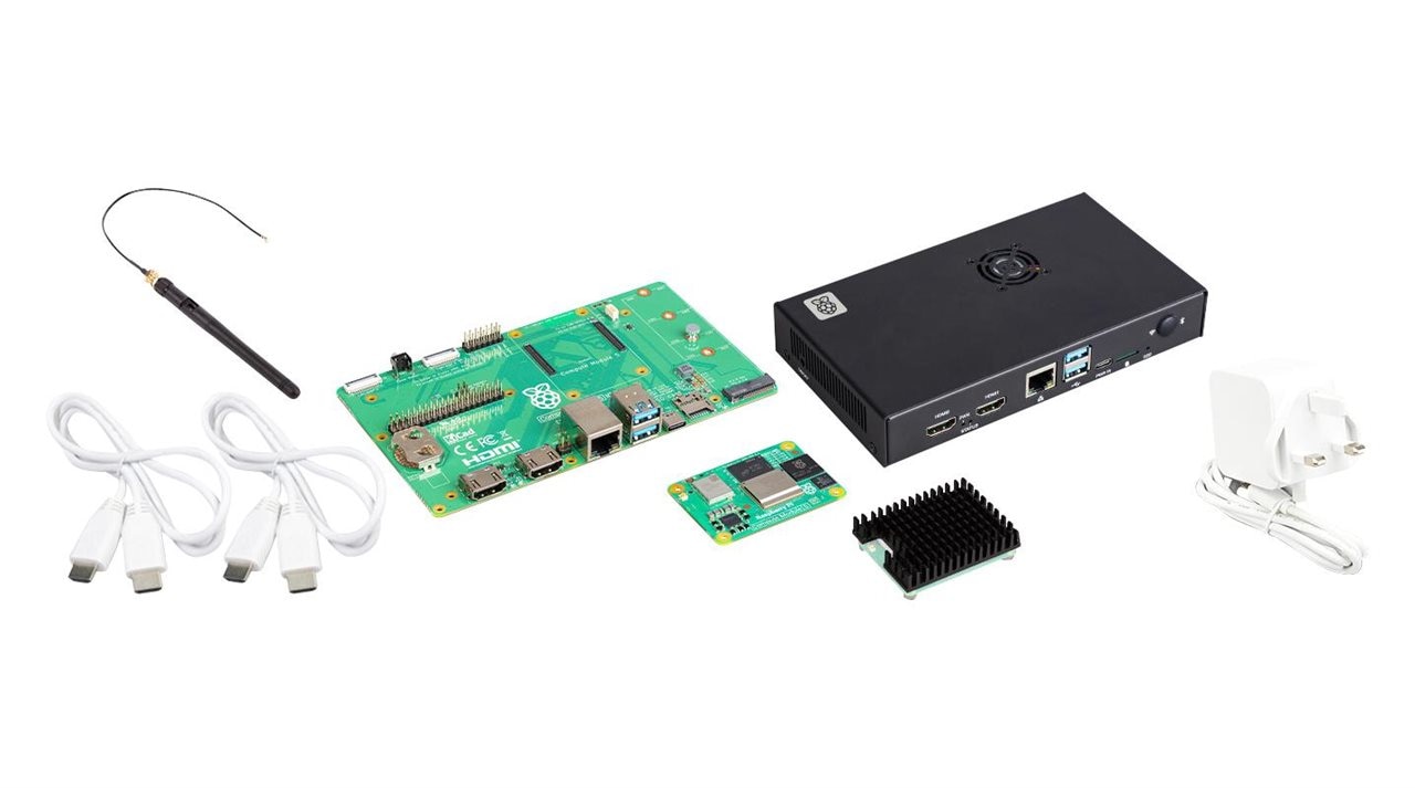

The Raspberry Pi Development Kit for Raspberry Pi Compute Module 5 offers an ideal environment for prototyping embedded solutions. This comprehensive kit includes a Compute Module 5 and Compute Module 5 IO Board, together with all the essential accessories to kick-start your product design.
What's the CM5 Development Kit?
- The Raspberry Pi Compute Module 5 Development Kit includes the CM5 (4GB RAM + 32GB Flash), CM5 IO Board, breaking out all the IO of the CM5, giving you easier access to the ports, peripherals and HAT+ Connector, making prototyping more straightforward for embedded and industrial applications.
- Protecting the IO Board is the included metal case with included cooling fan, keeping the components inside cool under heavier loads. The kit also includes the cooler heatsink for the CM5.
- Wireless connectivity is maintained using the included Antenna kit, for wireless connectivity while using the case, or for testing the electronic switch between PCB and external antennae.
- Design files are available for both the CM5 and the IO Board, allowing the creation of bespoke designs.

What's included?
RoadTesters will receive or have access to the following to complete their review.
- Raspberry Pi Compute Module 5 Wireless, 4GB RAM, 32GB eMMC
- Raspberry Pi Compute Module 5 IO Board
- Raspberry Pi IO Case for Raspberry Pi Compute Module 5
- Raspberry Pi Cooler for Raspberry Pi Compute Module 5
- Raspberry Pi Antenna Kit
- Raspberry Pi 27W USB Type-C PD Power Supply
- 2 × HDMI® to HDMI cables
- Official USB-A to USB-C Cable

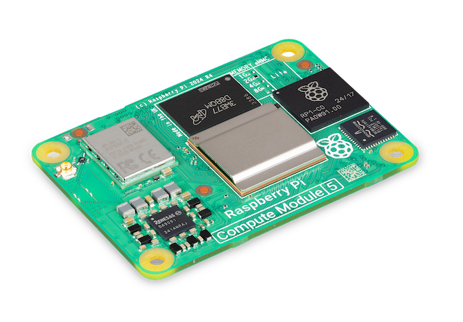

What is the Compute Module 5?
Designed for integration into embedded systems, the CM5 System on Module (SoM) takes the Raspberry Pi 5's 64-bit Broadcom BCM2712 quad-core ARM SoC and packs it into a module just 55 x 40 x 4.7 mm in size with up to 64 GB of storage. The development kit "offers an ideal environment for prototyping embedded solutions" including the CM5, Compute Module 5 IO Board and all the essential accessories for developing your product design.
- The Raspberry Pi Compute Module 5 is a system on module making the power of the Raspberry Pi 5 available in a more compact package for embedded applications. Integrated on the module is a 64-bit Arm Cortex-A76 quad-core CPU, an 800MHz VideoCore VII GPU, enabling dual 4Kp60 display output over HDMI.
- Designed to be mostly compatible with the Compute Module 4's size and connectivity, the CM5 makes alterations to the pinout of it's 2 100-pin high density connectors to repurpose signals to allow the addition of two USB 3.0 and other features. Other changes made include higher current testing for connectros on the CM5, Dual-purpose DSI and CSI signals for use with either a CSI Camera of DSI Display.
- Onboard memory is ECC and is available with 2 GB, 4 GB, 8 GB or 16 GB of memory and options for 16 GB, 32 GB, or 64 GB eMMC flash memory. The CM5Lite also provides an option for cost-sensitive uses without on-board storage. The model included within the development kit is the 4 GB RAM, 32 GB eMMC Flash.
- The CM5 is connected by Gigabit Ethernet with precision time protocol support, as well as the optional, fully-certified, WiFi and Bluetooth module, with the option to switch between PCB Trace and external antenna(The CM5 included in the development kit is WiFi and Bluetooth enabled).

| Parameter | Value |
| Form Factor | 55 mm × 40 mm × 4.7 mm module, 4 × M2.5 mounting holes |
| Processor | Broadcom BCM2712 quad-core 64-bit Arm Cortex-A76 (Armv8) SoC @ 2.4GHz |
| Memory |
2GB, 4GB 8GB, or 16GB LPDDR4-4267 SDRAM with ECC |
| Storage | 0GB (Lite), 16GB, 32GB or 64GB eMMC flash memory |
| Connectivity |
| Expansion / Peripherals |
Up to 30 × GPIO supporting either 1.8V or 3.3V signalling
| Video |
| Multimedia |
| Input Power | Single +5V PSU input supports USB PD for up to 5A @ 5V |
| Operating Temperature | -20°C to +85°C |

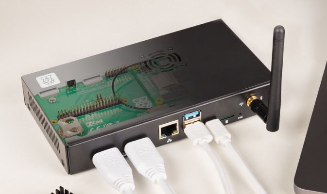

All laughs and gigles until one roadtester starts to use is as heater in winter
"both the heatskink for the CM5 and the fan for the case can't be used simultaneously?"
Isn't that an issue with the earlier models of the enclosure but not the recent ones?
I think that Rev.2 should allow to use a heatsink and fan simultaneously, according to this article:
www.hackster.io/.../raspberry-pi-revises-the-compute-module-5-io-board-io-case-designs-for-better-cooling…
