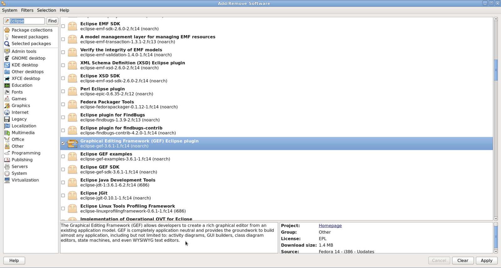

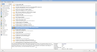

What were the biggest problems encountered?: The 430Boost-CC110L AIR Module BoosterPack Kit, did not come with the Demo Application Pre-Installed. I tired CCS in Linux, which only gave errors. And I don't have enough Memory to install CCS in my WinXP System. I installed IAR Embed Workbench in WinXP. Which is limited in Byte Code Size that is allowable to use. It's basically Demo Only Software. So, it was no use at all to me. I did some searching in App Manager and Google and found two nice IDE's that are Free and Open Source for Fedora Linux (Anjuta and Eclipse). They both are very nice Programs and I was able to import the 430Boost-CC110L AIR Module Code int both of them. But, still I was not able to Debug and Install it on my 430Boost-CC110L AIR Module. So, any help from someone with more experience with IDE Software, will greatly appreciated.

I was chosen by Element14.com to Receive, Try Out, Test and Review a free TI 430Boost-CC110L AIR Module BoosterPack kit. The kit comes with two 430Boost Boards and two CC110L AIR Modules. This is a Wireless Kit and could be used for quit a few different and interesting Projects. They call these Road Tests. This is my second TI MSP430 Kit that I have been allowed to review. The first was the TI Fram MSP-EXP430FR5739 Experimenter Board. I really enjoyed and learned allot about the MSP430, during my first test and review. If you like, you can read my first Article here, Beginners Guide to The TI MSP-EXP430FR5739 Experimenter Board. I thought that this review of the 430Boost, would go rather quickly and be allot easier than the first, because of all that I had learned with the MSP-EXP430FR5739. But, Boy was I Wrong!:O I found out just how little I know about installing Embedded Software on an IC Ship, with IDE Software. I have been wanting to learn how to do this. Ever since I tested the MSP-EXP430FR5739. I want to be able to install custom code and build my own projects, one day. I did a bunch of reading, before on IDE Software and realized that there would be a learning curve for me. But, what I didn't expect. Was Software that doesn't work as you wold expect. I have been running Fedora Linux as my main OS, since 2005. So, the newest Windows System that I have, is running WinXP. And since I learned the last time that almost all of the Software that TI makes available to use to work with their Boards is Windows Software. I started out on my old WinXP Machine. I installed IAR, one of the IDE Software's Provided. I could not install Code Composer Studio (CCS) on my System. Since it requires 1GB of Ram and I currently only have 512MB of Ram on that System (one Ram Module died recently). I also installed AIR Booster Stack Lite. Which reads the info from the 430Boost-CC110L AIR Module. I followed the instructions in the Quick Start Guide and the Manual too (after things didn't go as planned). To make a long story a bit shorter. The AIR Booster Stack Light Software just can't See my 430Boost-CC110L AIR Modules. The first problem that I noticed. Right after installing the 430Boost-CC110L AIR Module Drivers. Was an Error Saying something about the new driver not working right. This happens sometimes in Windows, even thought things are fine. So, I want ahead and Plugged in one the 430Boost-CC110L AIR Modules and started to go through the Setup Instructions. But, no go. I spent two 4-6 hour sessions trying to figure this problem out. I updated and uninstalled and reinstalled the drivers. I thought that maybe since my MSP-EXP430FR5739 driver was still on the system, that it might have caused a conflict. So, I uninstalled that driver and reinstalled the driver for the 430Boost-CC110L AIR Module. Still no help... So, I did a bunch of searching in the Manuals. But, found nothing that make them work. I keep a watch on the e-mail notices from Element14 and I saw some about the 430Boost-CC110L AIR Module, not coming with the Software Pre-installed on the 430Boost-CC110L AIR Module BoosterPack kit Quick Start Guide and Manuals. Its on the Road Test Page (http://www.element14.com/community/roadTests/1102?z=R2i739)  and here too (http://www.element14.com/community/roadTests/1102#comment-16776). And there are links to this very helpful info on using the IDE - CCS to install the Software Using CCS 5 to Compile and Load example program for MSP430 + Air Booster Pack Posted by on Sept 28, 2012 3:18:18 PM. I wold have been completely stuck here, if it weren't for Davids great Guide on the CCS. Thanks David!:) I couldn't use CCS in my Windows System, because of the lack of Memory. But, I already had CCS installed on my Fedora 14 Linux System, from my last testing of the MSP-EXP430FR5739. I had not been able to figure out how it use CCS on my own. But, now I had a nice guide to get me started on importing the 430Boost-CC110L AIR Module Code and installing it too. It took me a while, but I got everything imported and setup. Then came the Errors. Some about Java Code and some about Missing things in the Code. I kept trying on and off for several days. But never got any where with CCS. Finally And since I much prefer working on a Linux System to a Window System. I did some searching in App Manager and Google and found two nice IDE's that are Free and Open Source for Fedora Linux (Anjuta and Eclipse). They both are very nice Programs and I was able to import the 430Boost-CC110L AIR Module Code int both of them. But, still I was not able to Debug and Install it on my 430Boost-CC110L AIR Module. Then today, I got back on both my Fedora and my WinXP Systems and tried everything one last time before writing this Review. I was able to install IAR Embed Workbench IDE Software from the CD that came with the CC110l Air Modules (which I also had already download from the Element14 Road Test Page for TI 430Boost-CC110L AIR Module BoosterPack Kit. But, this Software is limited in Byte Code Size that is allowable to use. It's basically Demo Only Software. So, it was no use at all and a complete wast of time. So, far I'm calling this a Great Learning Experience;) But, I still plan on doing some more reading on these IDE Apps and see if I can learn how to use them. But, I ran out of time and need to Post my Review on Element14. So, this is going to continue at later date. After I have learned more about how to work in the IDE Software. I was and am still really very interested in learning about all of the different Wireless Projects, that the TI 430Boost-CC110L AIR Module BoosterPack Kit can be used for. And I want to thank TI and Element14 for giving me these kits and allowing me to Test and Review them. I really appreciate it allot!:) But, so far, as it stands today and as my TI 430Boost-CC110L AIR Module BoosterPack Kit came to me. I would not recommend it, as a Beginners Kit. Not for Beginners, with no Programming Experience like me, anyway... Don

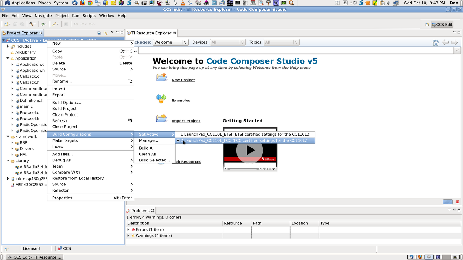

The Pics in this Article are of the Boards and Screen Shots of the various Software Applications and the Errors that I got while trying to setup the Boards for Testing. And below are links to more info, software and manuals for the, TI 430Boost-CC110L AIR Module BoosterPack Kit.

  • I installed Code Composer Studio V5 on Windows 7 but couldn't figure out how to get the Anaren firmware code make a proper project.  I contacted air@anaren.com and they sent me a link to video on drop box.  The video was difficult to see, but I did get it to work using following:
    Building the Anaren demo:
    1. Extract the firmware directory from the CD to location to use for new CCS workspace.
    2. Start CCS V5 and specify the above directory as your workspace
    3. Import Existing CCS project, using the workspace as search directory and select the CCS project.
    4. You can build it now, select FCC or ETSI config.
    5. Debug using default settings
    This produces a slightly different version of the demo, The supplied chips default to ETSI and have to be changed to FCC using the ATC GUI.
    Some of the other setting may need changing to get the FCC configuration,  I set it to FCC, config: 1 (38kps), channel 0 and RF power to 2 (2.8db) using the ATC GUI  Don't forget to make one of the units a sensor by pressing S2 3 times until the the red LED flashes 3 times in response.

  • Hi Don, interesting review, especially your attempt to use Linux software. But for programming and debugging msp430 under linux you have to use toolkit from this link: http://mspdebug.sourceforge.net/index.html. TI do not provide official linux support for Launchpad's debugger. A quick guide for this: http://hackaday.com/2010/08/11/how-to-launchpad-programming-with-linux/
