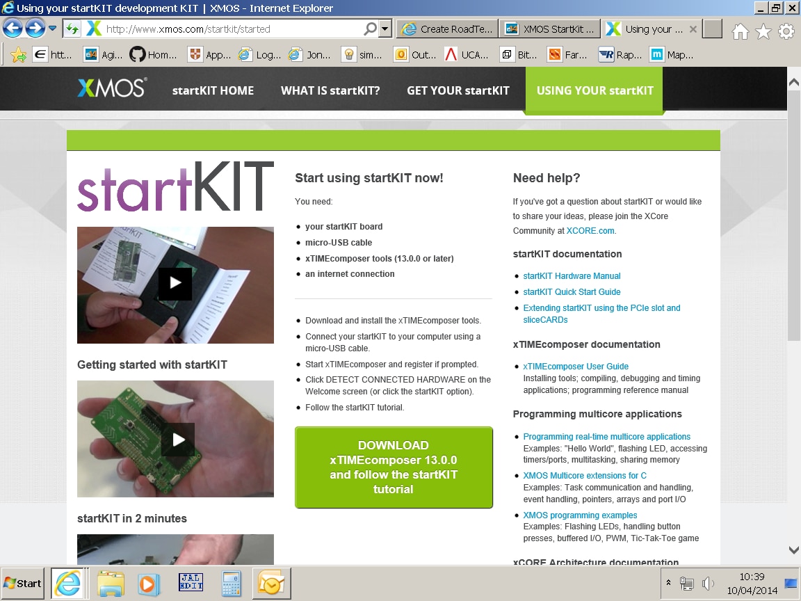

Once we have connected our board, we need to download the software that allows us to program it. The instructions for this can be found in the box. By entering the web address given (www.xmos.com/startkit) it take you to this page and we select the big green button, download xTIME composer.
To download this software requires you to create an account. When this is completed, you are sent an email with a link to begin the download. I had to try and register 3 times as the website kept crashing so be patient. However, the software installed quickly and doesn't take up too much space on your hard drive, approximately 260MB. After the installation, I found it had filled my desktop with shortcuts to everything, I deleted all except the xTIMEComposer Studio as I didn't think I would need them. Once Composer Studio is run, it offers where to save projects. By default this is in a folder called "workspace" in the main hard drive. I decided I wanted my projects elsewhere so redirected it to a folder in My Documents called "xmos".
