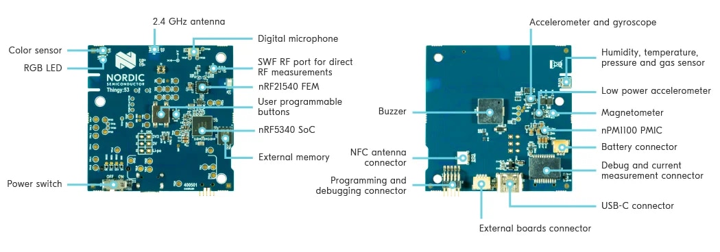

The Thingy:53 packs a high-performance 128 MHz Arm Cortex-M33 application core with 1 MB Flash + 512 KB RAM, and an ultra-low power 64 MHz Arm Cortex-M33 network core with 256 KB Flash + 64 KB RAM, providing a significant improvement in performance (around 20% more) compared to the Cortex-M4, with 1.5 DMIPS/MHz and 4.09 CoreMark/MHz.

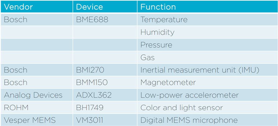

Equipped with a multi-protocol radio, it supports Bluetooth LE, Bluetooth mesh, Thread, and Zigbee, making it a versatile option for developing products for different IoT ecosystems. The Thread protocol compatibility can also help one develop for the Matter ecosystem. The Bluetooth Low Energy radio enables firmware updates and communication. It is also equipped with a broad range of integrated sensors, including environmental, color and light sensors, accelerometers, and a magnetometer, providing a rich source of data without the need for additional hardware. It also has an NFC-A tag (including antenna) with wake-on field and touch-to-pair features.

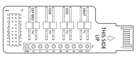

It is equipped with an onboard external connector that is compatible with Stemma, Qwiic, and Groove sensors. This allows for seamless integration with a wide range of sensors. Additionally, the bundled form factor current measurement and debug PCB is an incredibly useful tool for measuring consumption, particularly when executing machine learning on the edge. It also supports charging for the onboard battery through the USB-C.
Also, it has an RF front-end with two 2.4 GHz antennas (which might come in handy when trying to test the range - please note that output power above +10 dBM is not permitted in some regions):
  • ANT1 is connected to the nRF5340 through the nRF21540 RF FEM and supports TX gain of up to +20 dBm (default option).
  • ANT2 is connected to the nRF5340 through the RF switch and supports TX output power of up to +3 dBm.

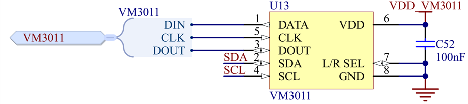

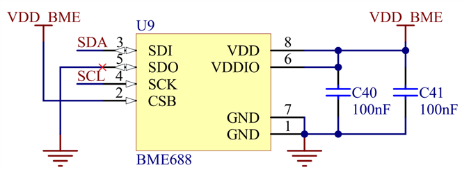

By utilizing the onboard environmental sensor and microphone, I should be able to seamlessly capture data to determine individual exposure levels, providing an opportunity to evaluate the system's ease of use. The onboard sensors of interest would be the BME688 (which boasts of onboard AI capabilities) and the VM3011, both of which are of high quality. The gas sensor can detect Volatile Organic Compounds (VOCs), volatile sulfur compounds (VSCs) and other gases such as carbon monoxide and hydrogen in the part per billion (ppb) range. The microphone with Adaptive ZEROPOWER ListeningTm technology automatically adjusts the acoustic threshold based on the background level of the environment. Maybe the piezo buzzer can be also used to generate an audio alert in case we reach our exposure limit for the day :)

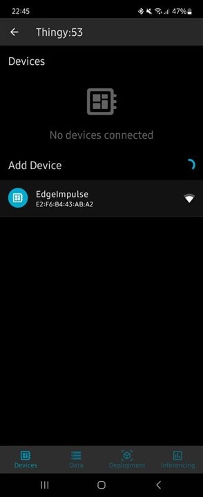

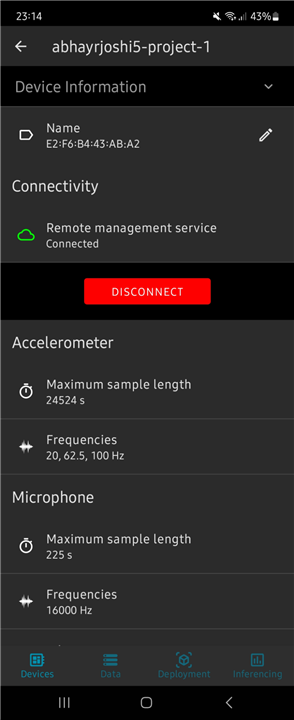

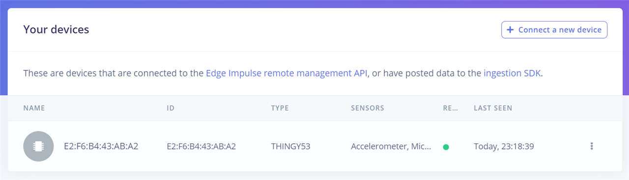

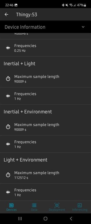

Initially, the device successfully established a connection, and the data from the sensors was visible. Unfortunately, it kept disconnecting after some time. However, after reflashing using the nRF Programmer for Thingy:53 and keeping the phone close to the device, the issue was resolved :)
image image image image

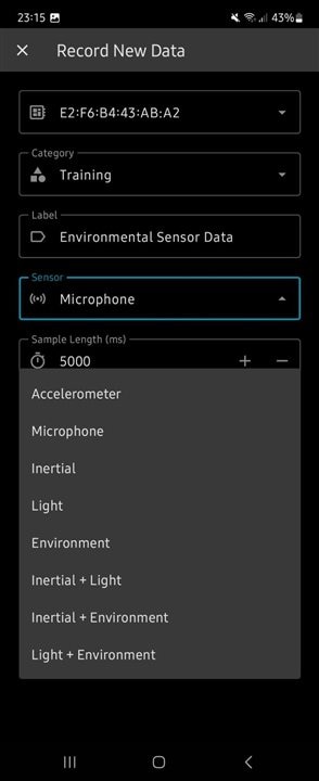

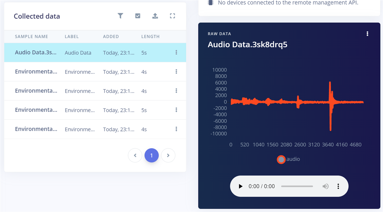

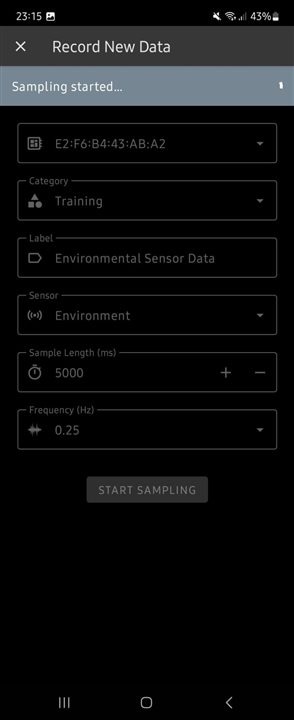

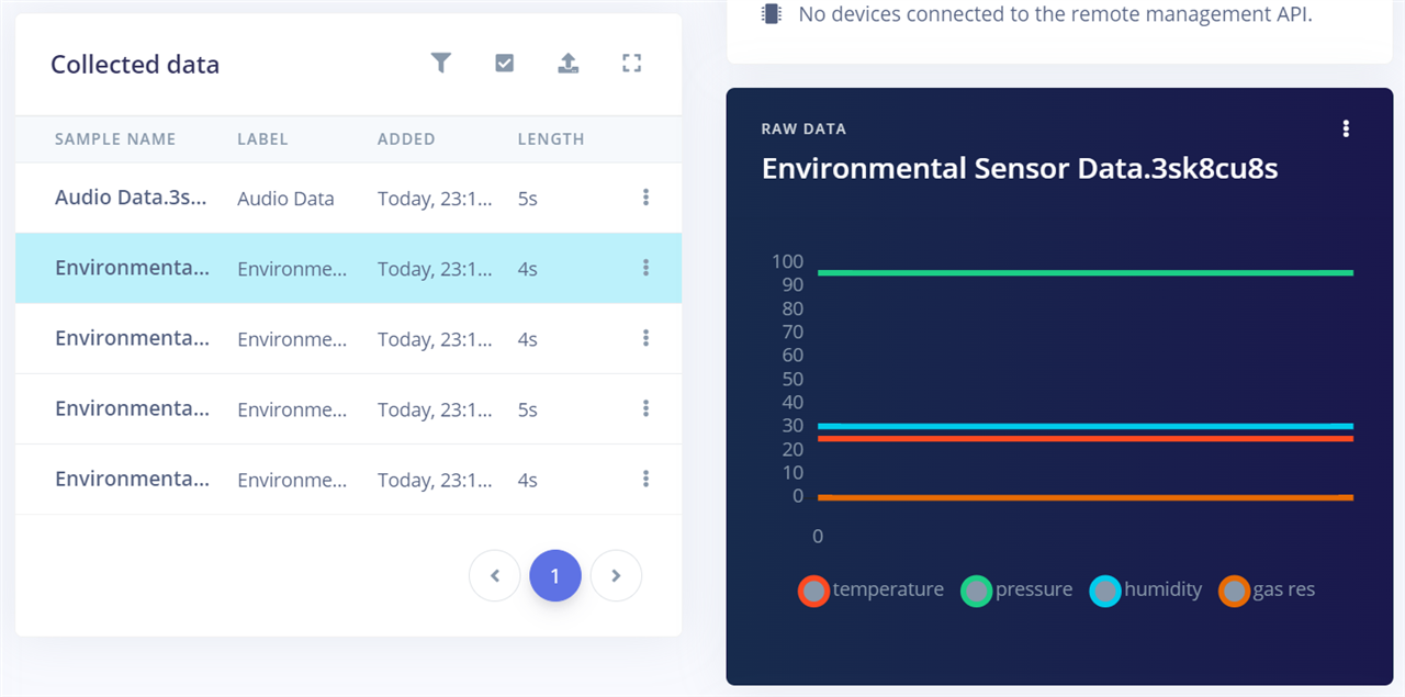

Capturing data is a breeze thanks to the intuitive data tab of the nRF Edge Impulse Application application. To demonstrate the device's capability, I recorded some sample microphone and environmental sensor data measurements using the app's data tab.

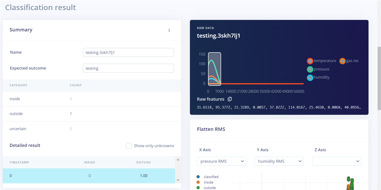

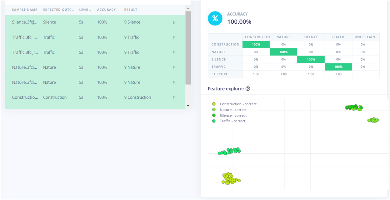

The captured data can be easily visualised on Edge Impulse platform. For now, I will use the precollected datasets to run inferencing on the device.
For Audio

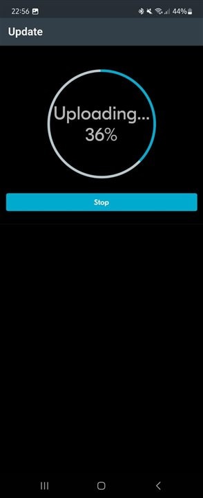

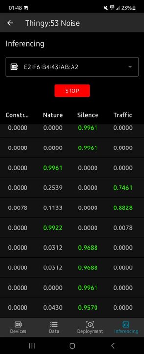

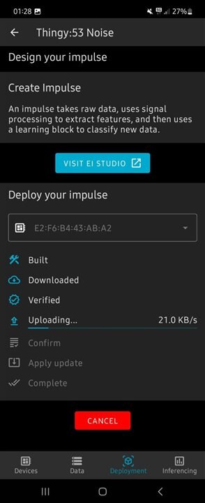

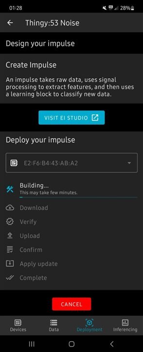

The mobile application provides easy access to the dataset, which can be deployed by accessing the deploy tab. Although the build process is generally quick for small datasets, it may take a few minutes. It is worth noting that the uploading bar runs multiple times, which may indicate a bug that requires fixing. After the deployment process is complete, we can move on to the inference tab and start the classification process. The results will display the classification categories (flow: inside - outside - playing video - inside).
The inferencing process can run in the background, although Edge Impulse warns against it:

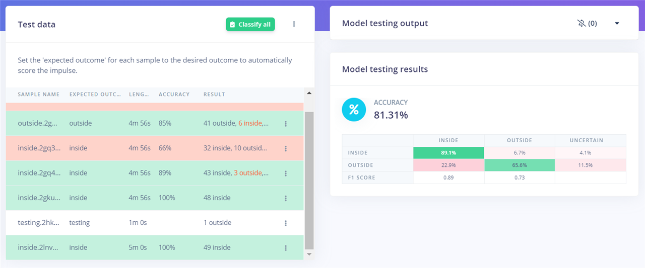

For the Environmental Sensors:

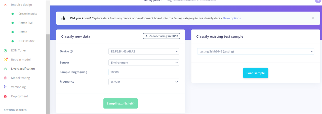

The online sampling and inference were tested using the Inside/Outside crowdsourced project.
And, as you can see, with a few clicks, you can acquire the data and run infer your results seamlessly!
