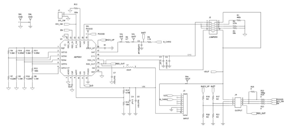

Hardware description
On the  evaluation board connector J1 should be jumpered. to enable VSYS connected to the output. Connector J2 is a 10 pin SMD connector.
By jumpering it one can select the output voltages of the LDO and VSYS power rail.
Pins 1 and 2 of J2 are also jumpered if SW is set as output. The VOUT can either be jumpered to the SYS output pin which is the switcher output or to the REGOUT pins.
The REGOUT pin can also deliver power independently of the VOUT pin.
 The PGOOD pin will toggle high when SYS ramps up to 3 V.
The BAT pin is connected through a 4.7 ohm resistor to a supercap.
REG_D0 pins is tied to GND on this evaluation board. This means that hysteresis boost mode cannot be enabled by pulling this pin HIGH. In addition to that the hybrid mode is disabled.
REG_D1 enables the LDO. This pin is connected with a zero-ohm resistor to the PGOOD pin. When PGOOD pin goes HIGH, the LDO is enabled.
R25 needs to be disabled to allow an external MCU to activate the LDO.
Configuring output voltage
VID sets the output voltage.  This is done by setting a jumper to J2 pins 3-4, 5-6, 7-8.
The output voltage is programmable via the external feedback resistor divider
using the equation:  VREG _OUT  = VREF  (1 R7/ R9)  where
VREF value is 1.0 V
The supported output voltages on this development board are:

J1 is used to stop Switching Boost Charger
Schmatic
PV board

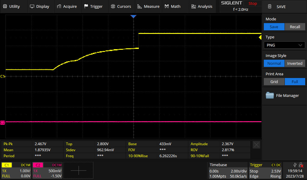

The scope plot (yellow) below shows the Vout pin when the supercap is charged.

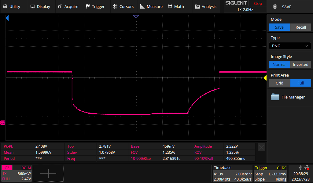

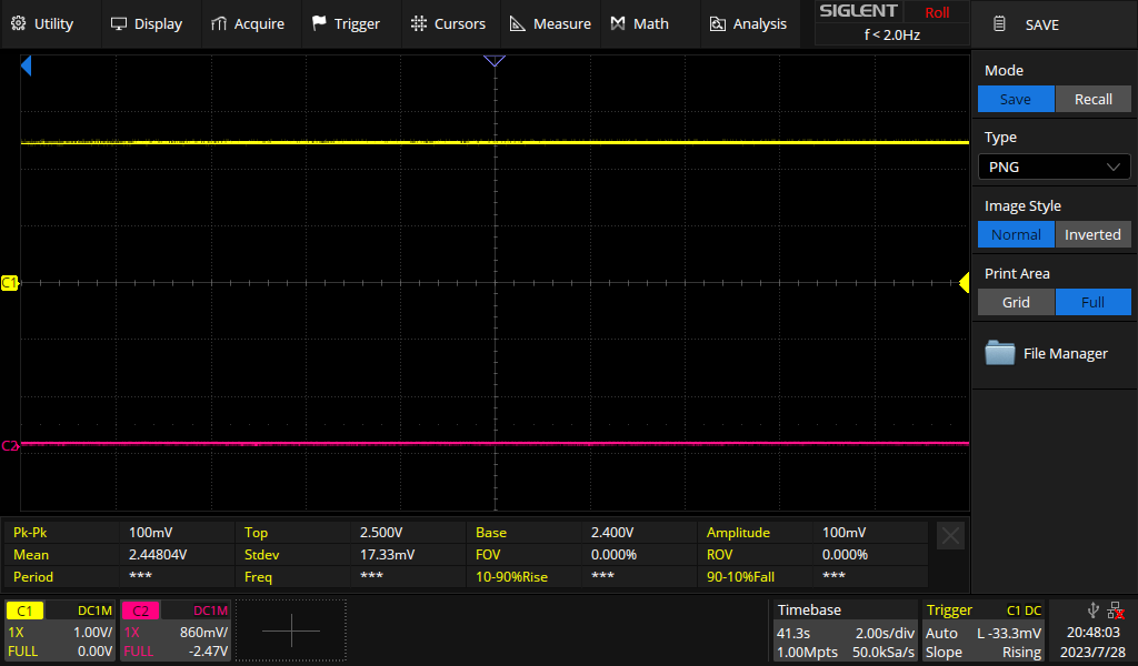

The scope plot below shows the LDO output collapses when a high impedance source is connected. The mote is always in sleep mode but when it wakes up sends the sensor data it can draw 56mA.
The scope plot below shows how the mote loads the LDO output .
When powering the mote from a 3.3V SMPS power supply sourced from a Li-ion battery every time there is a LORA packet transimiison the power supply rail droops.

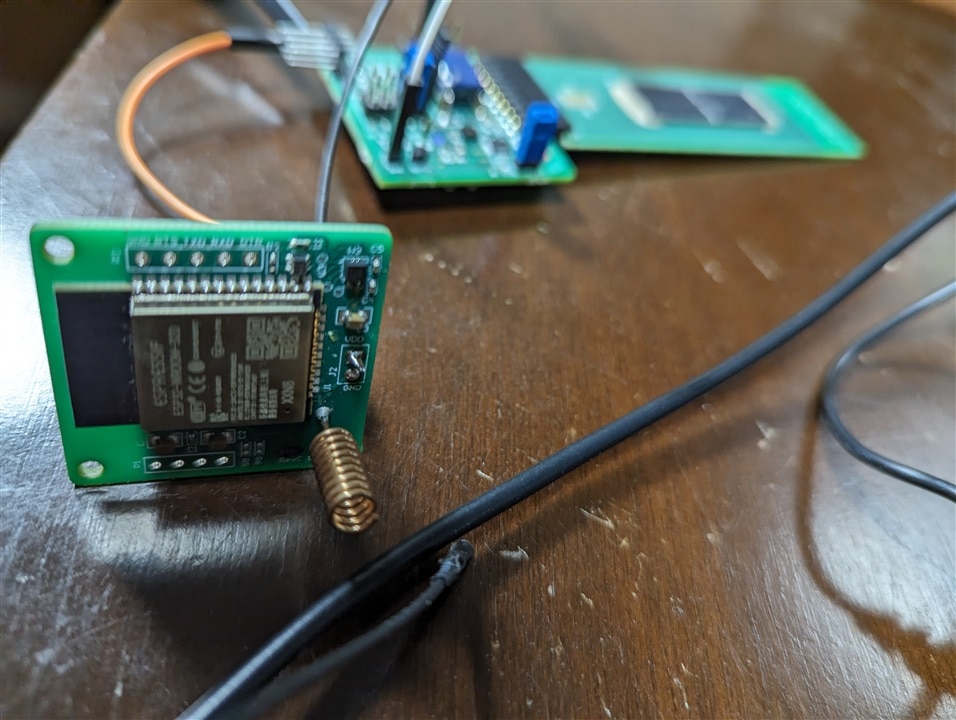

Building a bateryless mote
Wireless sensor nodes are called motes.  The simplest architecture of a mote is a PMIC coupled with an MCU and a radio. Due to the integration of RF frontend on modern chips it can be as simple as a two chip solution.

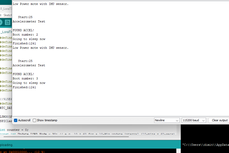

For this roadttest a custom mote was used. The mote couples a LORA radio with an ESP32 MCU.  The ESP32 stays in low power most of the time. It contains an IMU that has two interrupt pins. The IMU driver is configured to fire an interrupt if motion is detected. In addition to that as most MEMS, the IMU contains an internal temperature sensor.
The idea was to have this sensor coupled with an ESP32 will be used in order to send data to a gateway. The simplest scenario is to implement a Deep Sleep with Timer Wake Up. The ESP32 offers a deep sleep mode for power saving applications.
In this mode CPUs, most of the RAM, and all the digital peripherals which are clocked from APB_CLK are powered off.
The only parts of the chip which can still be powered on are: RTC controller, RTC peripherals ,and RTC memories
This code displays the most basic deep sleep with a timer to wake it up and how to store data in RTC memory to use it over reboots
While the ESP32 is not a state of the art MCU when it comes to power consumption it's main advantage is the BLE functionality that can be used in such scenarios.

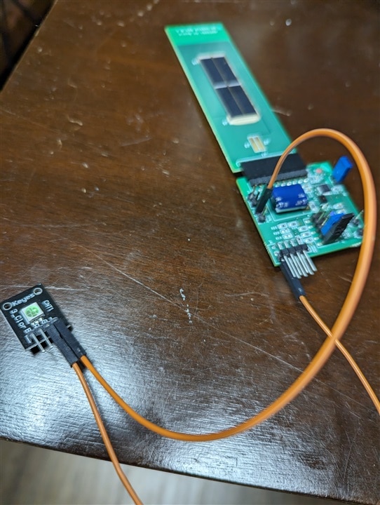

The tests above showed that the  ADP5901 cannot supply enough power to the mote under indoor light conditions. Testing with an LED shows that's it's not possible to power the LED for more than 1-2 seconds without a backup battery.
Powering an LED

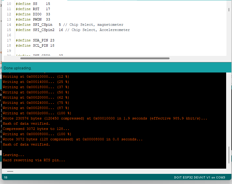

The mote firmware is configure to wake from sleep every 30 seconds. This can be modified and for the tests all the printf() were disabled. However the mote sill cannot be powered from the LDO output.
