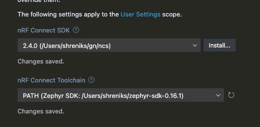

Setting Development Environment for nRF7002
Setting up Dev environment was time consuming but was straight foward. I just followed set by step instruction from here - https://developer.nordicsemi.com/nRF_Connect_SDK/doc/latest/nrf/installation/installing.html
Do not miss/skip any step from here including steps which has hyperlinks to Nordic's official website.
You also need to install nrfprogrammer.
After setting up this, you should be able to see following when creating new project for nRF7002

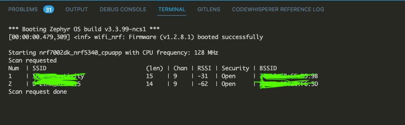

First and foremost I tried to understand given Asus AP’s Wifi 6 capabilities and nRF7002 association with Asus AP in WiFi 6 mode. Below is the most simplified diagram that explains how handshake happens between AP and STA
Now, I tried some Zephyr provided examples “sta” where we can configure AP SSID and PSK and it attempts to connect to AP. Following is the sniffer capture I could collect from my 11AC supported MacBook Air. Note that, all management frames can be captured from this since management frames are transmitted with basic rates. We do not need to have wifi6 supporting sniffer to capture them.

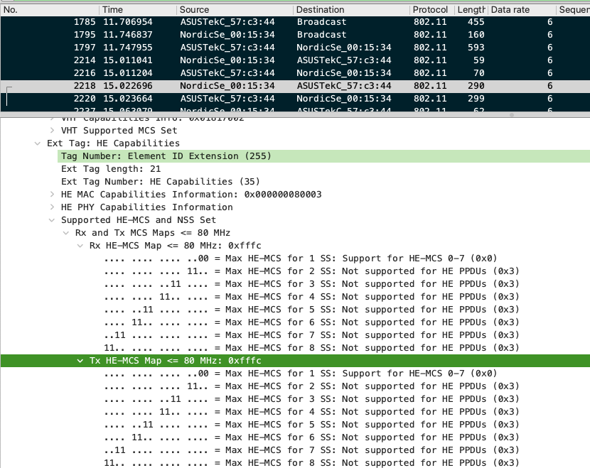

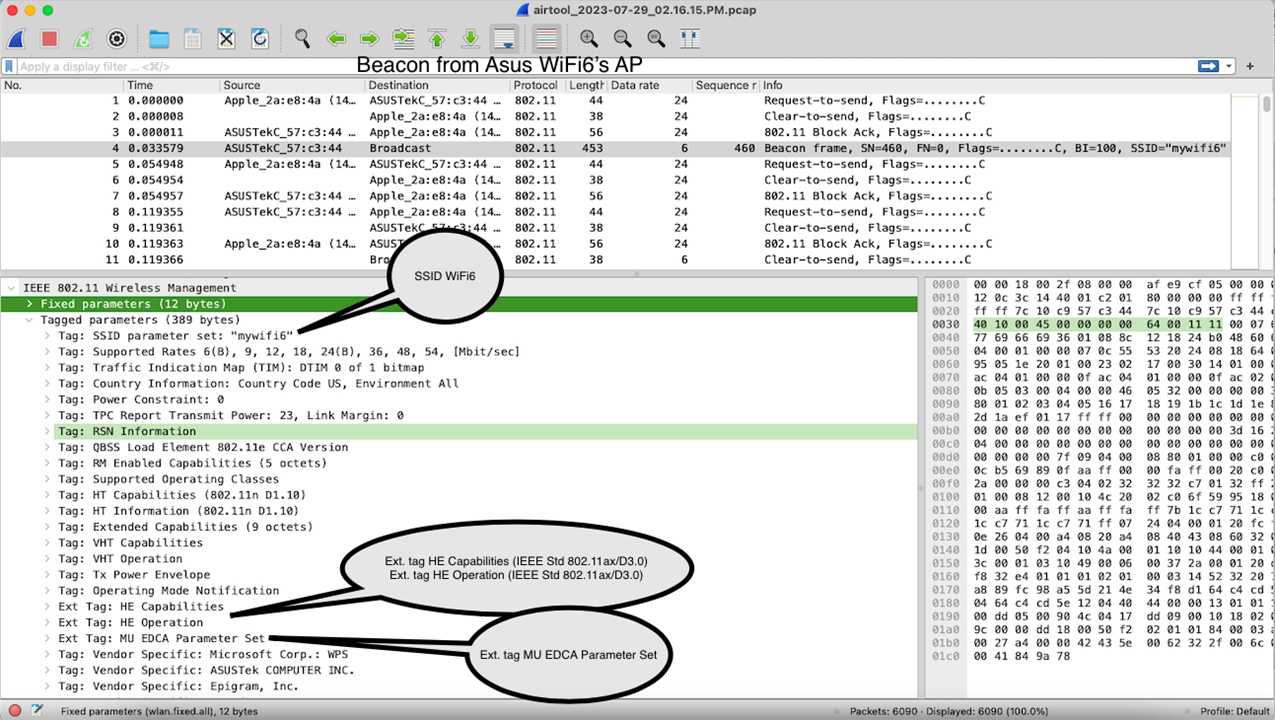

Beacon from WiFi 6 AP
HE capabilities show ax specification of AP
HE Capabilities are parts of IEEE802.11 Wireless Management header of Beason frame, and they include AP’s specification of IEEE802.11ax, there are a lot of fields, for example, supported HE-MCS and NSS Set with RX/TX MCS number with Spatial Streams and RU allocation.

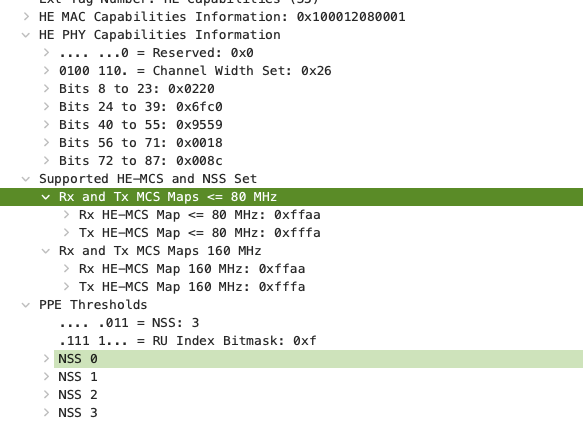

Association request from STA
STA sends actual connection settings to AP.
  • Bandwidth  <= 80 MHz
  • MCS 0-7
There are other many setting information in HE MAC Capabilities and HE PHY Capabilities, Supported Channels, SSID and so on.
- STA also supports Single User Beamformee (SU)- which involves focusing the transmission and reception of signals in specific directions to enhance the RSSI and quality between TX and RX device
STA also supports TWT requester support
TWT (Target Wake Time) is the new Wi-Fi6 mechanism that set individual sleep time between AP and STAs.STA set individual wake time in association. AP sends trigger packet to wake up the STA and STA sends back if needed.

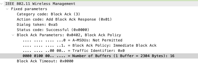

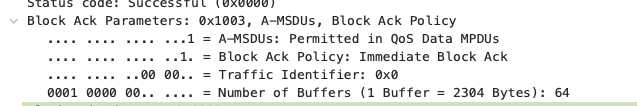

Aggregation setup
These ADDBA frames are responsible for setting up aggregation between AP<->STA. This can be unidirectional as well as bidirectional. In our case both AP and STA supports aggregation. AP uses 64 buffers for aggregation (AMPDU) and also supports A-MSDU. And nRF7002 uses 16 buffers for aggregation  and does not support AMSDU, which is kind of expected considering its low memory device.
nRF7002 sent ADDBA requesting 64 buffer for its transmission which was accepted by AP
But in when nRF7002 is RX it can only accept upto 16 buffers and no AMSDU which is kind of expected considering the processing and memory capabilities it has.
This completes the handshake between AP and STA and now the data path is opened to Tx or Rx.

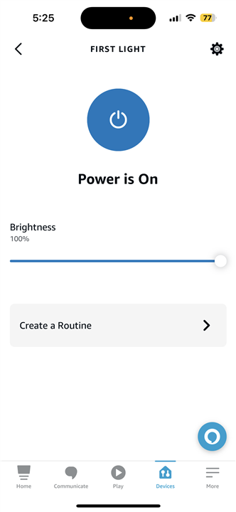

Testing the Matter based Light bulb accessory on my Echo show 5

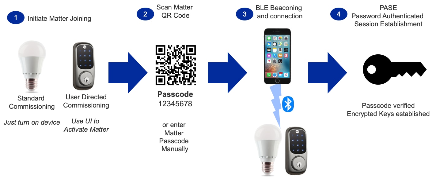

Matter commissioning flow
The commissioning process supports two potential starting points:
  1. The device is already on the network
  2. The device needs network credentials for Wi-Fi or Thread (requires Bluetooth LE (BLE) support)
Following diagram shows typical flow of Matter based device
Reference - https://docs.silabs.com/matter/1.0.3/matter-overview-guides/commissioning

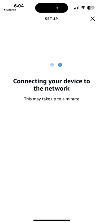

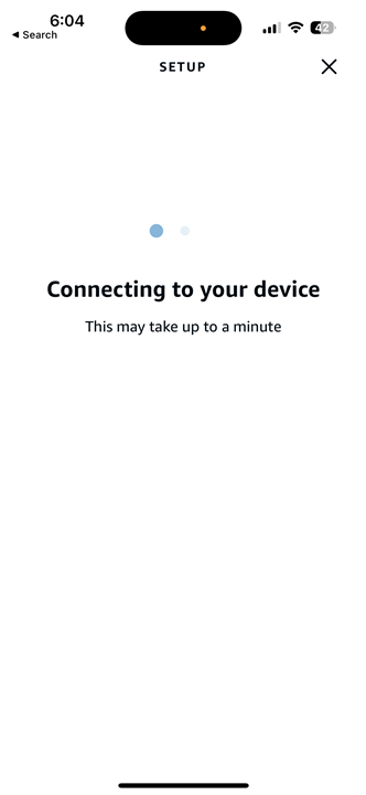

Once we compile and flash this application code, next step we need to do is commissioning the nRF7002 matter accessory

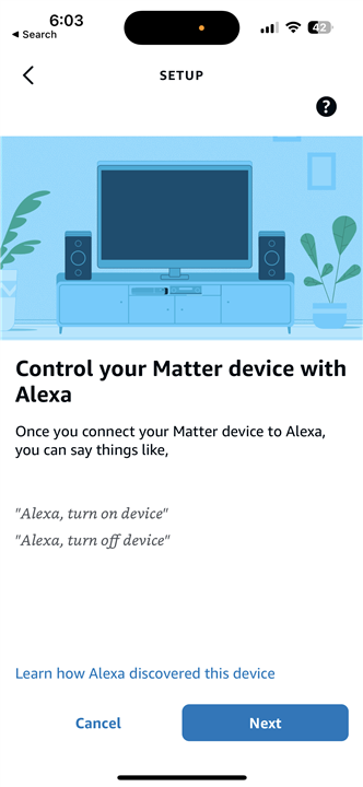

Showing screenshot on Alexa mobile app which takes you through a step-by-step process
Below is the log showing whole commissioning process happening on nRF7002

I: 151723 [EM]>>> [E:57409r S:40614 M:176012768] (S) Msg RX from 1:FFFFFFFB00000000 [41E5] --- Type 0001:08 (IM:InvokeCommandRequest)
D: 151737 [DL]WiFi scanning started...
D: 154222 [DL]Sending indication for CHIPoBLE TX characteristic (ConnId 00, len 3)
D: 154279 [DL]Indication for CHIPoBLE TX characteristic done (ConnId 0x00, result 0x00)
I: 156459 [DL]Wi-Fi scan done (0)
I: 156464 [EM]<<< [E:57409r S:40614 M:102513079] (S) Msg TX to 1:FFFFFFFB00000000 [41E5] --- Type 0001:09 (IM:InvokeCommandResponse)
I: 156476 [IN](S) Sending msg 102513079 on secure session with LSID: 40614
D: 156482 [DL]Sending indication for CHIPoBLE TX characteristic (ConnId 00, len 217)
D: 156619 [DL]Indication for CHIPoBLE TX characteristic done (ConnId 0x00, result 0x00)
D: 156754 [DL]Write request received for CHIPoBLE RX characteristic (ConnId 0x00)
I: 156762 [EM]>>> [E:57410r S:40614 M:176012769] (S) Msg RX from 1:FFFFFFFB00000000 [41E5] --- Type 0001:0a (IM:TimedRequest)
I: 156774 [EM]<<< [E:57410r S:40614 M:102513080] (S) Msg TX to 1:FFFFFFFB00000000 [41E5] --- Type 0001:01 (IM:StatusResponse)
I: 156785 [IN](S) Sending msg 102513080 on secure session with LSID: 40614
D: 156792 [DL]Sending indication for CHIPoBLE TX characteristic (ConnId 00, len 43)
D: 156889 [DL]Indication for CHIPoBLE TX characteristic done (ConnId 0x00, result 0x00)
D: 156897 [DL]Write request received for CHIPoBLE RX characteristic (ConnId 0x00)
I: 156905 [EM]>>> [E:57410r S:40614 M:176012770] (S) Msg RX from 1:FFFFFFFB00000000 [41E5] --- Type 0001:08 (IM:InvokeCommandRequest)
I: 156918 [FS]GeneralCommissioning: Received ArmFailSafe (300s)
I: 156924 [EM]<<< [E:57410r S:40614 M:102513081] (S) Msg TX to 1:FFFFFFFB00000000 [41E5] --- Type 0001:09 (IM:InvokeCommandResponse)
I: 156936 [IN](S) Sending msg 102513081 on secure session with LSID: 40614
D: 156943 [DL]Sending indication for CHIPoBLE TX characteristic (ConnId 00, len 71)
D: 157024 [DL]Indication for CHIPoBLE TX characteristic done (ConnId 0x00, result 0x00)
D: 157519 [DL]Write request received for CHIPoBLE RX characteristic (ConnId 0x00)
I: 157527 [EM]>>> [E:57411r S:40614 M:176012771] (S) Msg RX from 1:FFFFFFFB00000000 [41E5] --- Type 0001:0a (IM:TimedRequest)
I: 157539 [EM]<<< [E:57411r S:40614 M:102513082] (S) Msg TX to 1:FFFFFFFB00000000 [41E5] --- Type 0001:01 (IM:StatusResponse)
I: 157550 [IN](S) Sending msg 102513082 on secure session with LSID: 40614
D: 157557 [DL]Sending indication for CHIPoBLE TX characteristic (ConnId 00, len 43)
D: 157654 [DL]Indication for CHIPoBLE TX characteristic done (ConnId 0x00, result 0x00)
D: 157662 [DL]Write request received for CHIPoBLE RX characteristic (ConnId 0x00)
I: 157671 [EM]>>> [E:57411r S:40614 M:176012772] (S) Msg RX from 1:FFFFFFFB00000000 [41E5] --- Type 0001:08 (IM:InvokeCommandRequest)
I: 157684 [EM]<<< [E:57411r S:40614 M:102513083] (S) Msg TX to 1:FFFFFFFB00000000 [41E5] --- Type 0001:09 (IM:InvokeCommandResponse)
I: 157696 [IN](S) Sending msg 102513083 on secure session with LSID: 40614
D: 157702 [DL]Sending indication for CHIPoBLE TX characteristic (ConnId 00, len 71)
D: 157789 [DL]Indication for CHIPoBLE TX characteristic done (ConnId 0x00, result 0x00)
D: 157879 [DL]Write request received for CHIPoBLE RX characteristic (ConnId 0x00)
I: 157887 [EM]>>> [E:57412r S:40614 M:176012773] (S) Msg RX from 1:FFFFFFFB00000000 [41E5] --- Type 0001:0a (IM:TimedRequest)
I: 157899 [EM]<<< [E:57412r S:40614 M:102513084] (S) Msg TX to 1:FFFFFFFB00000000 [41E5] --- Type 0001:01 (IM:StatusResponse)
I: 157910 [IN](S) Sending msg 102513084 on secure session with LSID: 40614
D: 157917 [DL]Sending indication for CHIPoBLE TX characteristic (ConnId 00, len 43)
D: 158014 [DL]Indication for CHIPoBLE TX characteristic done (ConnId 0x00, result 0x00)
D: 158022 [DL]Write request received for CHIPoBLE RX characteristic (ConnId 0x00)
I: 158030 [EM]>>> [E:57412r S:40614 M:176012774] (S) Msg RX from 1:FFFFFFFB00000000 [41E5] --- Type 0001:08 (IM:InvokeCommandRequest)
D: 158043 [DL]Connecting to WiFi network: mywifi6
D: 158049 [DL]WiFi scanning started...
D: 160529 [DL]Sending indication for CHIPoBLE TX characteristic (ConnId 00, len 3)
D: 160624 [DL]Indication for CHIPoBLE TX characteristic done (ConnId 0x00, result 0x00)
I: 162689 [DL]Wi-Fi scan done (0)
I: 164260 [DL]Connection to mywifi6 requested [RSSI=-33]
E: 164265 [DL]Long dispatch time: 1576 ms, for event type 3
D: 164270 [DL]Write request received for CHIPoBLE RX characteristic (ConnId 0x00)
D: 166778 [DL]Sending indication for CHIPoBLE TX characteristic (ConnId 00, len 3)
D: 166879 [DL]Indication for CHIPoBLE TX characteristic done (ConnId 0x00, result 0x00)
I: 168550 [DL]Connected to WiFi network
I: 168554 [EM]<<< [E:57412r S:40614 M:102513085] (S) Msg TX to 1:FFFFFFFB00000000 [41E5] --- Type 0001:09 (IM:InvokeCommandResponse)
I: 168566 [IN](S) Sending msg 102513085 on secure session with LSID: 40614
D: 168573 [DL]Sending indication for CHIPoBLE TX characteristic (ConnId 00, len 69)
D: 168580 [DL]Using wifi MAC for hostname
I: 168584 [DIS]Advertise operational node 84B487F9D11741E5-01A30FC938AA4630
D: 168591 [DIS]Responding with _matter._tcp.local
D: 168596 [DIS]Responding with 84B487F9D11741E5-01A30FC938AA4630._matter._tcp.local
D: 168604 [DIS]Responding with 84B487F9D11741E5-01A30FC938AA4630._matter._tcp.local
D: 168612 [DIS]Responding with F4CE36001534.local
D: 168617 [DIS]Responding with F4CE36001534.local
D: 168621 [DIS]Responding with _I84B487F9D11741E5._sub._matter._tcp.local
I: 168629 [DIS]CHIP minimal mDNS configured as 'Operational device'; instance name: 84B487F9D11741E5-01A30FC938AA4630.
I: 168640 [DIS]mDNS service published: _matter._tcp
I: 168645 [SVR]Operational advertising enabled
I: 168651 [SWU]Stopping the watchdog timer
I: 168655 [SWU]Starting the periodic query timer, timeout: 86400 seconds
E: 168661 [SVR]Server initialization complete
I: 168665 [DIS]Updating services using commissioning mode 0
E: 168671 [IN]SO_REUSEPORT failed: 109
I: 168676 [DIS]CHIP minimal mDNS started advertising.
D: 168716 [DL]Using wifi MAC for hostname

Demo video
This is a matter based light which is added to Alexa, and now it can be controlled through my Echo Show and Alexa mobile.
