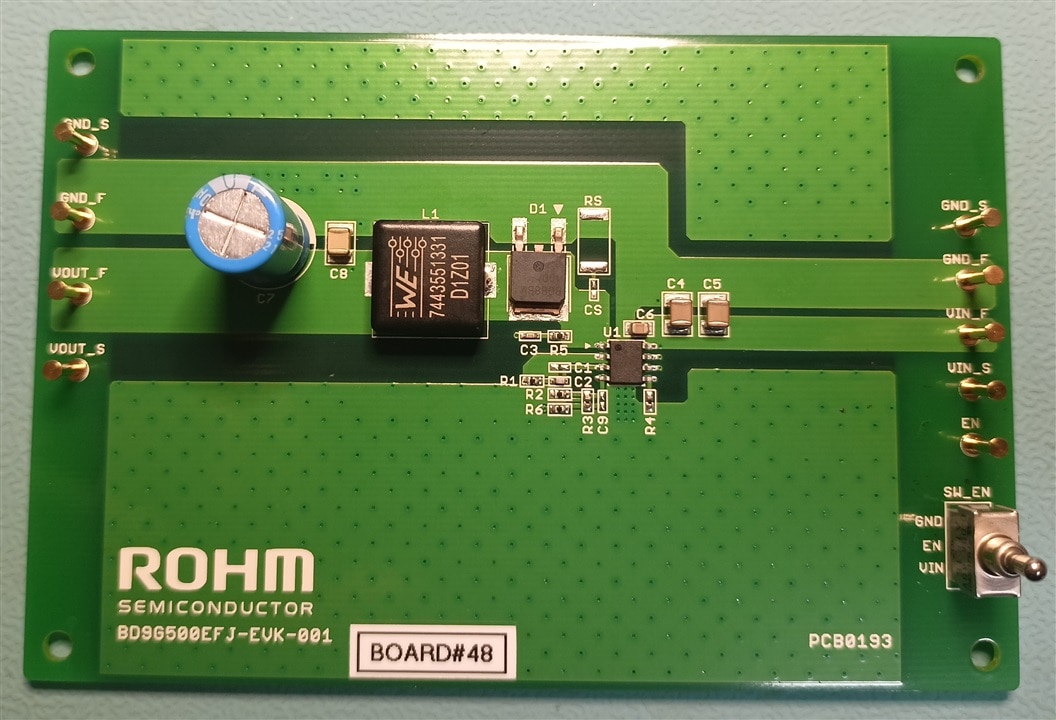

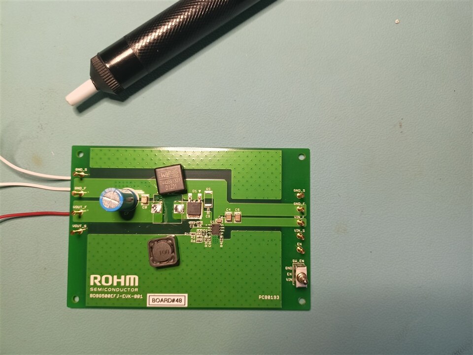

The board arrived nicely packed in a rather stilish box. Inside, the board is protected by a conductive bag and firmly kept inside by two foam pieces.
The board is a high quality 4 layer board with 70um copper on outside layers and 35um copper for inner layers. All components are nicely labeled on the front silkscreen but many of them are too tiny in my opinion (0402 package). Space is not a concern on this board and I would have preferred slightly bigger passives to ease up any component swap.
I like input and output test pins and the fact that are arranged for a 4-wire measurement, but there are not any other test points readily available to easily probe signals like switching node and feedback loop.

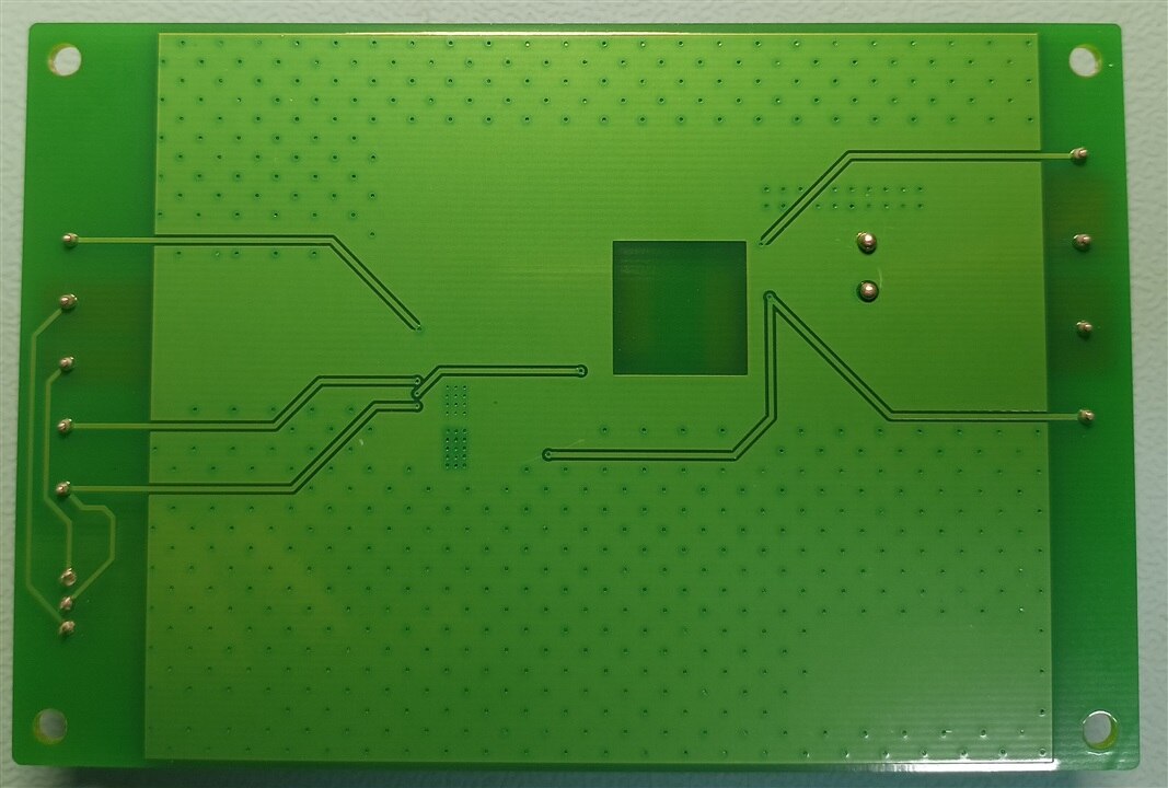

By flipping the board, we can see more clearly that ground planes don't extend all the way to board edges and leave some traces "dangling" in mid air, without any reference plane. Moreover, there is a copper hole under the inductor that cuts all three ground layers. I don't know why they chose to do so (maybe there is a good reason that I don't know) but it's something that I would not suggest doing. A worth reading, suggested by  in my first post on this argument is the following: https://www.signalintegrityjournal.com/blogs/17-practical-emc/post/2694-dc-dc-converters-solid-return-plane-or-cutouts-under-switch-node-and-inductor.

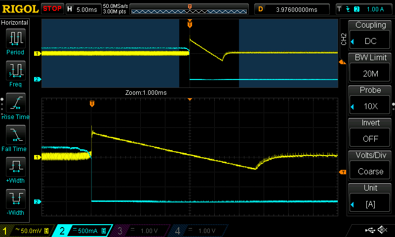

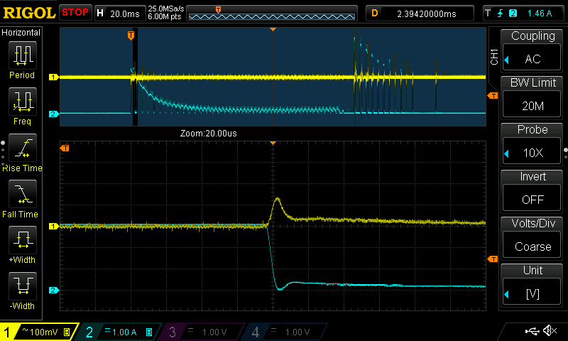

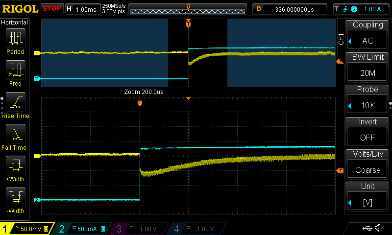

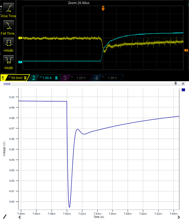

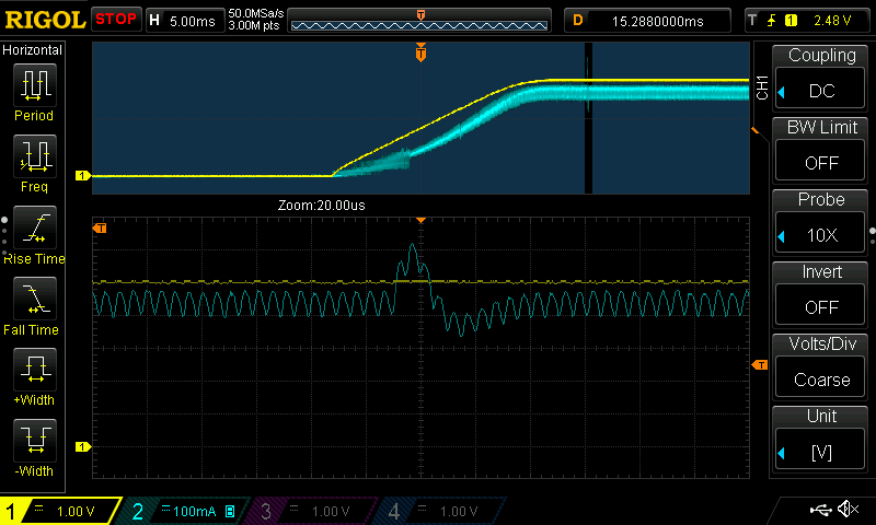

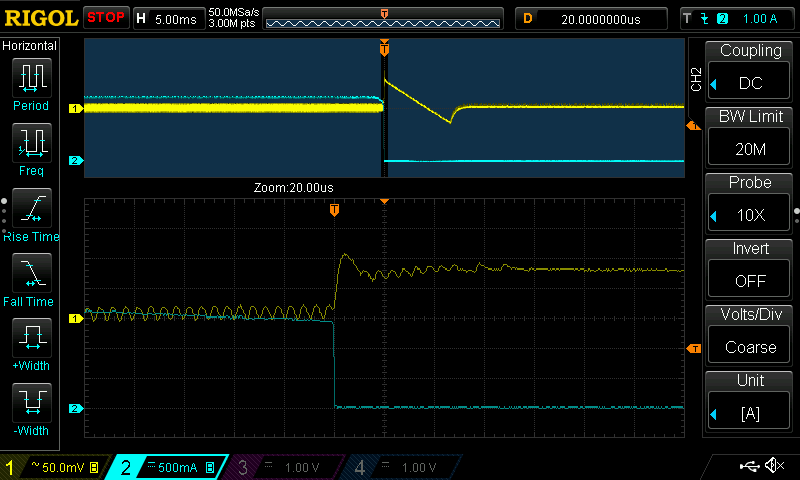

Dynamic performances were quite good as well, showing great transient response on both rising and falling edges of a step current load. Rising edge behavior was usually better but that's expected, especially if the falling edge goes abruptly from high current to zero. Soft start works great, even if there seems to be a small anomaly in the input current behavior when it finishes.
{gallery}Transient response and soft start
Transient response from 0A to 1.7A
Transient response from 1.7A back to 0A
Closer look to transient response from 1.7A back to 0A
Start up voltage and current

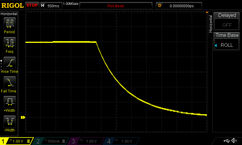

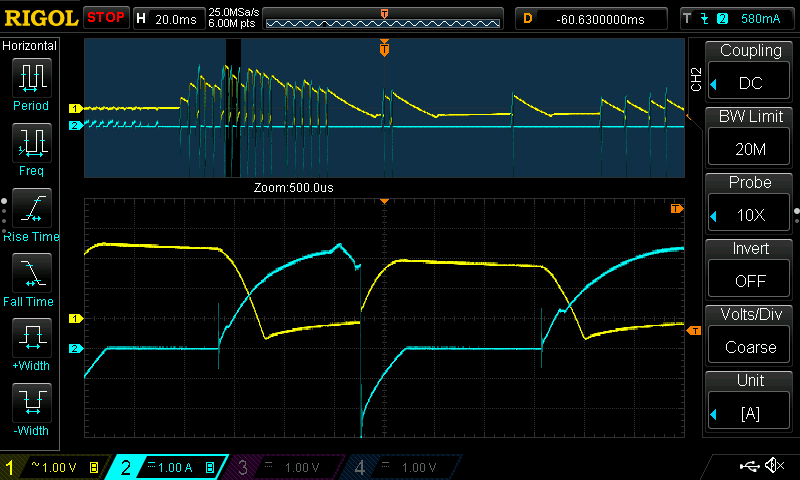

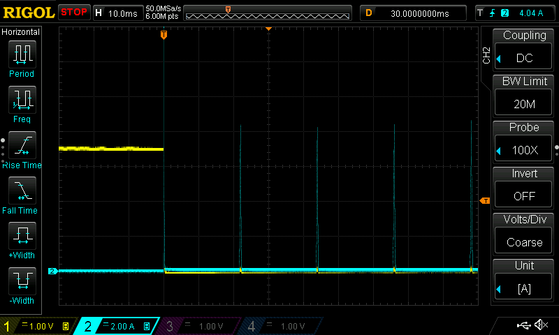

Looking at protections, input undervoltage worked flawlessly, as well as short circuit protection. Overvoltage protection worked as well too, while the overvoltage discharge feature didn't completely satisfy me (but my test was pretty brutal).
{gallery}Some protection features
Output behavior during an input undervoltage event
Short circuit protection in action
Output behavior in case of a strong inductive load dumping back energy: output is slowly discharged

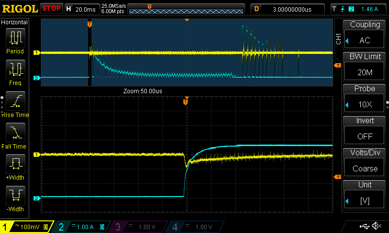

Enhancing transient response behavior

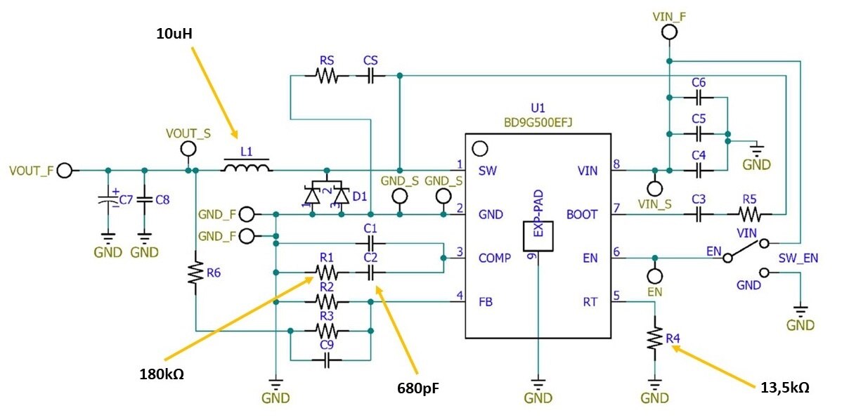

To test ease of design and support material, I tried to improve the already good transient response that the BD9G500EFJ-EVK-001 design provides.
Using a bit of experience and the comprehensive support material Rohm provides on the product page I was able to reach my goal, achieving an even more impressive transient behavior (voltage variation in the order of 100mV for a 3.5A load current variation!). Noticeably, I was able to achieve it on the first try, thus avoiding spending time on testing and development loops. This should speak for itself for the support material quality and quantity.
Swapping components went fine, even on those small 0402 passives. Beware: removing the inductor is not so easy!
{gallery}Modified evaluation board
Modified scheme
Board surgery!
Transient response to 3.5A step load
3.5A to "zero" response

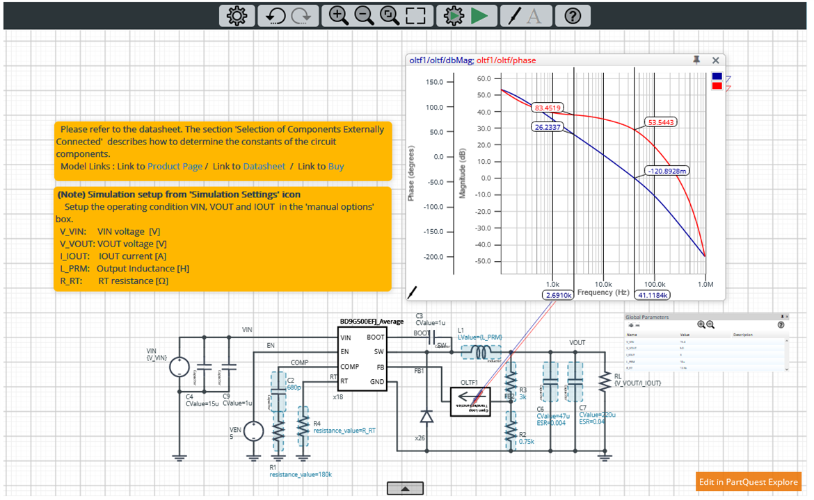

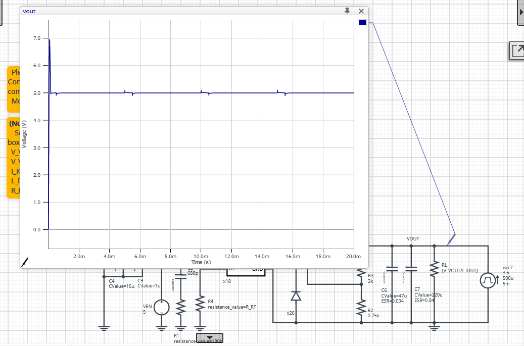

Online simulation tool

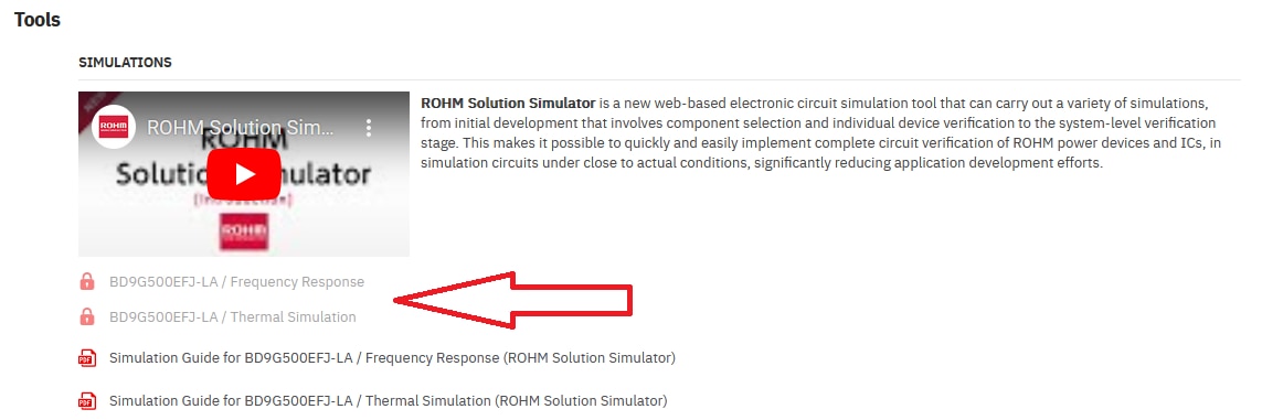

Among all kinds of support material, Rohm provides a PSpice model (with a beautiful application note comparing simulation and real measures). But if you don't have some sort of PSpice (like I do) Rohm provides an online simulation tool with an already prepared simulation circuit. Very nice and handy! To get access to it, you only need to create a Rohm account.
Once logged in, you will find an already prepared simulation test bench. Rohm provides a simulation guide too, but it wasn't really necessary for me as it was already well prepared and easy to use. Here, you can play with circuit parameters and verify your circuit loop stability before assembling the real circuit (not the other way around like I did Slight smile ).

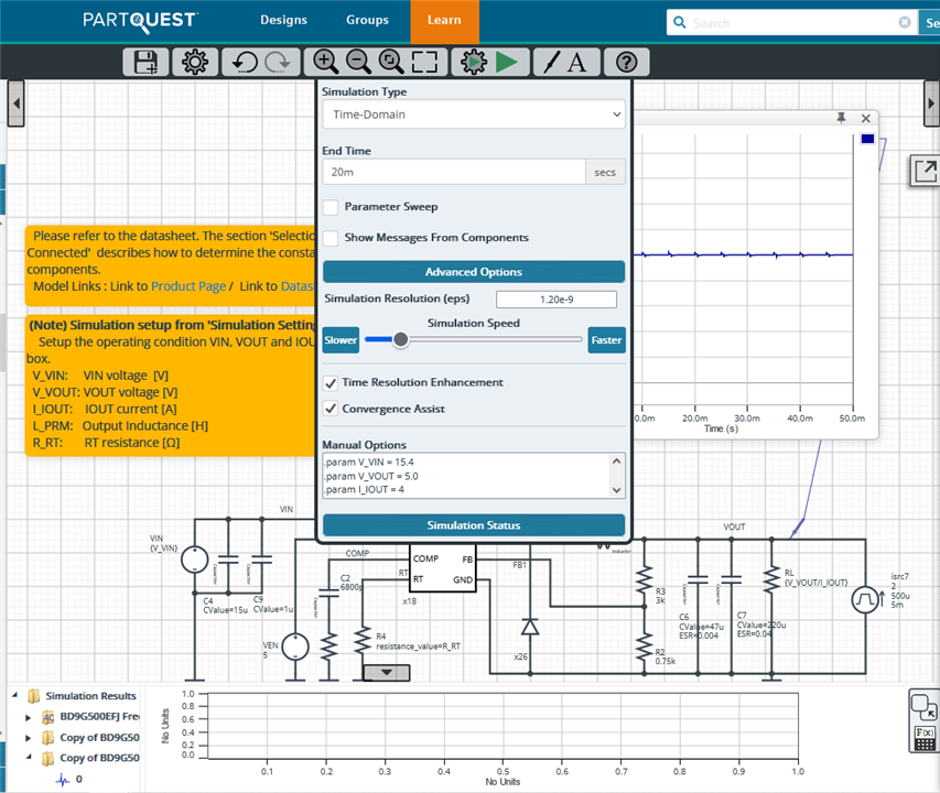

With a bit of tinkering, I also was able to edit the circuit to execute a transient simulation and compare simulated results with my test measures. They were incredibly close!
{gallery}Transient simulation
Time domain simulation parameters
Time domain simulation result
Simulation comparison with real measure
