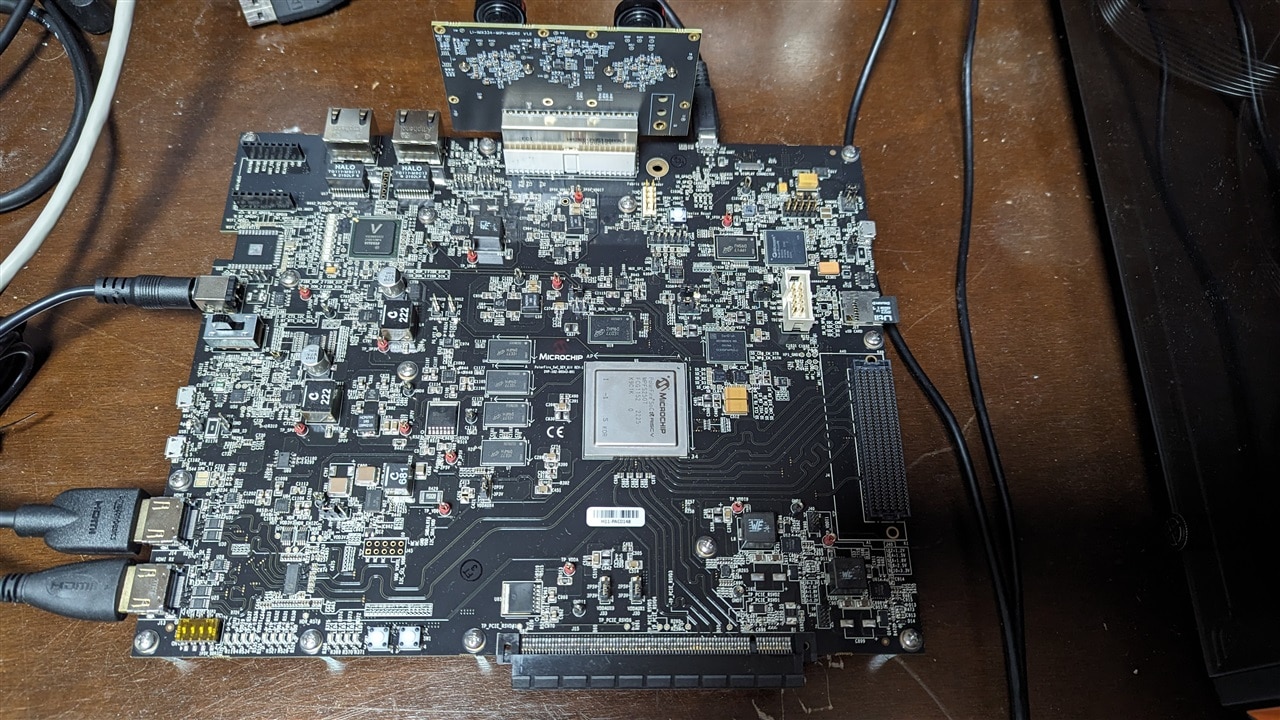

2. A look at the hardware
{gallery}Polarfire Video SOC
Polarfire Video SOC

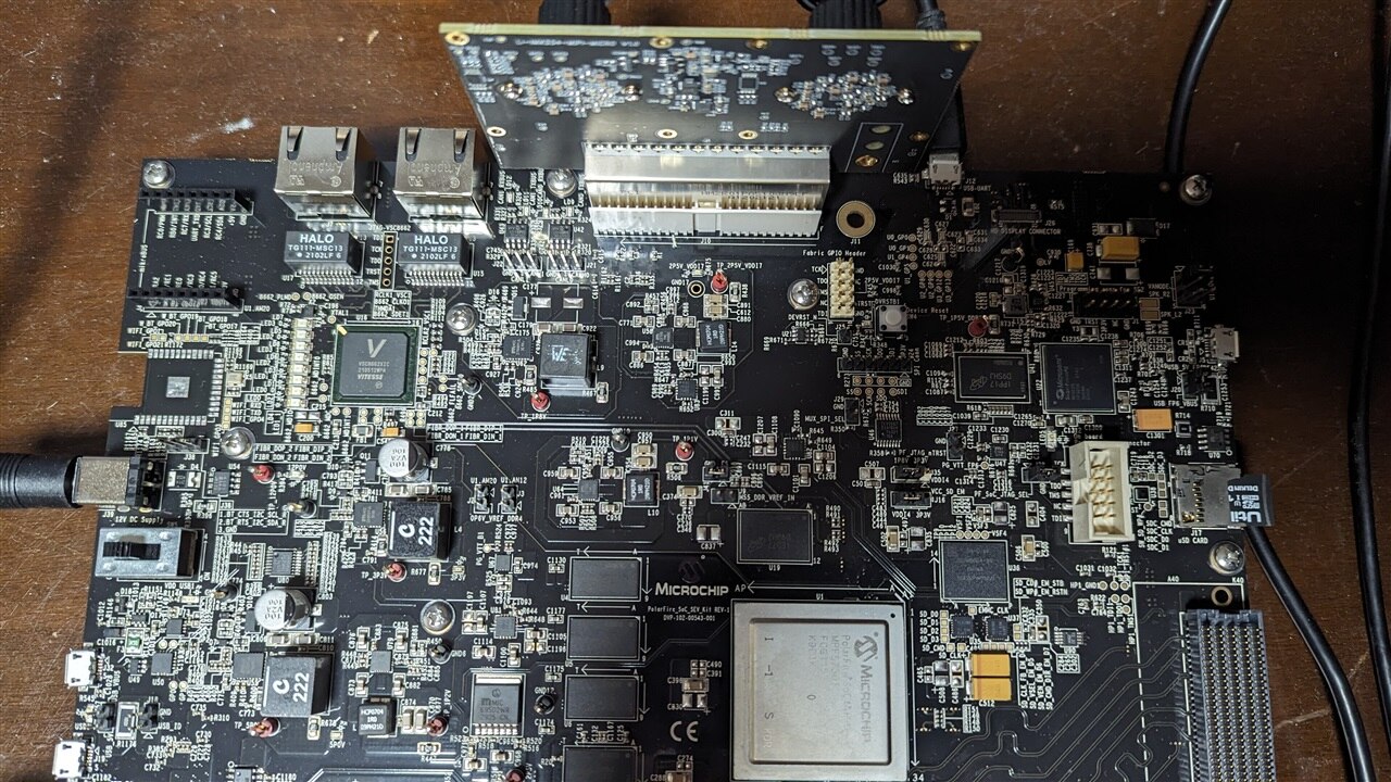

The main features of the board are:

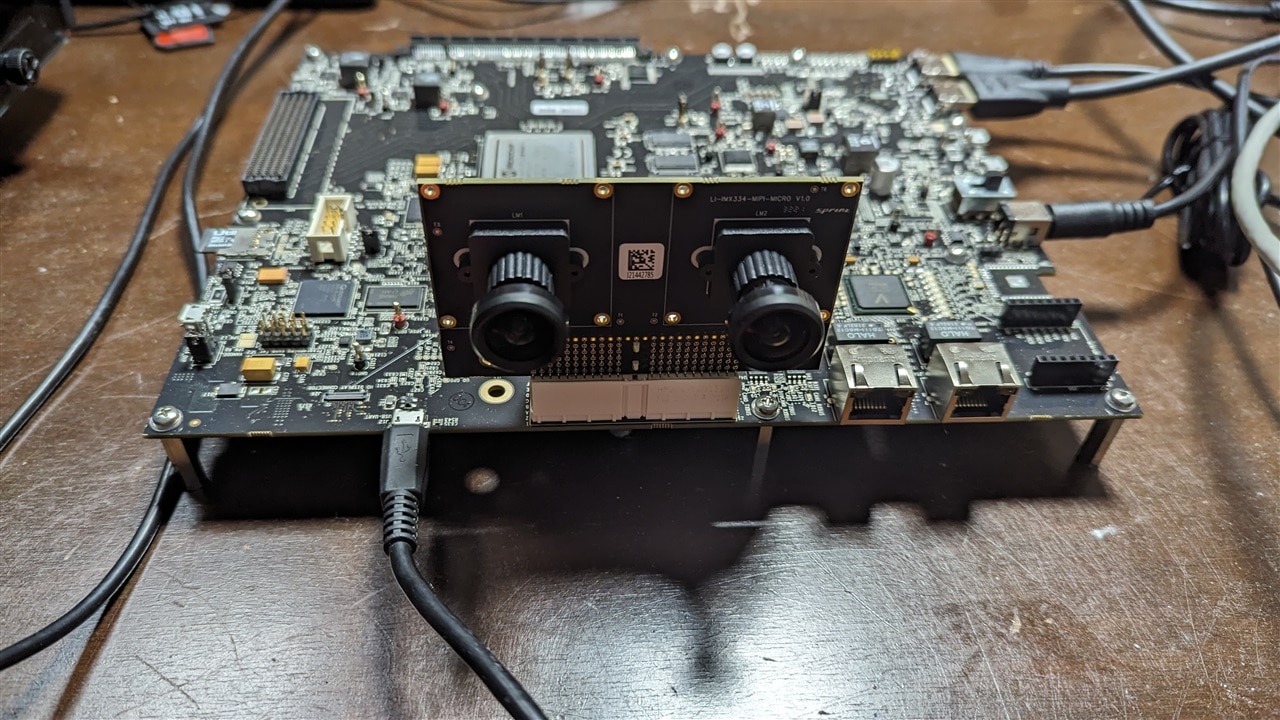

1. Stereo camera mezannine based on the IMX334 image sensor
2. Dual Gigabit Ethernet
3. PCI root endpoint
4. USB Host
5. Embedded Flash 6 Programmer
6. FMC VITA HPC connector
7. HDMI RX and TX connector
8. 1 MicroBUS connector for connecting embedded sensors
9. WIFI module - Not populated
The complete list of features is given on the product page at : https://www.microchip.com/en-us/development-tool/mpfs250-video-kit
Strangely enough the board comes with an unpopulated footprint for ATWIlC3000-MR110CA_NL.
The actual kit that was shipped did not contain a MIPI DSI display. However the dual stereo camera was included. The board setup is documented on the following git repo:
https://github.com/polarfire-soc/polarfire-soc-documentation/blob/master/reference-designs-fpga-and-development-kits/mpfs-video-kit-user-guide.md
2.1 Out of the Box experience
The board out of the box comes  pre-programmed with a Yocto image on the emmc. However this is an old image using the 2022.2 release and it has to be updated in order to use either the latest VectorBlox SDK or any of the latest H264 Video encoder reference designs.One important point is to synchronize between the buildroot image versions and the Libero reference designs as they must match. Otherwise one will observe kernel hanging during boot.
The emmc update procedure is shown on this page: https://github.com/polarfire-soc/polarfire-soc-documentation/blob/master/reference-designs-fpga-and-development-kits/updating-mpfs-kit.md#programming-a-linux-image
To get started simply attach the USB and open the 3rd serial port. The provided image does not have a GUI included on the Yocto Linux image
On the latest images 2023.1 and 2023.2, DHCP is enabled by default so plugging an Ethernet cable should be enough to connect to the network. ideally , Microchip could also have added the WIFI module , to allow wireless connectivity. It does not seem that this is currently supported on the Yocto image. The documentation does not provide any reason why the WIFI module was not populated. The board comes with a hefty power supply.
