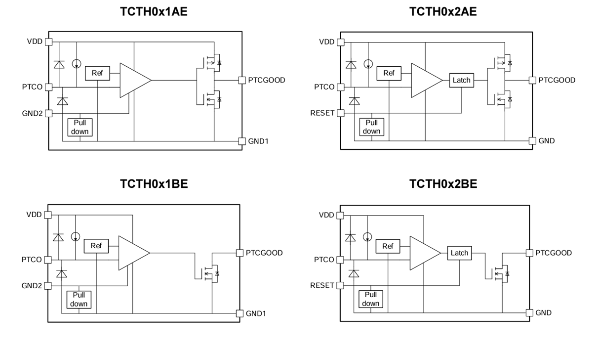

The TCTH022BE operates by integrating several functions into a single chip, making thermal management both straightforward and easy. Internally, the chip begins its operation by taking the resistance from the connected PTC thermistor and measuring the voltage at which the specified current passes.  The Thermoflagger comes in both 1uA and 10uA variants.  This voltage is then fed into an internal amplifier that boosts the signal to a level suitable for the chip's processing needs.
The comparator is constantly comparing the incoming voltage signal against a stable reference voltage generated within the chip. This reference voltage is carefully calibrated to correspond to a specific voltage threshold.  With the temperature it triggers, set by the selected PTC.  Depending on the PTC selected the comparator might trigger at different temperatures.
When the voltage from the PTC thermistor exceeds this reference (indicating that the temperature has crossed the threshold), the comparator trips, changing its output state. This triggers the digital control logic inside the IC, which then drives the output pin either high or low, depending on the design. This output can be connected directly to other digital systems, such as microcontrollers, or used to activate cooling systems or alarms, offering a simple yet effective way to manage over-temperature conditions.
The chip is designed with built-in hysteresis, which is a small temperature buffer that prevents the output from rapidly toggling if the temperature is hovering right around the threshold. This ensures stability and avoids false alarms, which can be a real headache in thermal management systems.

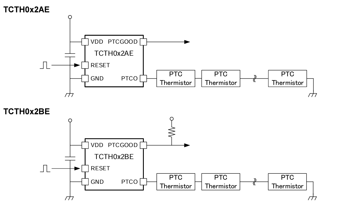

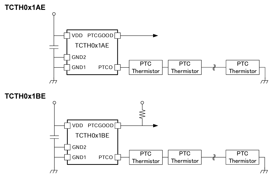

Looking at the four different application schematics shown in the datasheet the Thermoflagger requires one or two additional components in addition to the main chip and PTC elements.  But where it differs from the previous two discrete solutions is that it can work across the wide voltage range of 1V7 to 5V5 without needing adjustment, allowing the same schematic to be dropped into a variety of designs as a without needing to be redesigned for each application or voltage (other than selecting the correct PTC values based on temperate requirements).

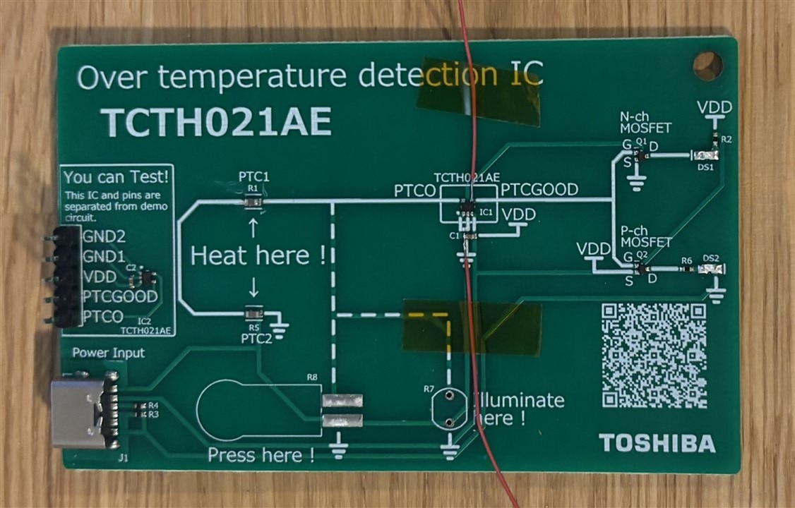

I tested the board provided through the roadtest program with the supplied PTC thermistor.  I had intended to test it with a photoresistor that I had on hand, but that actually ended up being a phototransistor so it wouldn’t work here.  Unfortunately, I did not have a force sensor, but for my potential use cases for an IC like temperature sensing the is most useful application anyways.  In future testing I plan on trying to use NTC elements with the Thermoflagger to see if they work in reverse to the intended use as I hypothesize.  When I do that testing I plan on updating my roadtest review with that data.

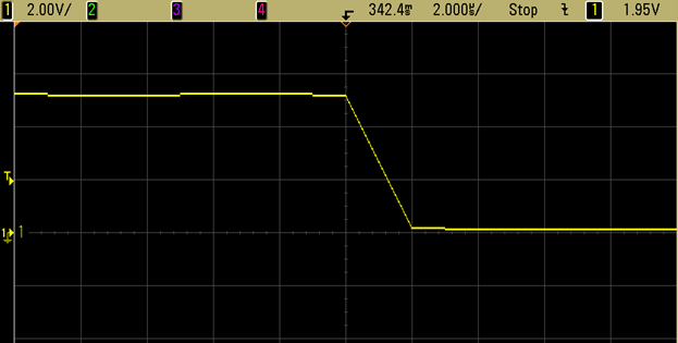

While it was nice of Toshiba to include a totally separate unconnected chip for designing into our own applications, it would be have been nice of them to put in probe points for their demo circuit.  I had to solder some wires to the ground leads and PTCGOOD line.  By connecting a probe here I was able to look at the stability and rise/fall time.
During my testing the digital output from the Thermoflagger IC appeared to be very stable, which is good since it would prevent any false positives from occurring and causing problems or resetting any circuits.  As can be seen in the screengrab from my scope, there is not much if any noise at the highs, lows, and transition points.  All around a very smooth signal that does not require any additional filtering.  The reaction time of the chip also appeared to be very quick, with the fall time and rise time appearing to be about 2uS.

Toshiba advertises this primarily for use in portable devices and power supplies for easy monitoring of multiple components at once.  When at least one device in the chain is triggered as failed, this method assumes all failed or is overtemperature as a failsafe.  While this makes the circuit and applications simple, this is unfortunately also the drawback of this particular component.
In this image provided by Toshiba, they also show the Thermoflagger not being used as the primary temperature monitoring, but more as a check to ensure that various temperature monitoring solutions have not failed.  So more as a backup than a primary solution here.
