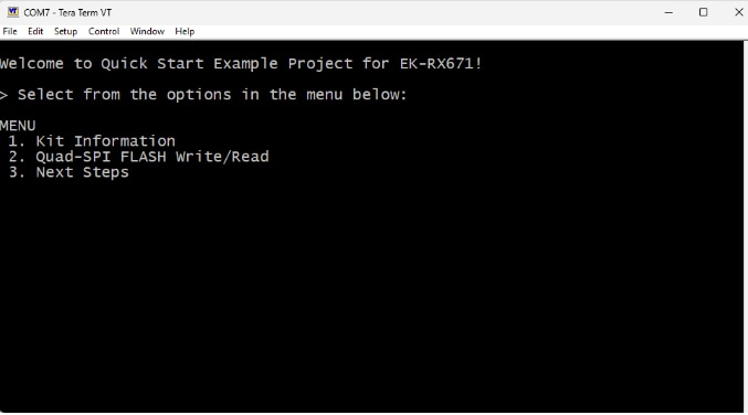

The demo uses a Serial port to communicate with the PC and show the user a menu with 3 options:
  1. Show the Kit information
  2. Test the Quad-SPI Flash
  3. Links for documents and next steps
 The Kick Start Guide has the instructions to run the demo application, it was very straightforward to make the demo runs:

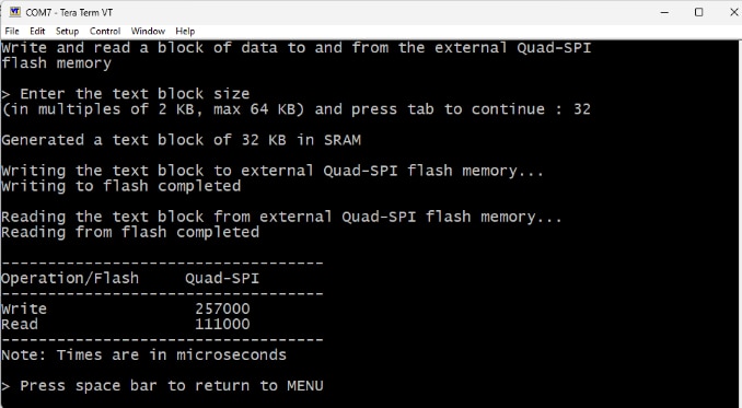

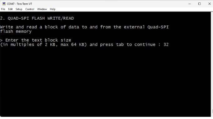

The second option from the menu brings to the Quad-SPI Flash test, where is possible to choose the block size for the data that will be written and then read, you can choose 2KB to 64KB with a block size of 2KB:
At the end of the Quad-SPI Flash test, the terminal shows the time to write and read in microseconds:

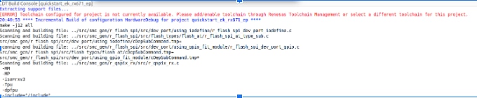

My first try was to use a Linux-based PC to run the e2 studio and compile/build the example application, unfortunately, after some days of trying to fix an issue on the compiler I gave up and moved to a Windows-based machine.

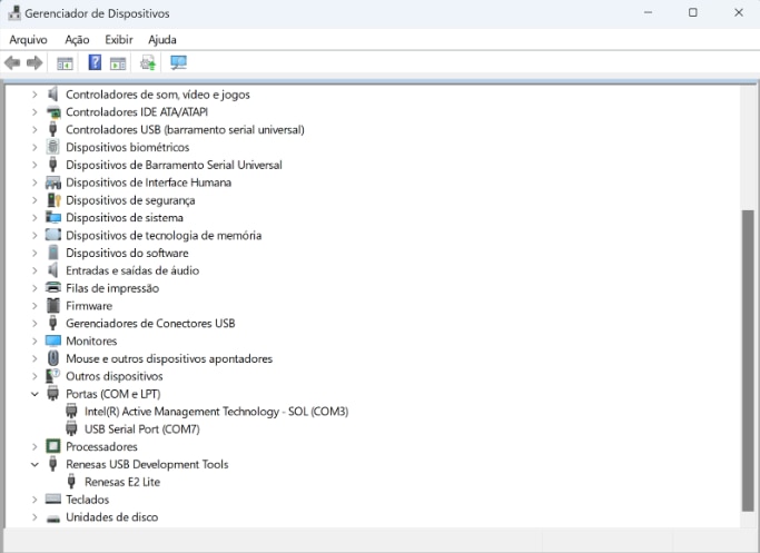

To flash my compiled version of the demo and also enable the debug I must set S4-2 to off to enable the debug port and connect two serial cables on the board:
The debug port enumerate and Renesas USB Development Tools - Renesas E2 Lite on Windows:

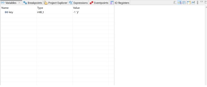

This window shows up when you change the IDE perspective to C++/Debug, the main options to add or remove breakpoints, watch for variables or even the IO Register are available here:
You can add watch some variables:

I also have some problems trying to use Ubuntu 22.04 on my host PC, the e2 Studio was not able to find the compiler and despite my efforts to fix this, I was not able to compile the demo application on a Linux machine, which may also affects the experience for hobbyists and others.
