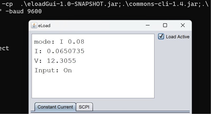

For the efficiency test, I attached a Programmable Electronic Load to the output. I used two DMMs to measure voltage and current. At the input, I also measured the power with two DMMs, just behind the rectifier bridge, where it connects to the bulk capacitor. I used the procedure from P.I. University's Course Notes: Techniques for Measuring Efficiency. This is fairly precise, but doesn't take in account the loss in the protection and full bridge rectifier.
Conditions: mains 230 VAC, 50Hz. Room temperature 20°C.
Board preparation: I cut the trace just after the bridge:
image image
images: where I cut the PCB trace, and how DMMs were wired in place
image: test setup for efficiency measurement
Then I made the programmable load step through all settings, from standby to full load. I let it settle and recorded volts and amperes at input and output.
image: spreadsheet with the measurement
The results are in line with the reference design report:
  • 30 mW stand-by (load disconnected)

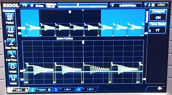

While I was running the exercise, I took some samples of the switch node. Where MOSFET connects to the primary winding. Below you can see my capture of that. Can you spot an occurrence of the on/off output voltage regulation?
image: comparing a capture at the drain of the MOSFET (bottom left) with the Operation at Moderately Heavy Loading (Flyback) signal (bottom right) from AN-98. Schema part taken from RDR-877.

    It's a great, textbook-quality waveform shape to learn from.
  • A capture of two intentional switch artifacts:
    • the clock jitter to spread EMS across a spectrum, making the wave-form "jittery"
    • the on-off regulation mechanism to keep output at 12 V. This causes the glitches in the capture.
    Tested with 240 V, 50 Hz, 250 mA load.
