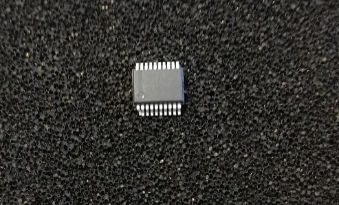

As a version of isolator provided for testing was MAX22565CAAP+ (200Mbps, 5+1 topology - the same as pre-soldered in MAX22565CA), I  had a chance to build MAX22565CA evaluation kit myself.

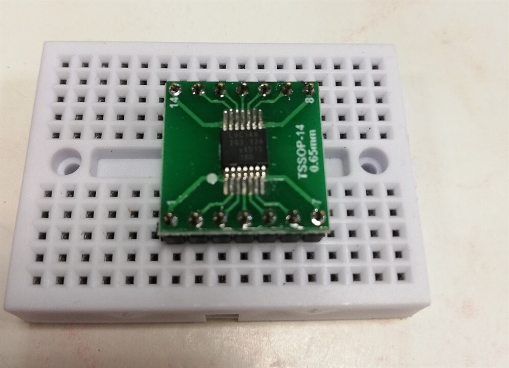

Is it even hand-solderable?
Evaluation kit allows for installation of one of MAX2256x isolators, housed in surface mounted SSOP-20 packages with dimensions as below:
ssop-20

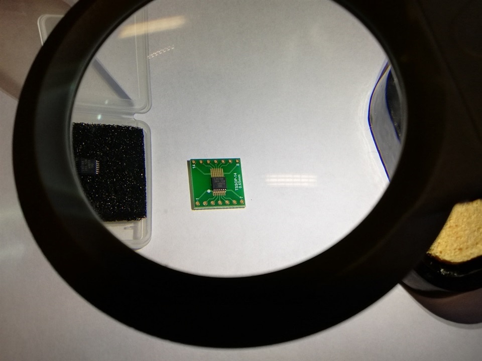

so the question arises if they are at all solderable without a specialized equipment (especially considering distance between pins of 0.65mm). During preparation of test setup, IC in similar (SSOP-14) package was soldered into breakout board that can be bought ready-made from many sources. Photos below detail a process of soldering using a typical, low power soldering iron and magnifying glass (my eyes aren't as good as about twenty years ago):
{gallery}soldering process
IC and PCB
PCB fitting
tinning and removing excess solder
finished
As can be seen, 0.65mm pitch IC can be hand soldered using following steps:
  • PCB should be tinned and flux applied first (it is not given, considering that tinning increase track's height which can make correct positioning more difficult - especially for smaller packages and automatic processes),
  • after correct placement, it is advisable to solder opposite pins at the first step to secure IC in place,
  • excess solder can be removed using desoldering braid,
  • at the end, flux residue can be removed using a flux remover
The same proces was used to populate MAX2256XA kit.

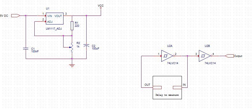

To properly evaluate isolator parameters, test setup was prepared, consisting of:
  • programmable clock generator (SI5351 based),
  • custom daughterboard, piggybacked on J1 and J2 connectors, providing regulated power supply and some measurement circuits.
  • oscilloscope,
  • frequency meter,
block schematics
Custom daughterboard was designed to be fit on the J1 and J2 connectors of the evaluation board, providing power and custom propagation delay measurement circuit.

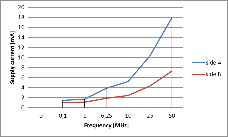

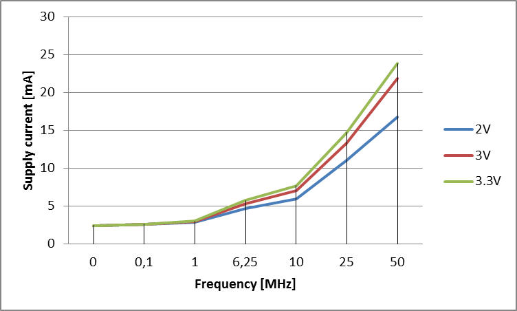

Power consumption
MAX2256X family provides galvanic isolation using capacitive barrier which offers better parameters than optoelectric solution in both speed and power consumption, but - as it propagates information about state changes - needs additional refresh circuit to reliably transfer slow-changing or constant level signals. Such a circuit usually operates at certain frequency and - given the fact that isolator's power consumption changes  with signal speed - usually sets the minimum power consumption of the chip. To evaluate the power consumption, simple test circuit was prepared. Clock generator was programmed to provide signal of the following frequencies: 100kHz, 1MHz, 6.25MHz, 10MHz, 25MHz and 50MHz (switching in the loop) and was connected to five channels in parallel, then total power consumption (for both side A and B) was measured. Resulting consumption curves were as below
Additional curve for 4V was omitted because it was misleading - as we have seen before, our clock generator outputs signal of amplitude slightly decreasing with the frequency, so for 4V there was observable power consumption drop in higher frequencies. That was caused by the fact that input level was similar to the switching threshold of the isolator powered at 4V, resulting in lost cycles and decreased power consumption.
As can be seen from the above graph, power consumption rises with switching frequency and in the 100kHz range is very similar to the idle power consumption, which could indicate that refresh frequency clock is somewhat slower than 100kHz - which is a probable value considering  information from the article from ADI about isolator technologies, where they mention (for different part families) refresh clocks of 1MHz and (after optimization) 17kHz.
MAX2256X datasheet estimates idle power consumption at 0.14mA (input stage) + 0.26mA  (output stage) per channel, which is in line with the measurement, when idle power consumption of the whole (six channel) chip was measured at 2.46mA in the 2-4V supply voltage range.
Similarly, according to the datasheet.  at 3.3V five channels operating at 50MHz should consume 5 * (0.52mA + 0.68mA) and one idle channel 0.4mA, resulting in total consumption of 6.4mA.
As we are measuring not only much greater power consumption, but also different curve shape - more exponential than the expected linear - additional measurement was done, measuring power consumption on both sides separately. Results are as below (side A is an input and side B - output):
instead of the expected (from the datasheet)
power consumption curves from datasheet
My hypothesis is that it is caused by the less than ideal input signal shape - we have observed that at higher frequencies our input signal is more triangle than square shaped, so if there is no Schmitt circuit at the input of the isolator (and I didn't find detailed enough description of the inner structure of the chip to verify it), CMOS circuits are known to consume excessive power during slow transition between L and H states, where both transistors can be in (more or less) conducting state at the same time, so that's can be explanation of excessive power draw.

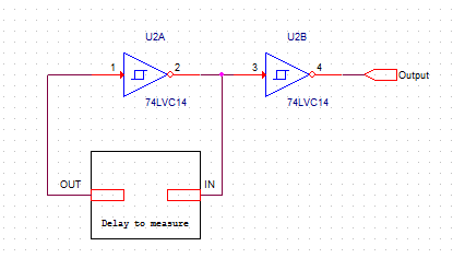

Propagation delay
Another interesting parameter is propagation delay and it's skew between channels (that - if excessive - can lead to data errors/race conditions). To measure it, indirect measurement method was used. Using Schmitt-trigger inverter, frequency generator was built and measured delay was put into feedback loop. This way, output frequency was dependent on the sum of two delays: propagation delay of the inverter and measured delay.
generator circuit
Two different inverters were used: standard 74HC14 and high speed 74LVC14. First, propagation delay of the gate and cable of the length similar to the length of connectors needed was measured as a reference.
At 3.3V, 74HC14 used in test was capable of generating 60MHz signal, and 74LVC - 104MHz. Then, frequencies generated when different channels of the isolator was put in the loop were measured:
Measurement results are as in the following table - first for 74HC14 chip, then 74LVC14 (with frequency measured using frequency meter first [mean value of three samples], then using DSO - last series).

Obtained results were calculated using following formula:
First, propagation delay of the inverter was calculated from the free-running frequency.
Then, total delay of the generator containing measured channel was calculated, from which, after subtracting the inverter delay, estimated channel delay was obtained.
As we can see, results are very good and generally in line with datasheet, which is stating typical propagation delay of 7 ns (at 3V - 3.6V power supply range) with the maximum value of 11 ns - we have measured 8-9 ns.
