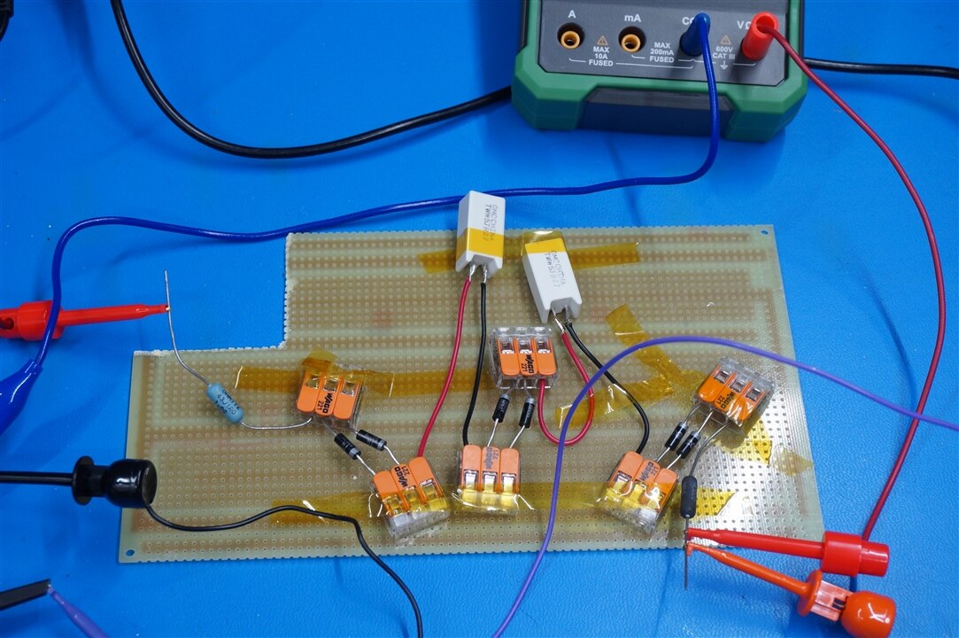

b. Zener Diode Load
I used 3.5V/5W Zener diodes (Onsemi 1N5333B) as emulated lighting LEDs for the PWR efficiency measurement.  The emulated high current LED lighting subject is presented at Figure 8.
Zener Diode Load
Figure 8. Zener Diode Load for Power Efficiency Measurement

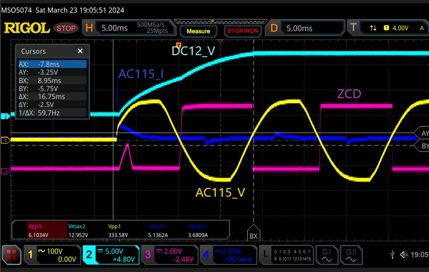

3.2 RDK-877 Soft-start Check
Soft-start can gradual turn on of an electronic power supply to avoid stressing the components by the sudden current or voltage surges associated with initially charging capacitors and transformers. Soft-start also make the overall system more safe and reliable. P.I. LinkSwitch-TNZ family ICs do provide such features for better power supply performance.
Case01: 3% load from cold start
Here is one snapshot under 3% load for illustration of the surging signal from AC115V line while power-on RDR-877 board. RDR-877 has not been powered over 12 hours before this start-up.
3%load_startup
Figure 11.   RDK-877 Start-up at 3% Load
The soft start-up time is around 11ms, which is longer than 256 cycles of 33kHz which is defined at Ref[3] datasheet for LNK3306D switching clock. The surging AC115V line current can be up to 2~3 A.
ZCD signal looks stablelized after the first cycle of AC115V line from this snapshot.
