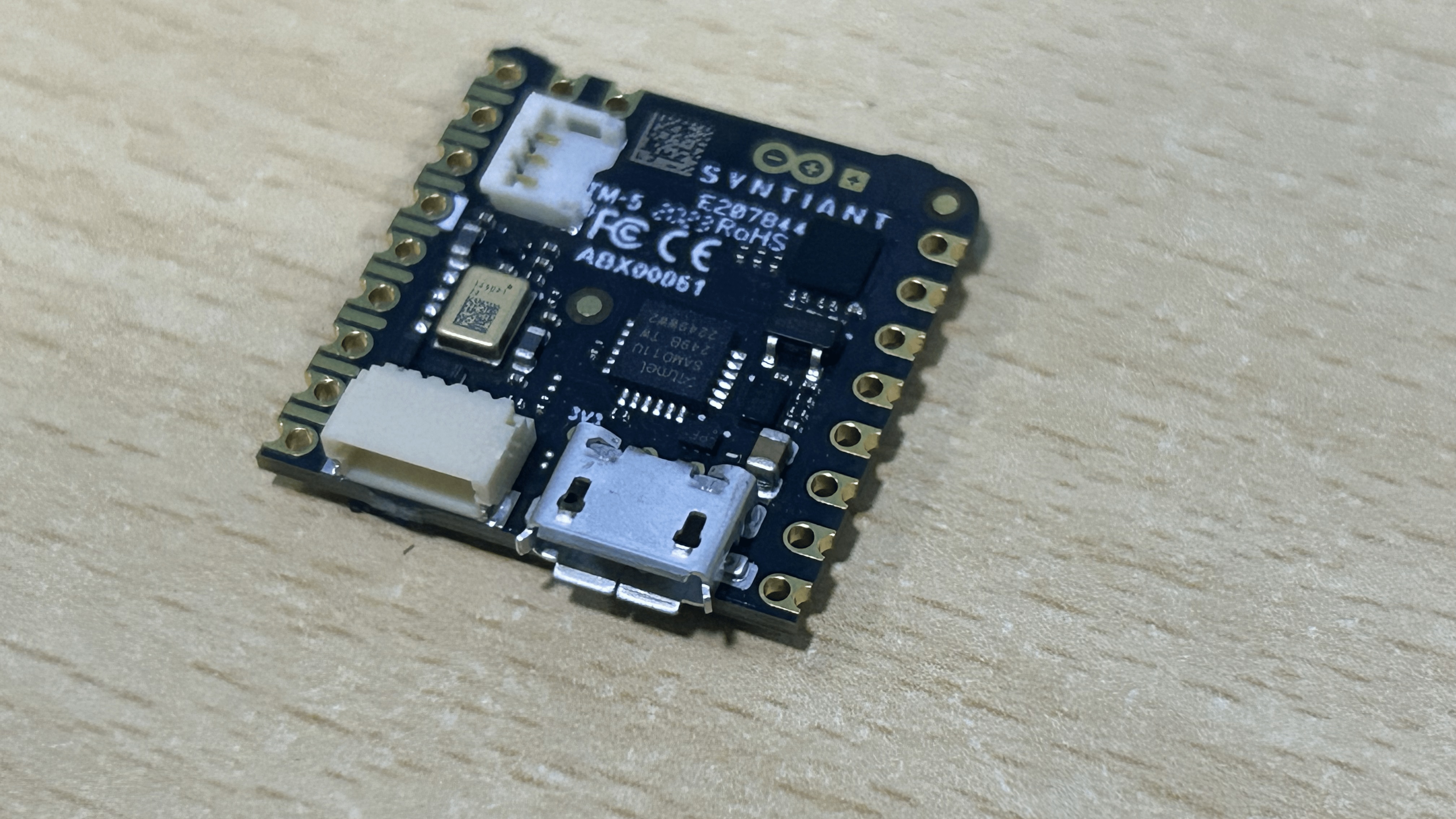

The Arduino Nicla Voice is a tiny powerhouse, packing speech and motion recognition into a compact 22.86mm x 22.86mm board. Let's dive into what this board offers and how it performs.
Unboxing & First Impression
The Nicla Voice arrives in a small, professional package. Inside, the board is well-protected and comes with a brief getting-started guide. The board itself is impressive; small yet well-built, with clean soldering and clear labelling.
Hardware Overview and Software
The heart of the Nicla Voice is the Syntiant NDP120 Neural Decision Processor. This chip allows for efficient on-device machine-learning tasks. The board also boasts a microphone, a 6-axis motion sensor, a magnetometer, and Bluetooth Low-Energy (BLE) connectivity. The Arduino IDE provides libraries and examples to get you started quickly.

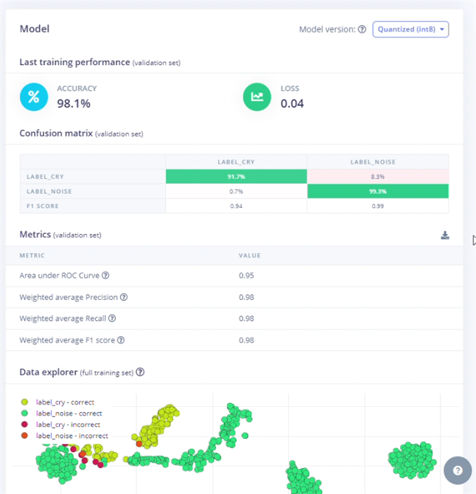

Project: Audio Classification with Edge Impulse Training
We built a simple project using Edge Impulse to classify cry sounds and noises.
Edge Impulse is a fantastic platform for training machine learning models on the Nicla Voice. The user interface is intuitive, and pre-built libraries for audio classification and keyword spotting make it easy to start. Uploading the trained model to the board is a smooth process.
The process was straightforward, and the Nicla Voice performed admirably, accurately identifying the sounds with minimal training data.
