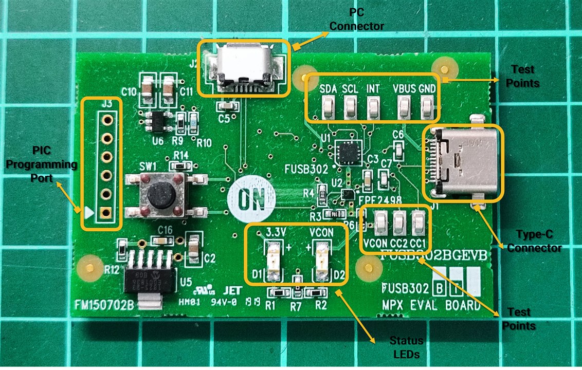

Top View

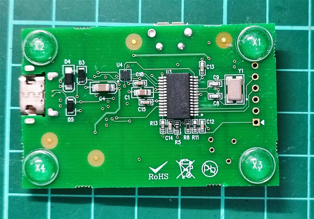

Bottom View

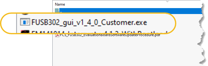

Now let's get started using the device. Before that, we need to download and install the ON Semiconductor FUSB302 Control Software. The software can be downloaded using this link. You need to create an account to be able to download the software. Once the software is downloaded, unzip it.
Inside the folder, we can see that there are 4 different files. The one which we are interested is the FUSB302_gui_v1_4_0_Customer.exe. Double click and a new window will pop up.

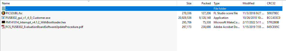

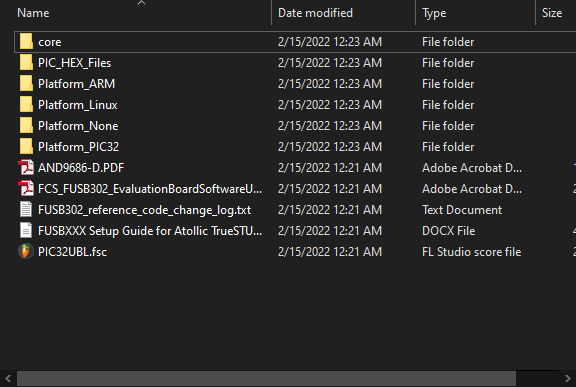

Once the download is completed, unzip the file and open the folder. Inside the folder, there will be files as shown in the figure below
Open the Adobe file as shown in figure below
Inside this Adobe file, it is clearly stated the steps to update the firmware. I have recorded a video on the process.

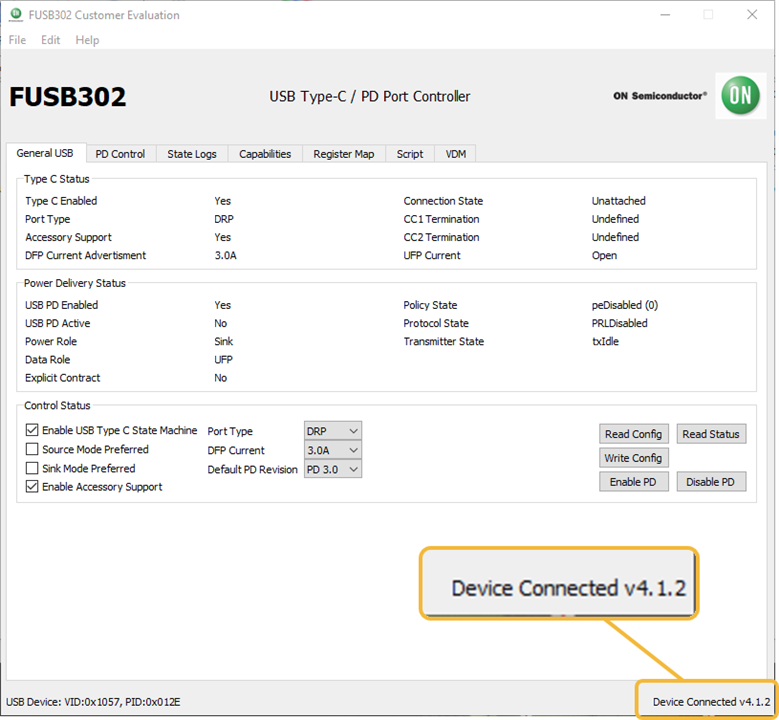

Later i noticed that in the GUI folder which i downloaded earlier has the file that is needed to update the firmware. Once the firmware is updated you will notice that at the bottom right corner, it will show that the device is connected as shown in the figure below
Now the device is ready to be configured.

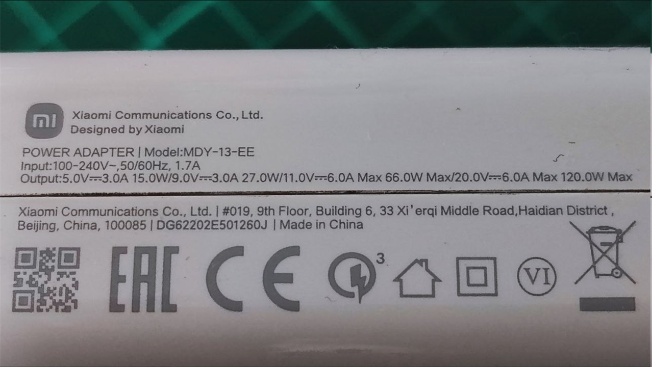

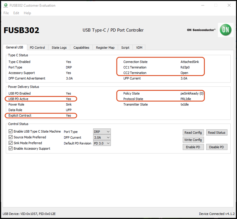

For the first part, i would like to plug in my phone charger to the USB-C port and monitor the changes that will be shown in the GUI. The phone charger that i am using is as shown in the figure below

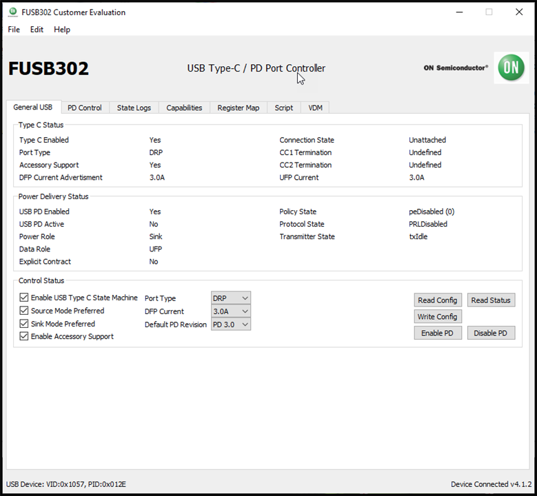

Once i connected my phone charger to the FUSB302BGEVB, this is what i can see in GUI.
The figure below is the GUI window for "General USB" before and after i connect my charger.
Before Connecting the Phone Charger After Connecting the Phone Charger
In the video below I have explained the things that I observe.
