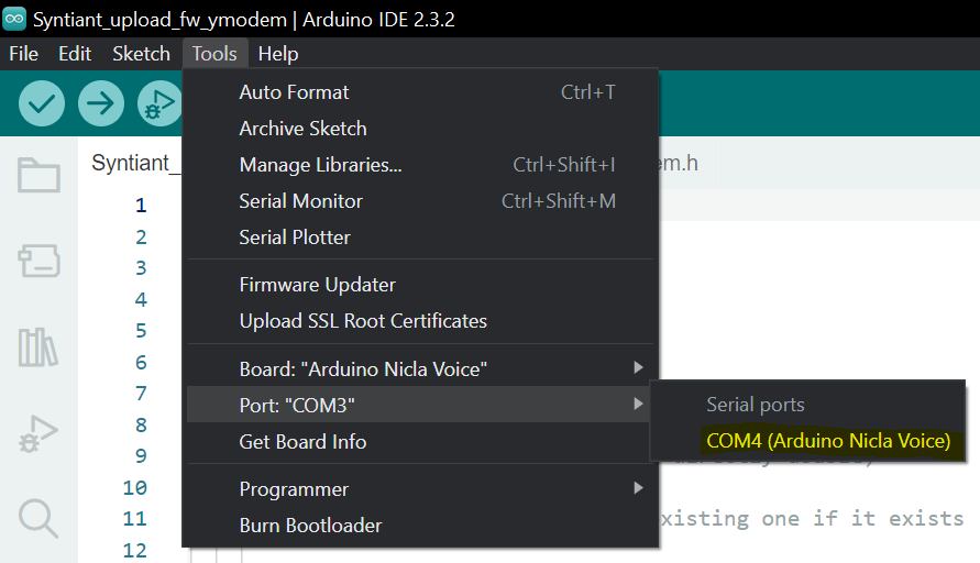

The first part is to load the uploader to the board from Arduino IDE.
To upload it I've selected the board and port in Arduino IDE.

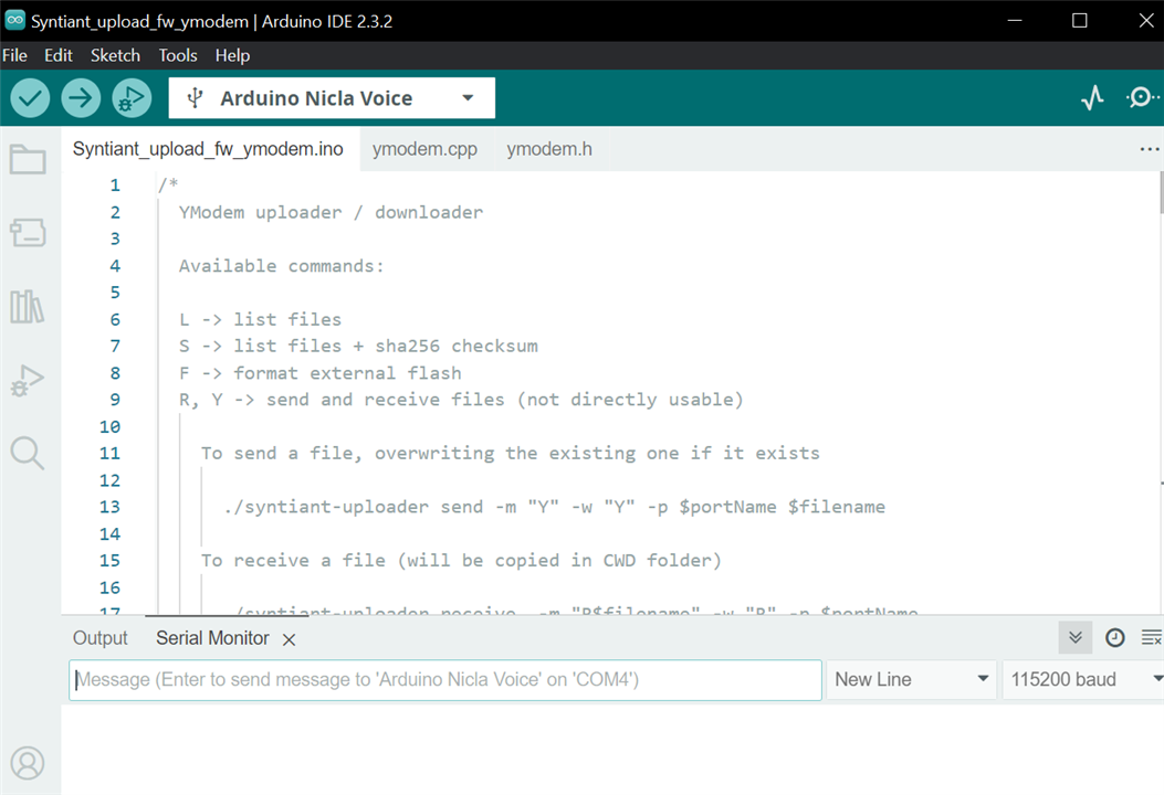

And then run the Syntiant_upload_fw_ymodem sketch.
The second part of the firmware update requires clearing memory on the board using Arduino IDE Serial Monitor. The default speed of the Serial Monitor is 9600 bod. As it was not clearly documented I was not able to complete the task. After some research, I found that the board requires a specific speed. So it is important to select the communication speed 115200 baud. I've typed "F" in the Serial Monitor and it cleared the board memory.

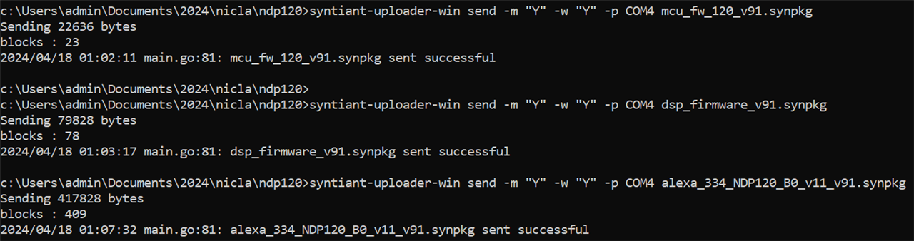

The last part requires to download and extract binaries of the firmware from Arduino documentation site . The uploader should be executed from the command line. I've run it from my Windows PC, so the command is specific to Windows OS.
syntiant-uploader-win send -m "Y" -w "Y" -p COM4 mcu_fw_120_v91.synpkg
syntiant-uploader-win send -m "Y" -w "Y" -p COM4 dsp_firmware_v91.synpkg
syntiant-uploader-win send -m "Y" -w "Y" -p COM4 alexa_334_NDP120_B0_v11_v91.synpkg
I've run into a few issues. First I've got the "Access is denied" error.
The error was caused by Arduino IDE using the same port. I've closed the IDE and was able to communicate with the board.
The next issue was an intermittent NAK error from the board.
It only happened to me when the board got connected to the PC over USB. On the second try, it was able to complete without errors.
It is important to verify that the upload is completed with a "sent successful" message. I got an error one time when it failed to upload the large model file.
It took 68 seconds to upload the model file for the Alexa keyword. I've used ptime utility to measure it.

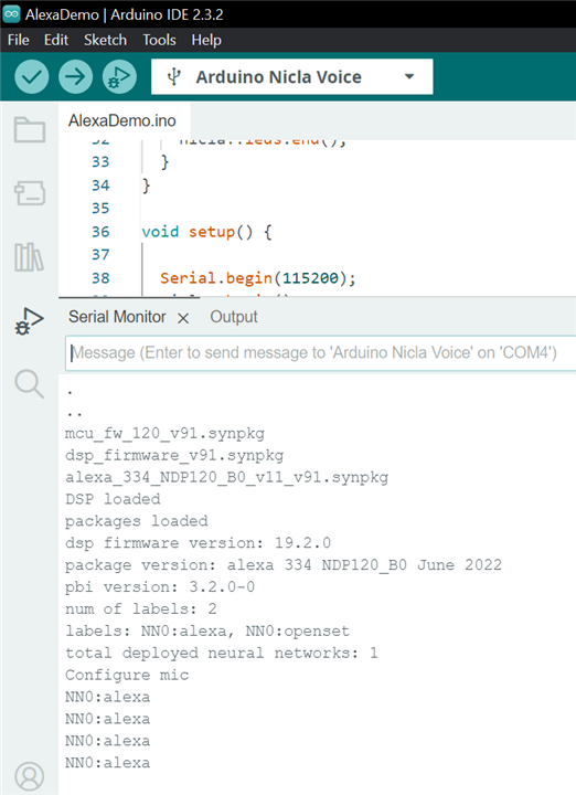

After the firmware was uploaded I used the uploader sketch to review the list of the uploaded files. Again I used the Serial Monitor and typed "L" and got the list of the uploaded files.
Always-On Speech Recognition (ASR)
I've used the AlexaDemo sketch provided as an example to verify its ASR capabilities. The sketch blinks with the blue LED and adds an entry in the serial log every time it hears the word Alexa.
I was impressed with the speed and quality of the keyword recognition. It was able to recognize the keyword almost immediately.

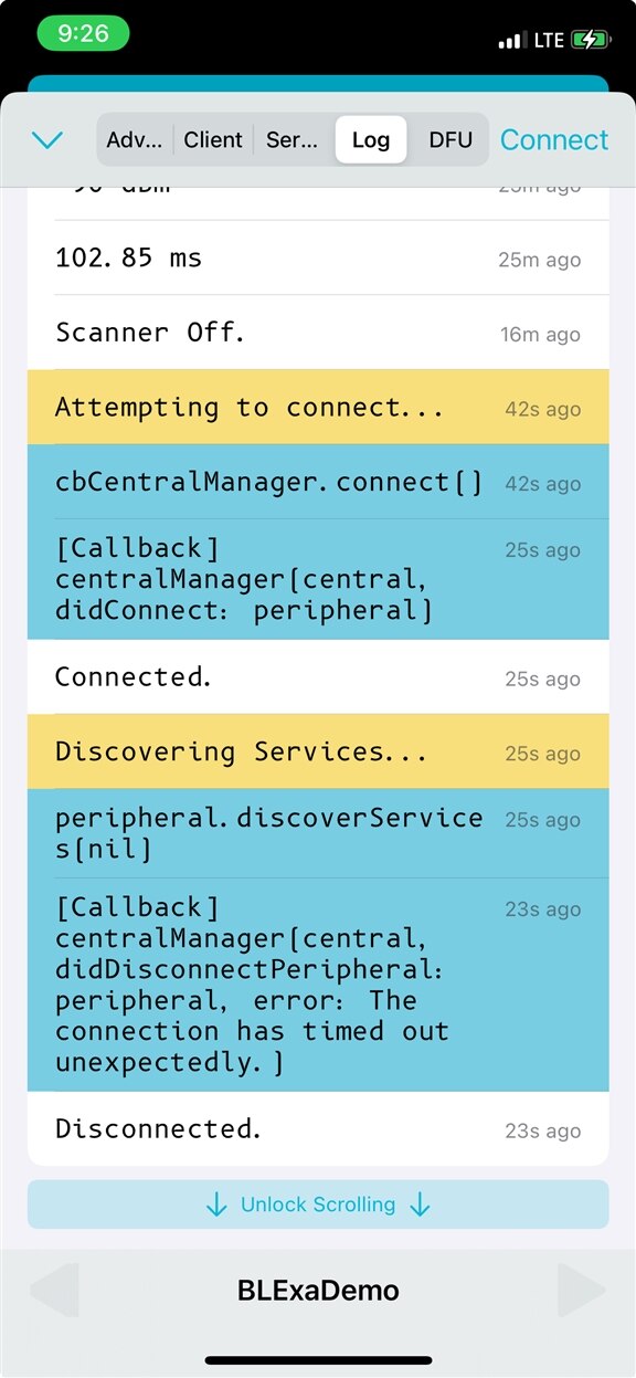

Then I used the nRF connect app on iOS and Android to test communication with the Nicla Voice board and its ANNA B112-00B  stand-alone Bluetooth 5.0 low energy module.
The app was able to detect the board.

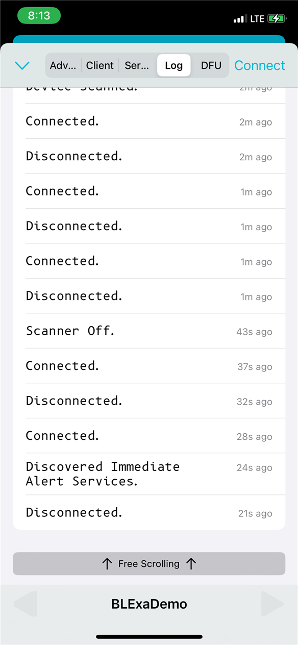

Unfortunately, it fails to establish a reliable connection.
It disconnects almost immediately after creating the connection.
The error message says that The connection has timed out unexpectedly.
I was able to connect only once for a long period of time, so I was able to verify that the board was sending alerts, I found similar observations not only for the Nicla Voice board but for other Nicla boards as well.
