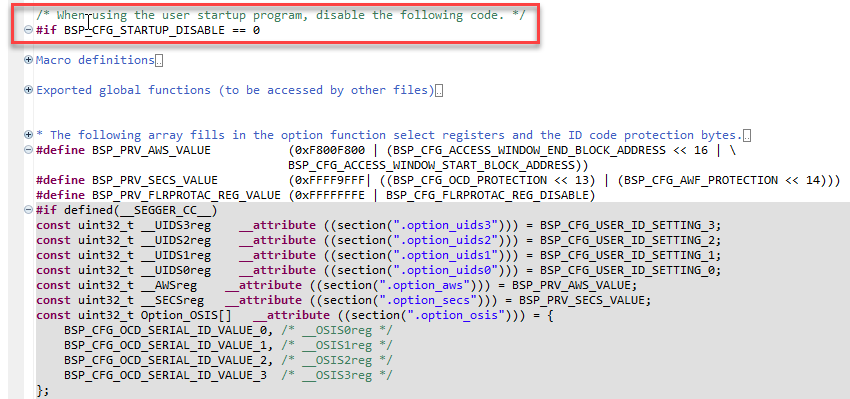

While browsing the tool, I found an interesting option about the Startup code selection. I changed it to “Disable”. I thought it allowed the startup code of Embedded Studio instead.
After generating the code, I built it and flashed it. Of course, the code did not work as I intended.
The real problem was that I could not connect jLInk anymore after a reset. It was a surprise, as there was no warning with this option. I could not find the root cause, but it might be related to the security ID related to the debug option. But it’s not quite ordinary compared to my experience with other MCUs. I tried to use the serial bootloader for flashing, but it declined further operations with an error message. I looked up the FAQ and manuals, but the effort was unsuccessful.

    the BSP startup code includes option memory configuration bytes where among other MCU system relevant things, the IDCODE is stored. This is an authentication password for the programming interface, and the Jtag connection. Typically you would care of this only for last steps before production.
    so when you disable the tool's BSP, you would have to allocate that yourself, in your code.
    Default setting is 0xFF as for unprogrammed flash, but if you miss to include that reserved structure in your own BSP, you risk bricking the device.
    Good feedback about the warning when disabling the BSP. Please note that all supported IDEs are defining the ".option_osis" section, and the linker script makes space for it, but it's missing some way toa catch-all structure which always defines such section in flash, to avoid missing it.
    As for your problem, if you have still the original unmodified image you flashed, you could try the following: inspect the hex file and check for the 0x800 to 0x80F content (this is the OSIS area, see hw manual).
    If you are lucky and the first bit (OSIS bit 127) is by chance not zero, you can use that content to authenticate to the board either with Renesas flash programmer (see FPB manual for proper jumper settings) or in the e2studio debug settings (if SECS.OCDDI is also not zero).
    Then you might be able to erase the chip. In e2studio try downlaod the standard blinky w/o modifications.
    If bit 127 of OCDDIS is 0, then bad luck - the programming interface is locked down, unfortunately.
    As mentioned, those settings are normally used in production so during development you can safely ignore them, but the OSIS pitfall shall be highlighted more or get a better 'safety net' when the user disables the BSP.
