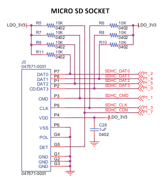

 The Analog Devices MAX32666FTHR has MicroSD card, which can be used for storage of data by sensors and can be used as data acquisition. The Analog Devices MAX32666FTHR has inbuilt accelerometer and gyrometer BMI160. This ADI MAX32666FTHR has also inbuilt bluetooth antenna which helps in developing medical IoT devices and the inbuilt suport of libraries can be used to get heart rate, steps, acceleration etc, though this will need more coding (which might not be easy for all) but ADI has developed libraries which looks like  80% work accomplished but to make it fully work and data transfer using Rx/Tx or SPI or I2C is not an easy task (unless the fundamentals of ADI microcontroller are  clear). The inbuilt features of bluetooth, RTOS and lithium battery charger are specially impressive as with the support of libraries, it was easy to put add on in projects but to achieve more proper outcome, coding is not straightforward.

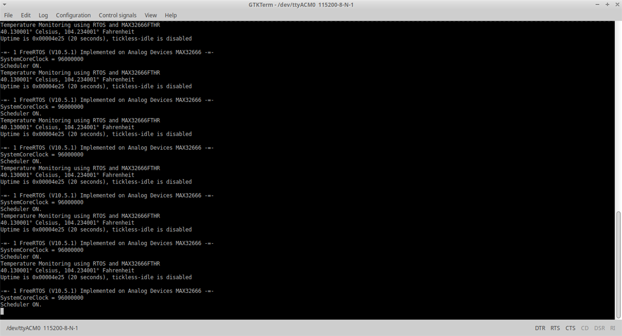

  8. Project 4 : Implementing Real-Time Operating System on Analog Devices MAX32666FTHR

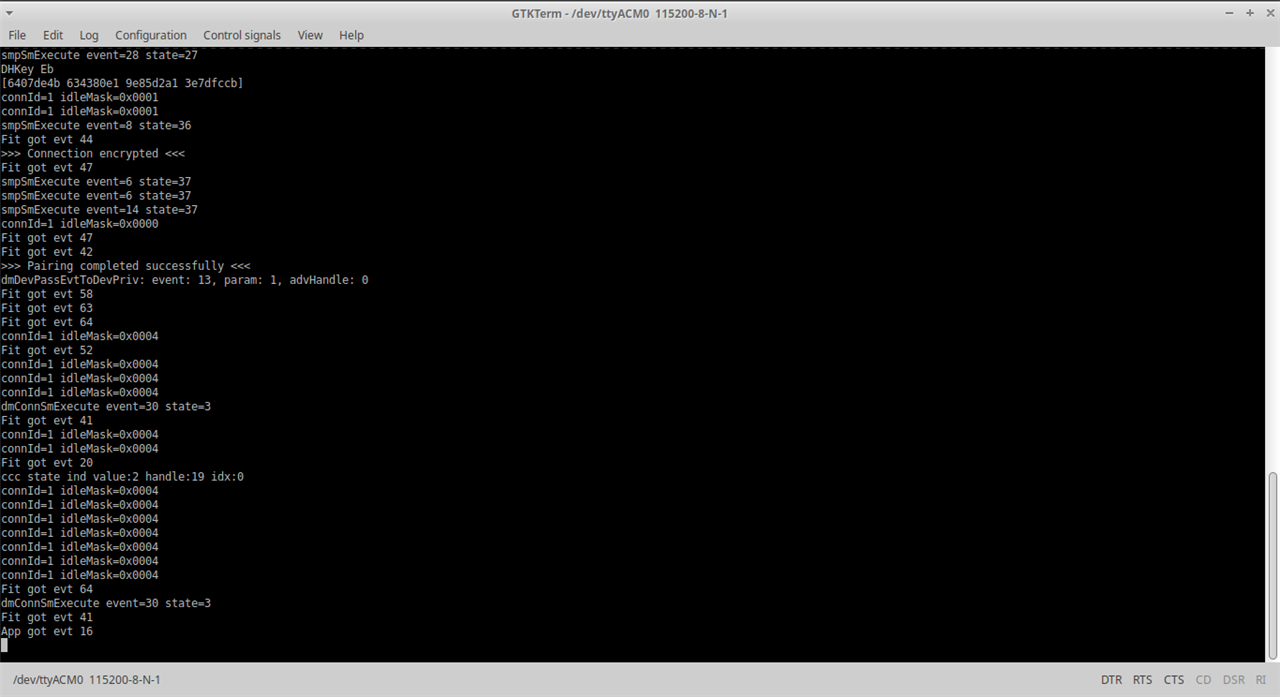

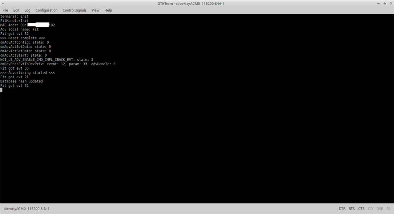

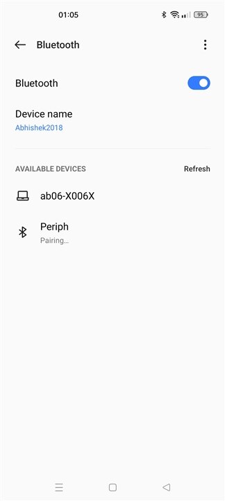

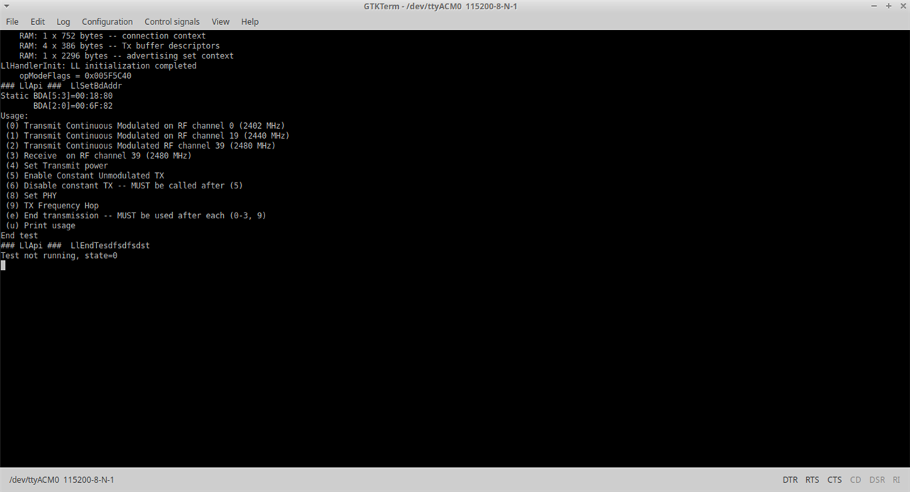

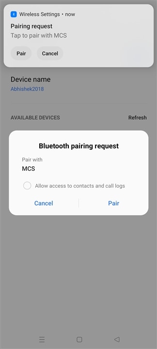

  12. Project 8 : Testing Codes On Inbuilt Bluetooth Surface Mount Antenna of ADI MAX32666FTHR (Successfully Paired with Android Mobile)

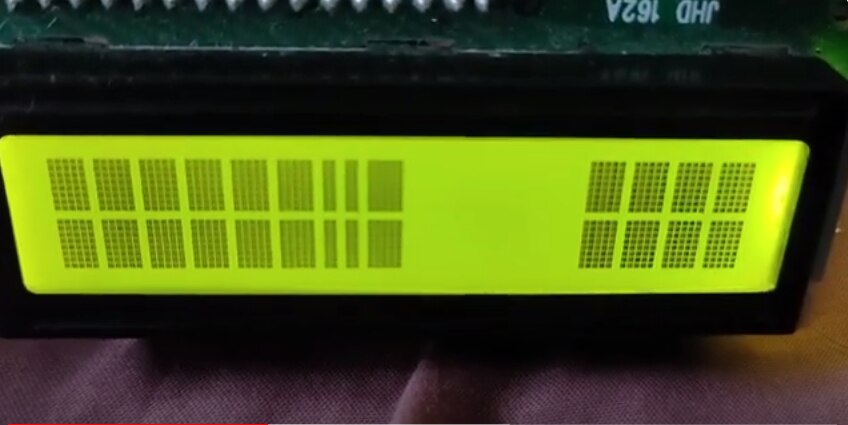

  15. Project 11 : 16x2 LCD on Analog Devices MAX32666
  16. Project 12 : Testing Inbuilt SD Card of ADI MAX32666FTHR

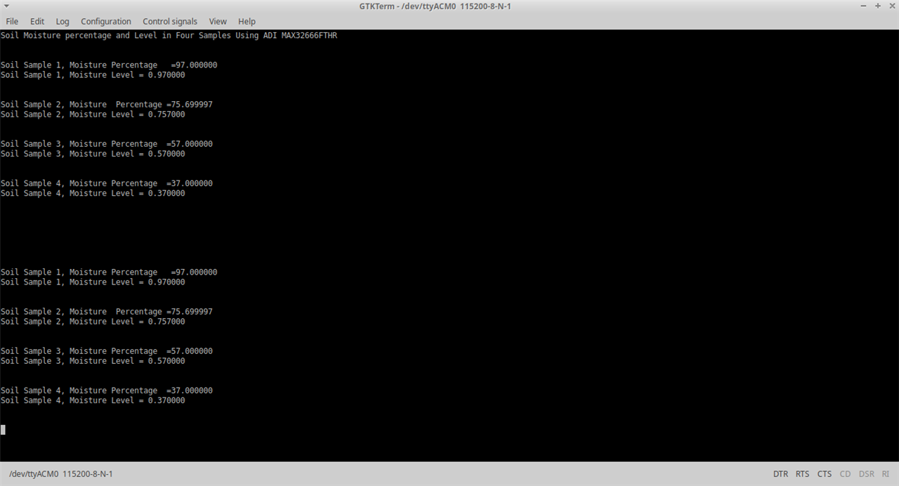

  18. Project 14 : Soil Moisture Percentage and Level in Four Soil Samples Using ADI MAX32666FTHR

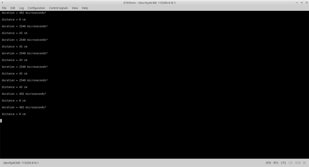

  19. Project 15 :  Interfacing HC-SR04 with ADI MAX32666FTHR

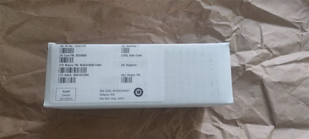

1. Unboxing
{gallery}Unboxing ADI MAX32666FTHR
IMAGE TITLE: THEN IMAGE DESCRIPTION

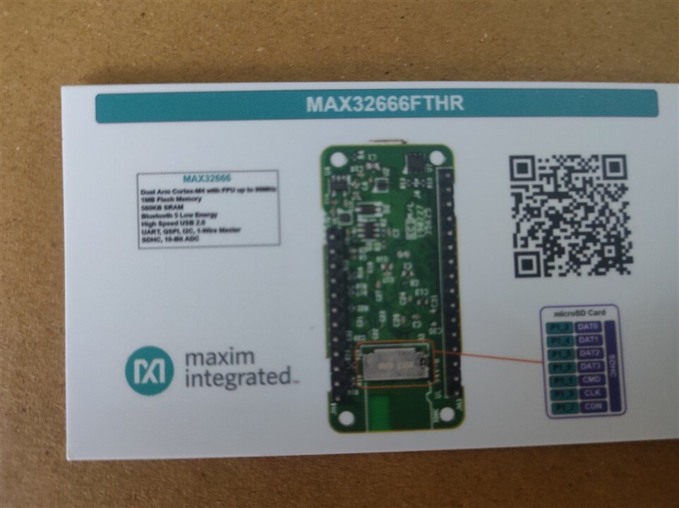

Following contents and items are given in the kit

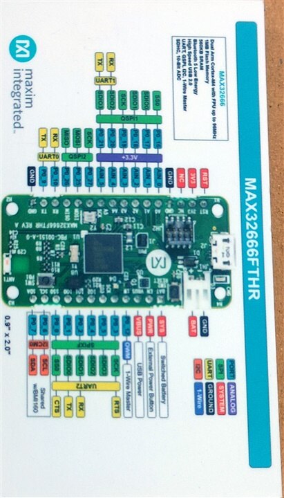

1. MAX32666FTHR Board (this is evaluation board) with pin-outs description in small visiting card size

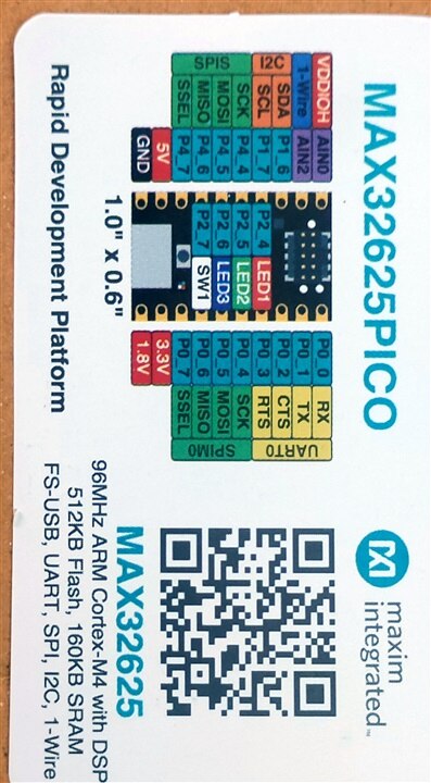

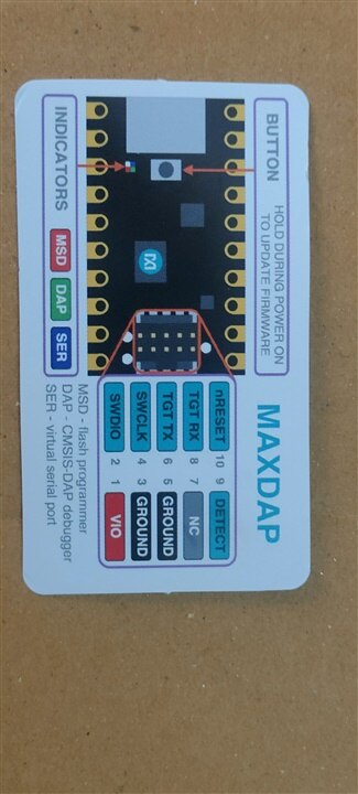

2. MAX32625PICO (this is a debugger) with pin-outs description in small visiting card size
3. Two header pins - 12 pin and 16 pin
4. Two cables USB cables of different sizes but both are USB-A to Micro-B cable
5. One cable, 10- pin 2x5, 1.27mm IDC (insulation-displacement contact), this is a Flat Ribbon Cable
2. Understanding Evaluation Boards
There are two boards in the box, one is MAX32666FTHR and the other is MAX32625PICO. The  MAX32625PICO board will be connected with ribbon cable as it is needed to program the evaluation board MAX32666FTHR.

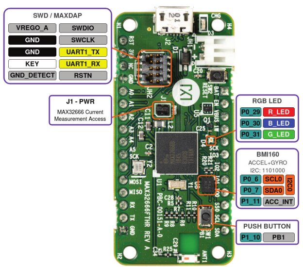

2.1 MAX32666FTHR

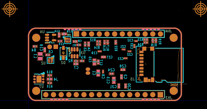

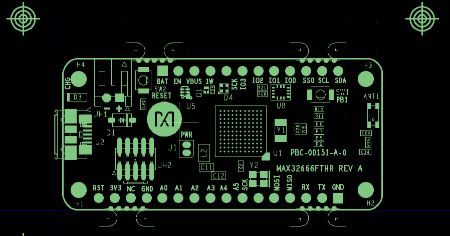

1) MAX32666FTHR Board
{gallery}max32666fth
MAX32666FTHR Top Side Components
Source: MAX32666FTHR Application Platform (319-100525; Rev 0; 3/20)
MAX32666FTHR Pinout Diagram
MAX32666FTHR Bottom Side Components

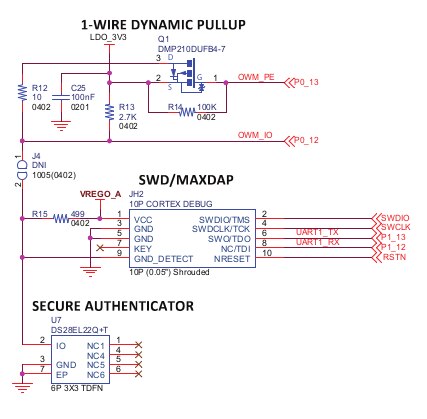

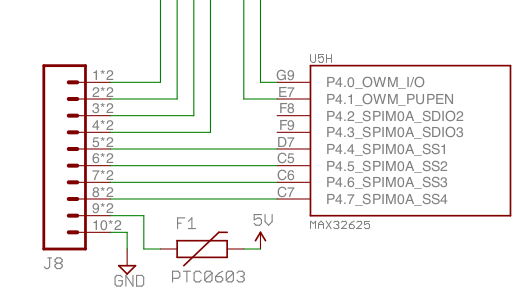

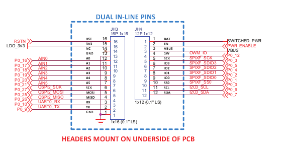

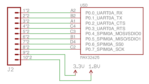

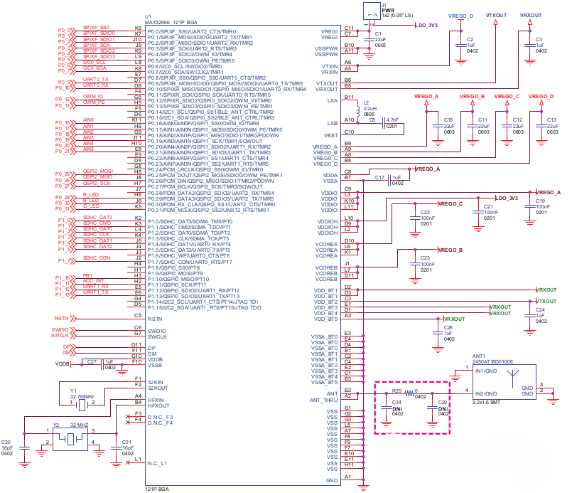

2) MAX32666FTHR Schematic
{gallery}MAX32666FTHR Schematic

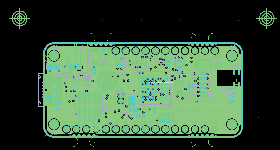

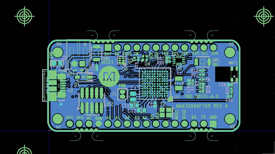

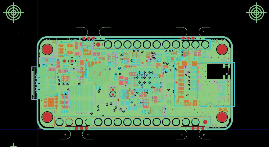

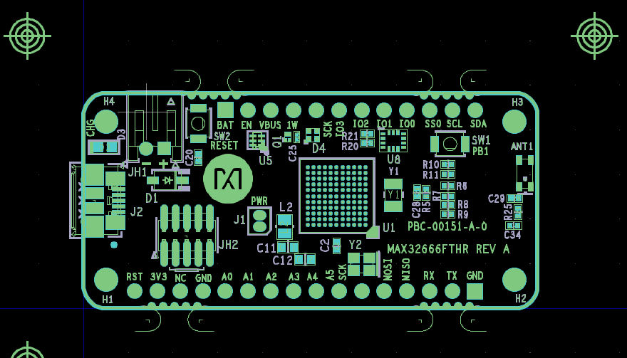

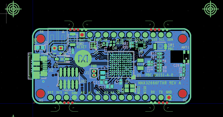

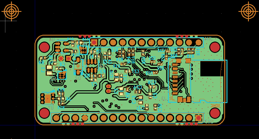

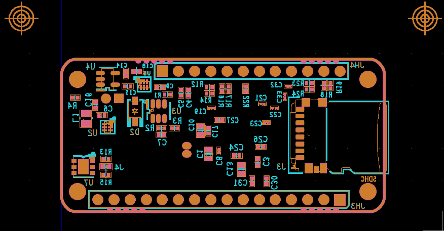

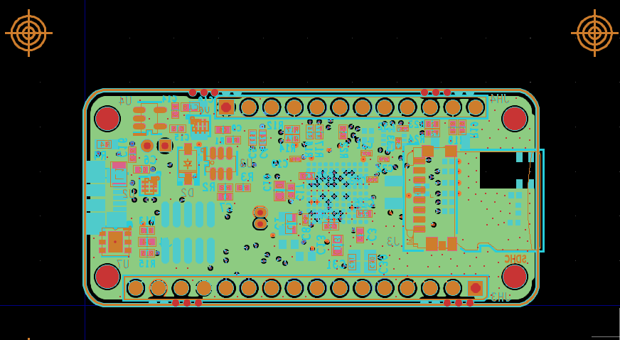

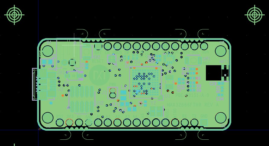

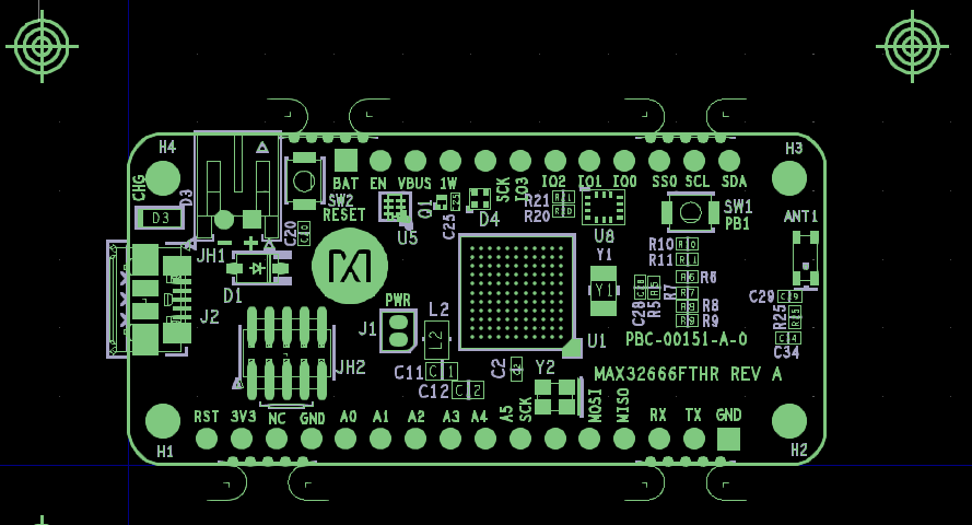

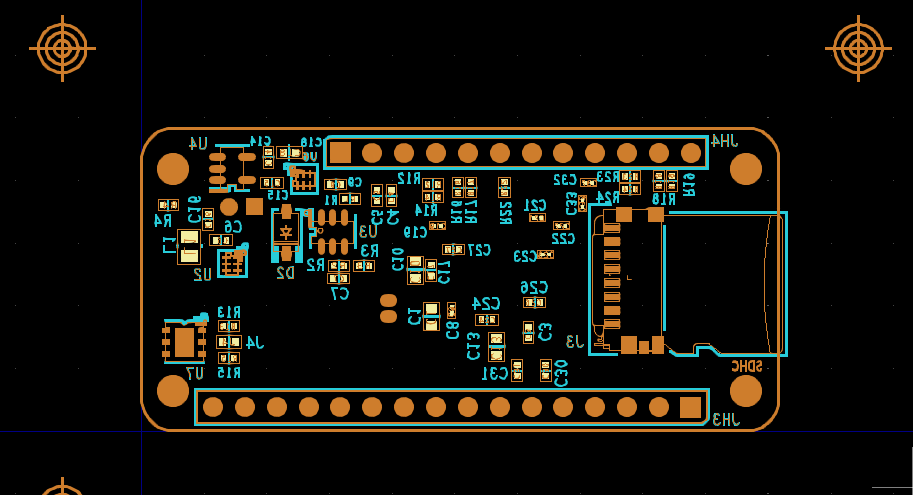

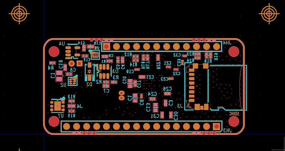

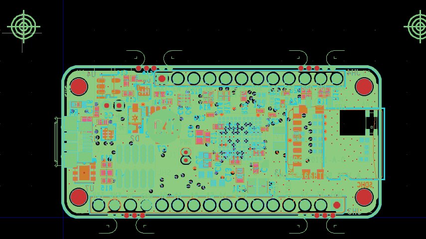

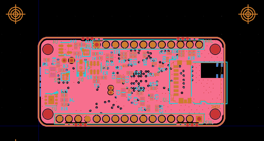

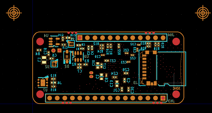

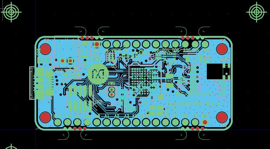

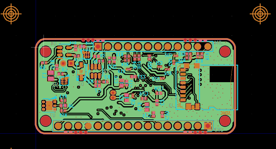

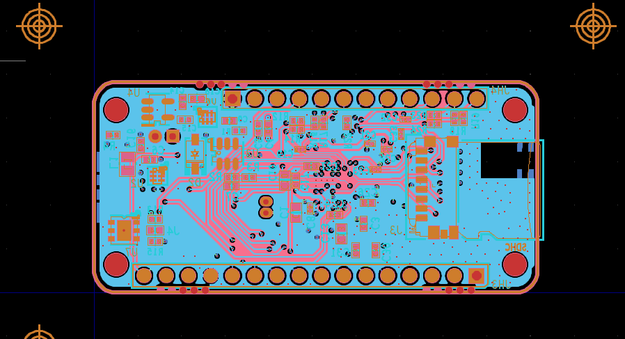

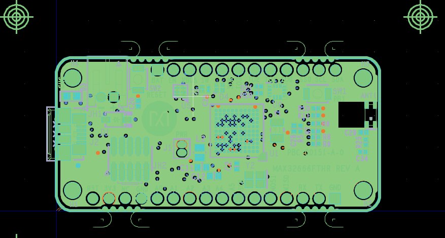

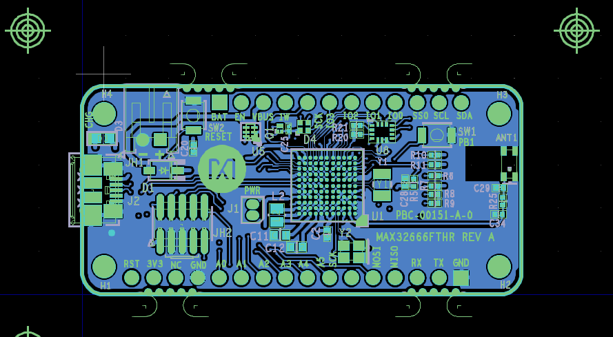

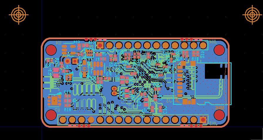

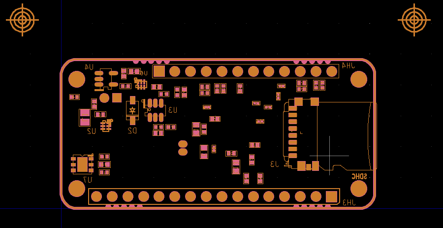

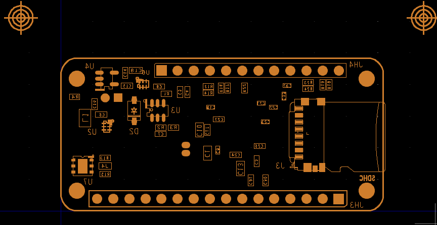

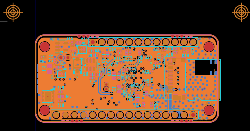

3) MAX32666FTHR Gerber
{gallery}MAX32666FTHRGerber

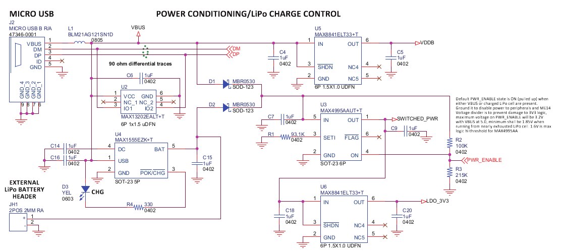

4) MAX32666FTHR Board Voltages
5) MAX32666FTHR Lithium Ion Battery charger
2.2 MAX32625PICO

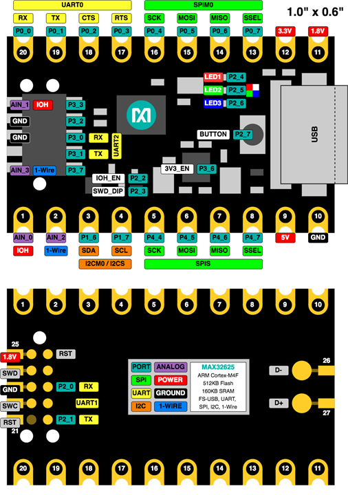

1) MAX32625PICO Board Pinout
Source : MAX32625PICO Application Platform

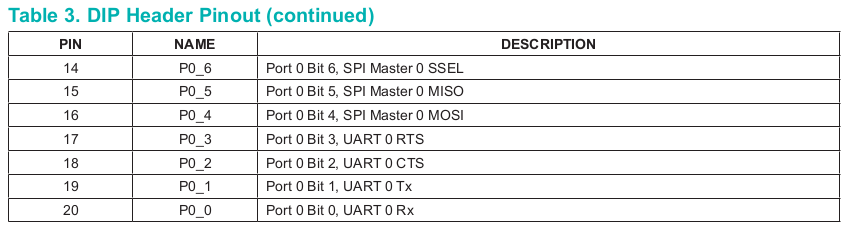

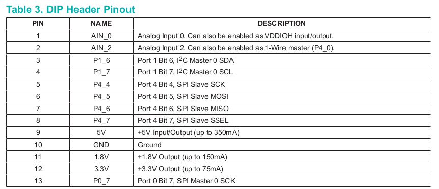

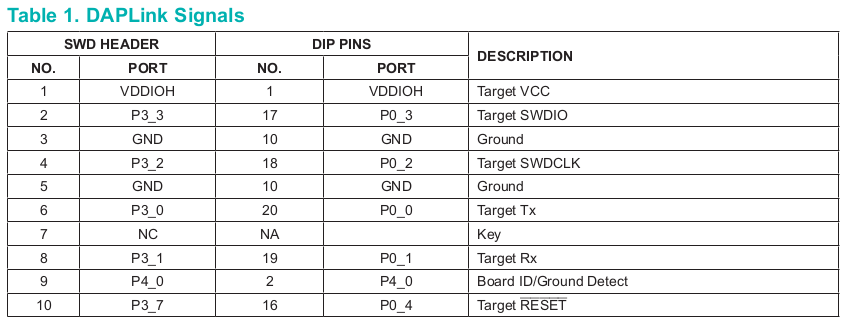

2) MAX32625PICO Pin Descriptions
Following tables are all from datasheet
{gallery}MAX32625PICO Application Platform

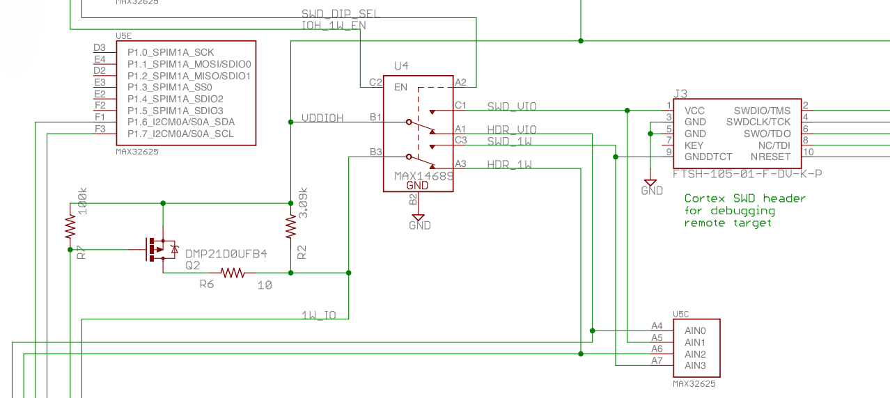

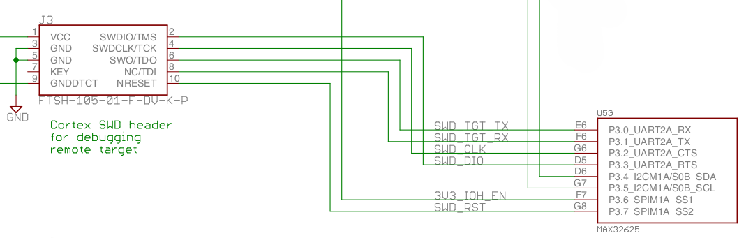

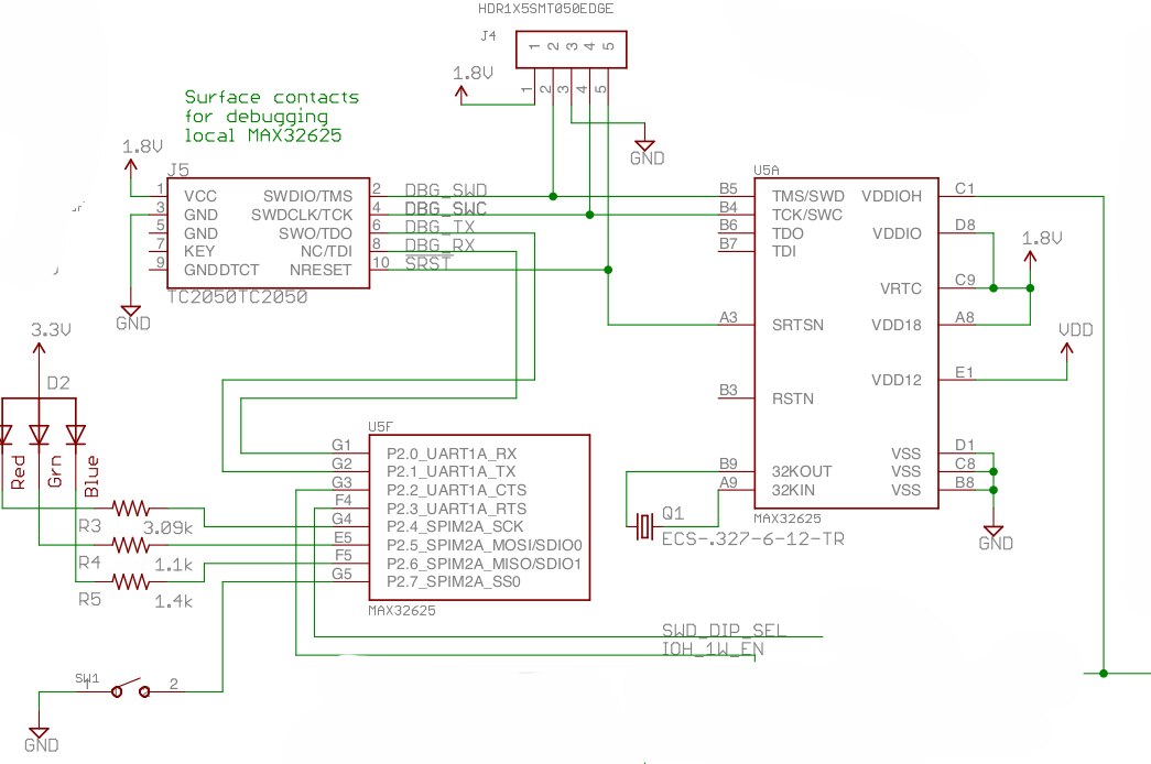

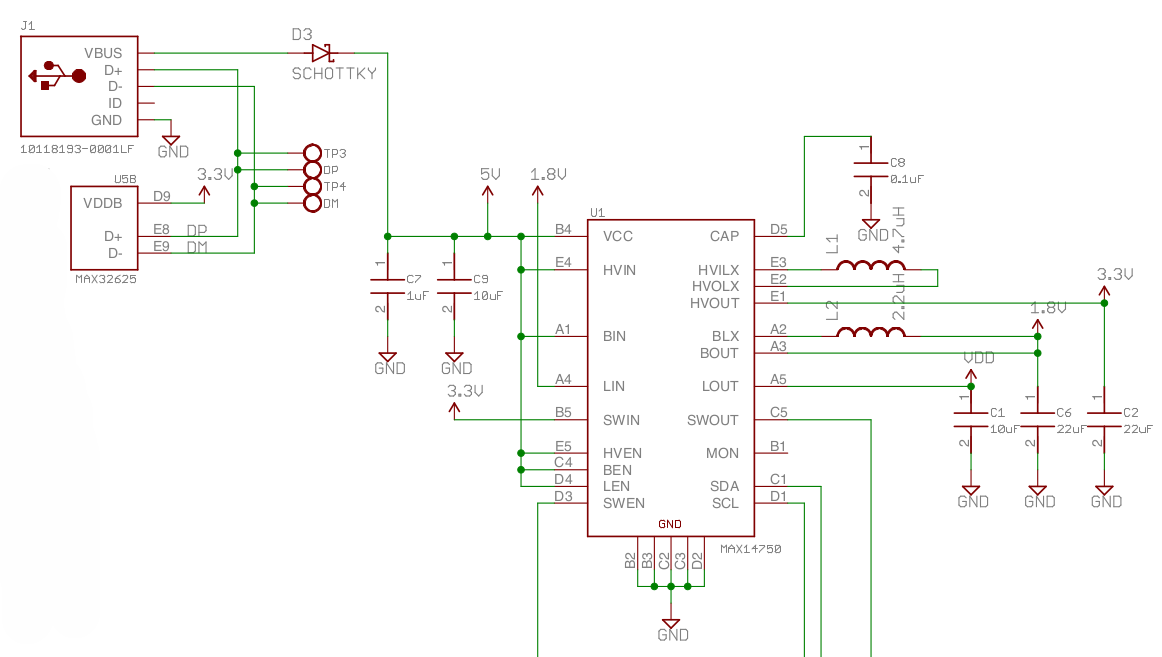

3) MAX32625PICO Schematic
{gallery}MAX32625PICO Schematic

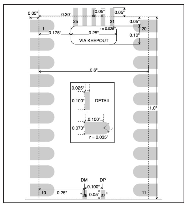

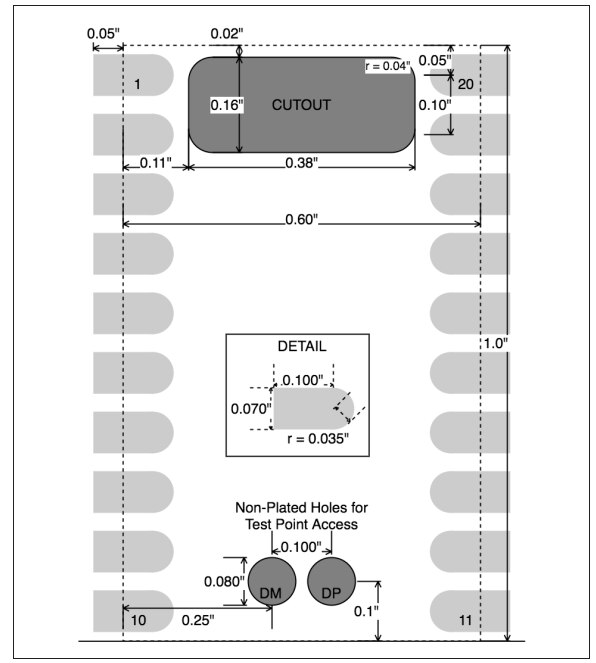

4) MAX32625PICO Footprints
{gallery}MAX32625PICO Footprints

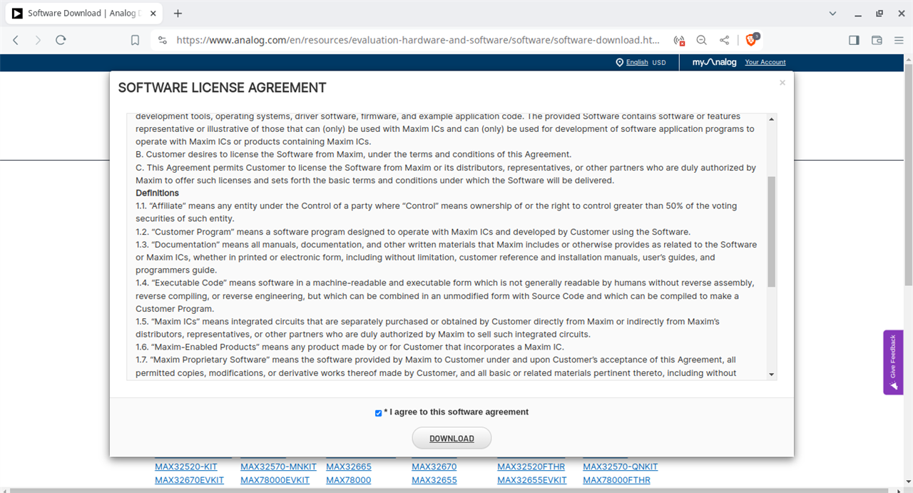

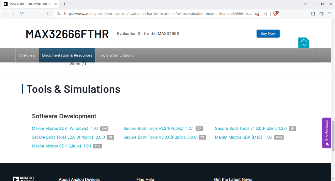

3. Installation SDK
3.1 Downloading the Software

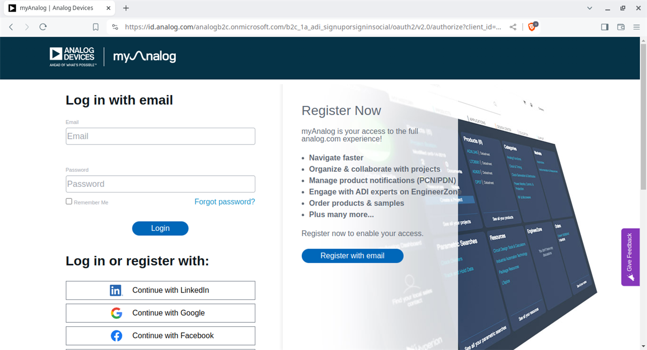

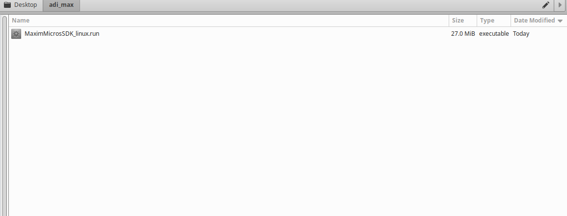

To download software, pls click and go here, and then scroll to 'Tools & Simulations', and choose correct sofware 'Maxim Micros SDK (Windows), 1.0.1', according to operating system
          • Maxim Micros SDK (Windows), 1.0.1 EXE  -- for Windows
          • Maxim Micros SDK (Mac), 1.0.1 DMG  --  for MAC
          • Maxim Micros SDK (Linux), 1.0.1 RUN  -- for Linux/Ubuntu
It will ask login/registration as in the image gallery
{gallery}ADI sw Installation

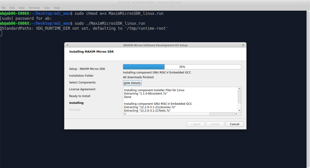

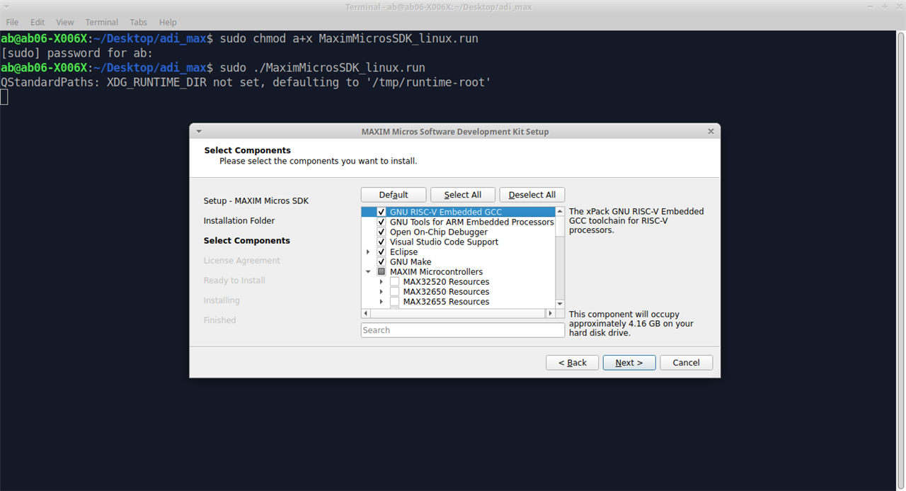

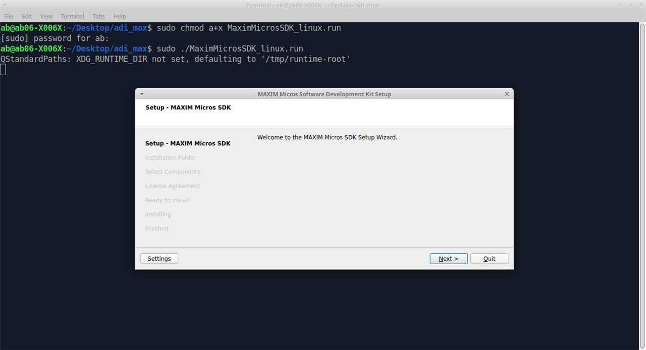

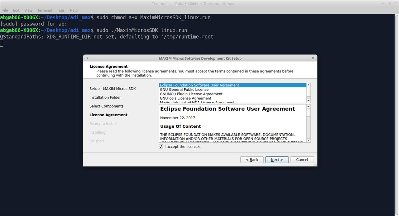

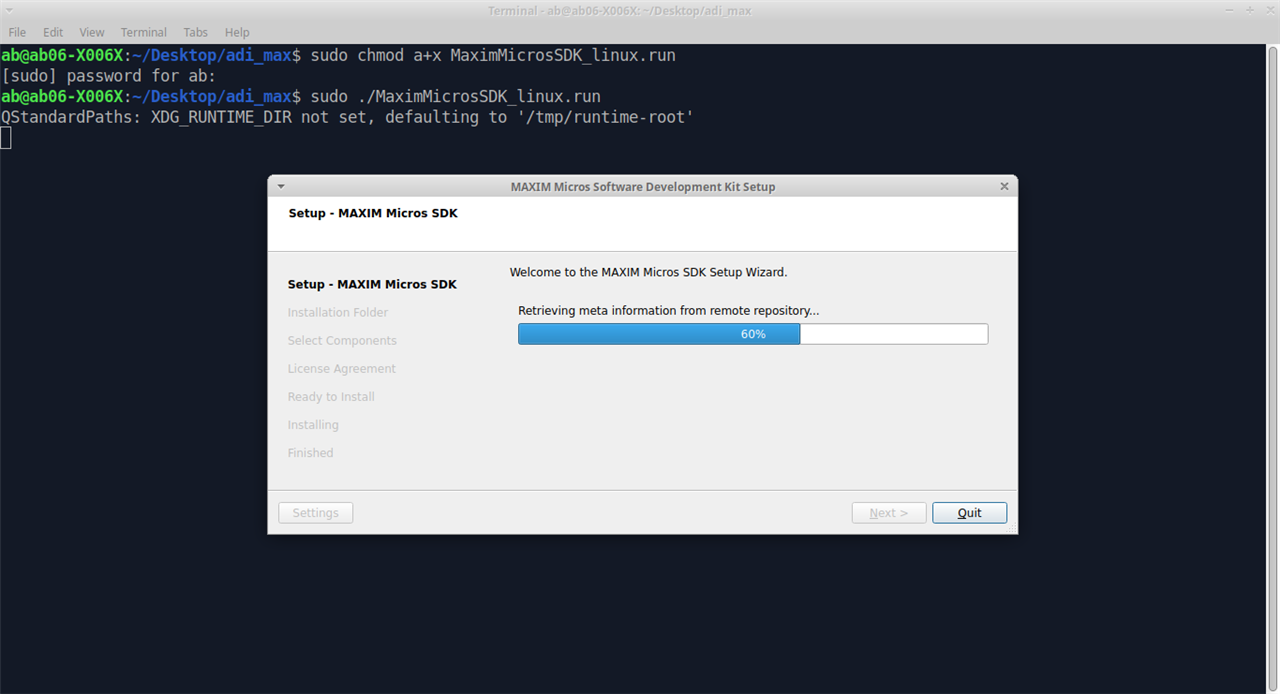

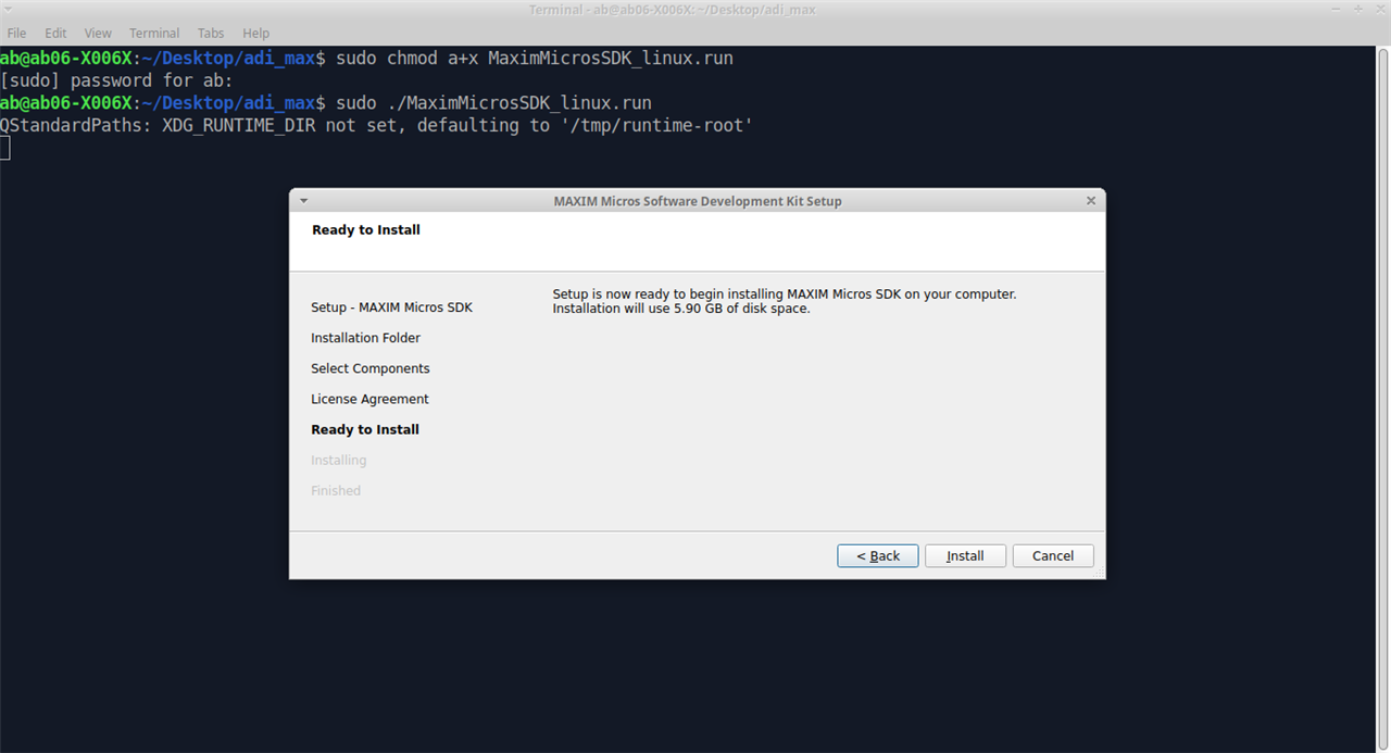

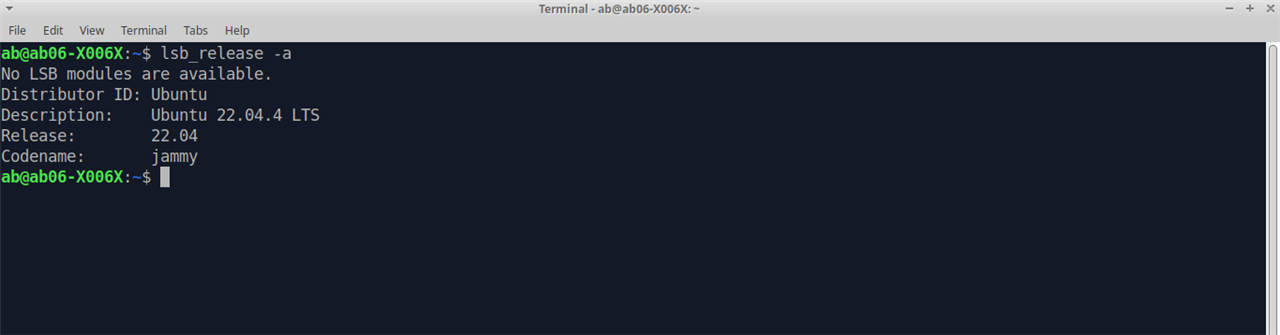

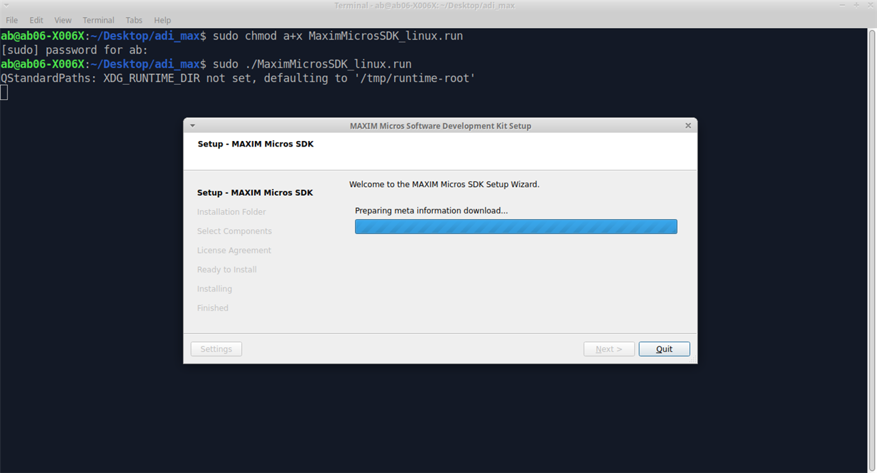

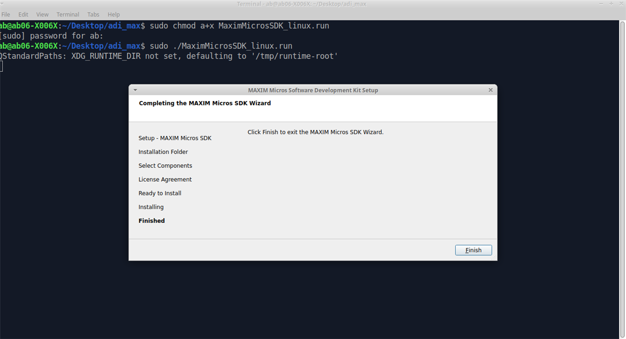

3.2 Installation of the Software on Ubuntu
{gallery} Installation of the Software on Ubuntu

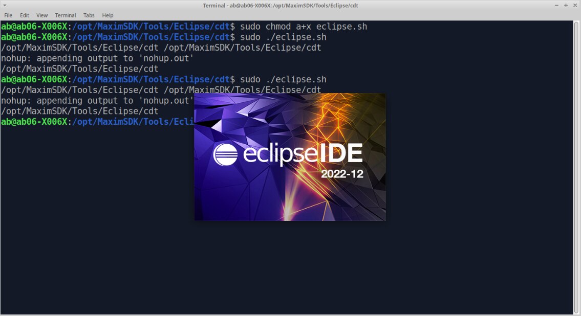

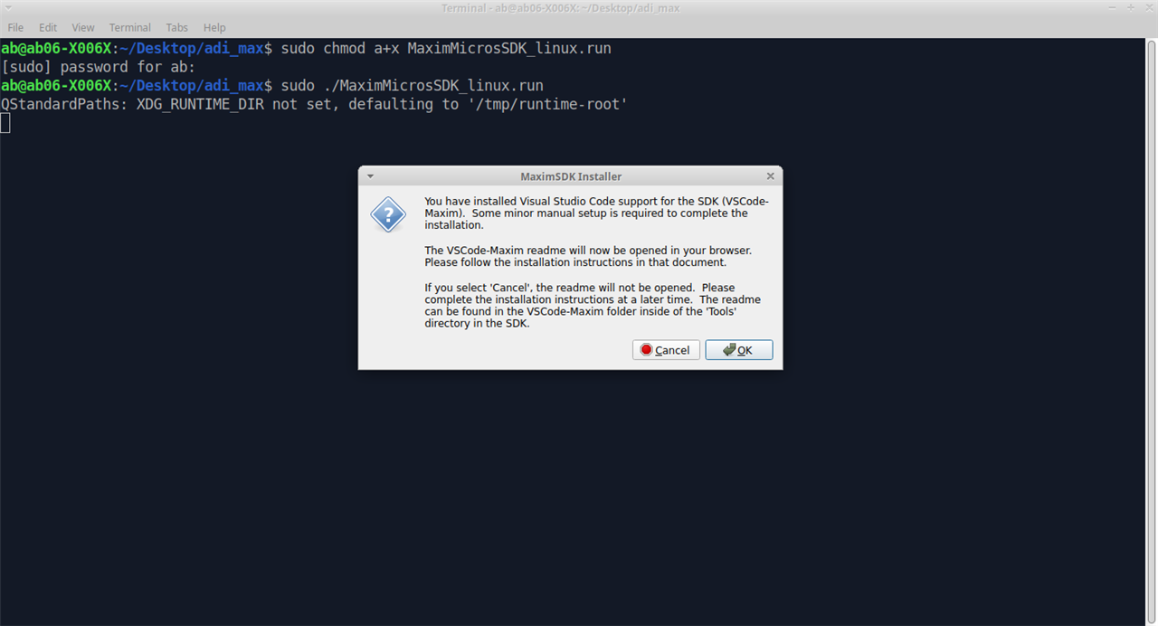

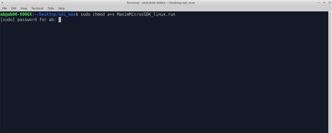

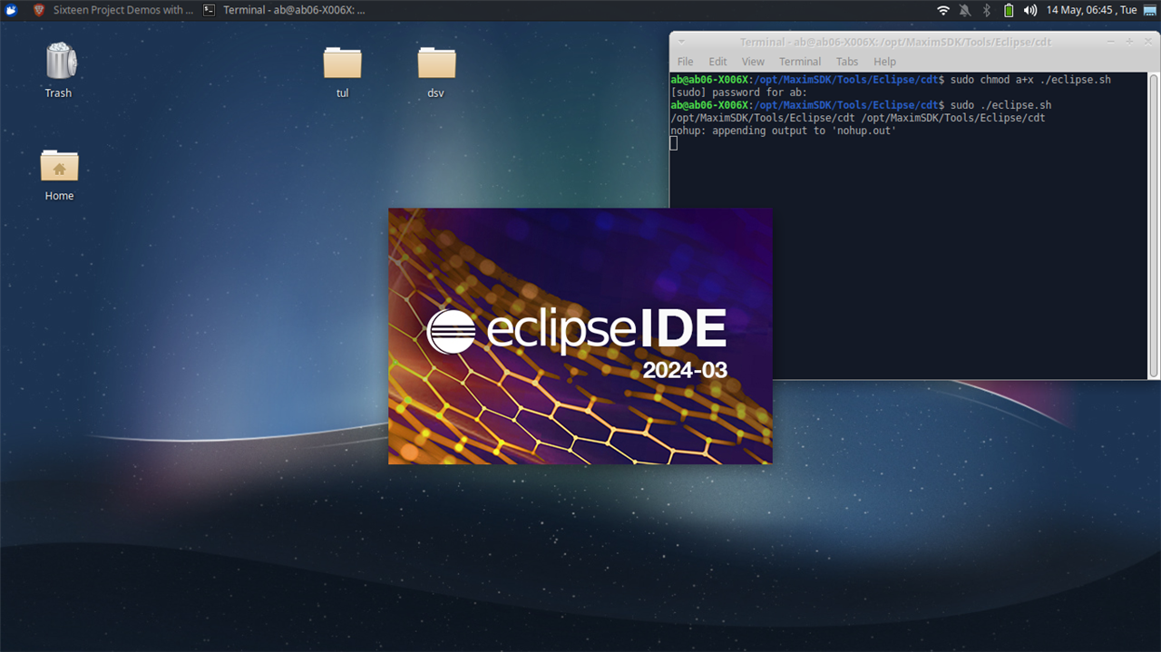

3.3 Opening The Eclipse MaximSDK
sudo chmod a+x eclipse.sh
sudo ./eclipse.sh

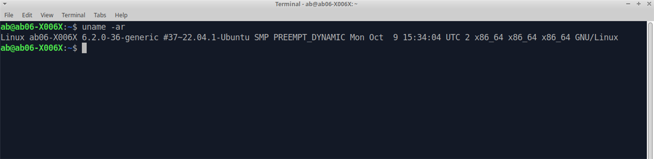

This, I have upgraded to

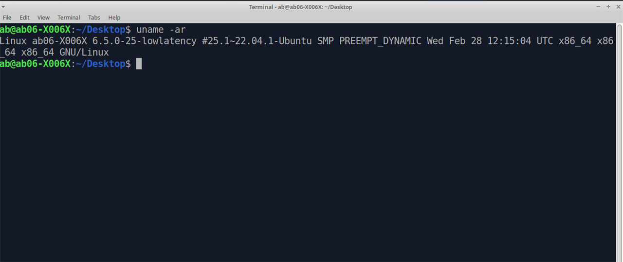

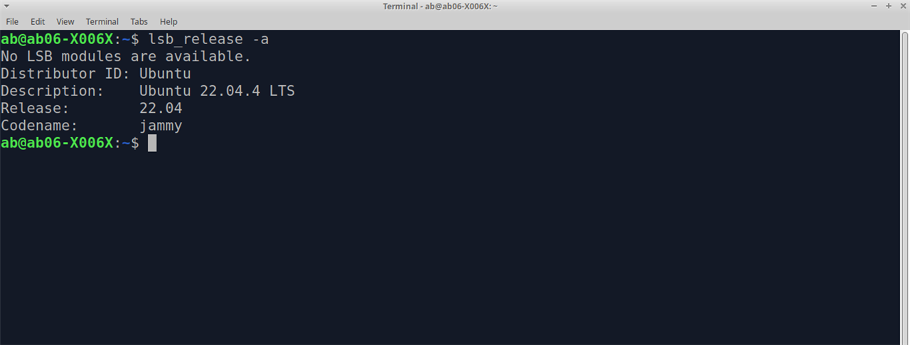

3.4 I have updated Linux Kernel from 6.2(generic) to 6.5 (Low latency)

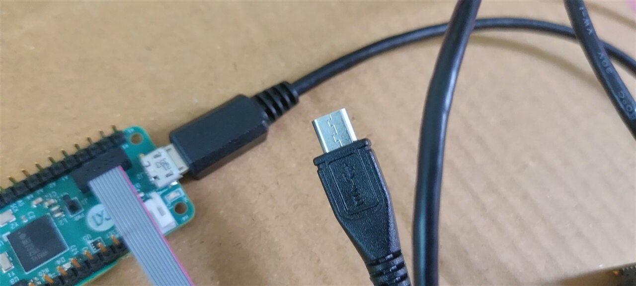

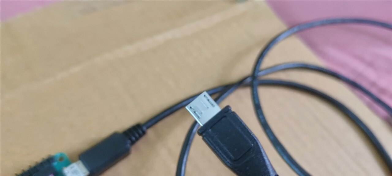

2) The two cables USB-A to Micro-B has one side flat and one side round, the flat side is to be above
{gallery}USBa

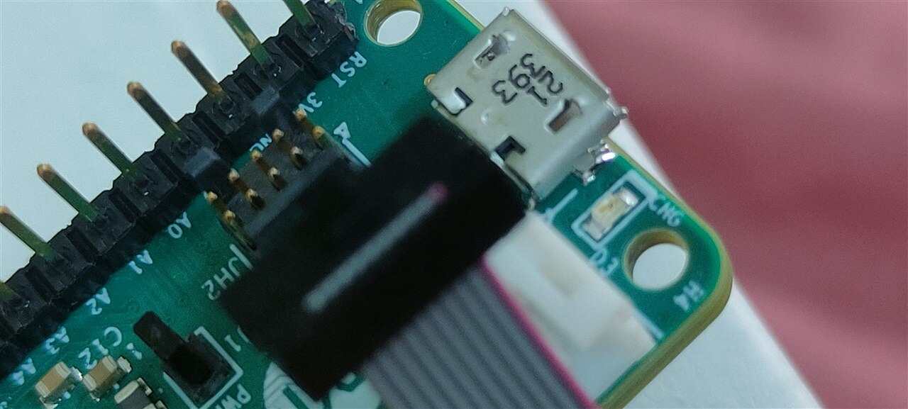

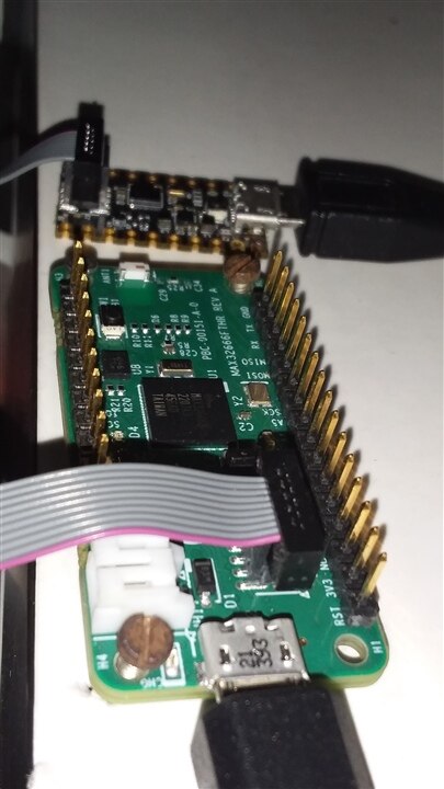

3) Connect the ribbon cable, The is 10- pin 2x5, 1.27mm IDC (insulation-displacement contact), also known as insulation-piercing contact (IPC) Socket-Socket flat ribbon cable.
Note : The cable has more pins than needed by board. Also insert it properly with the cable hood into socket hole as in the image gallery.

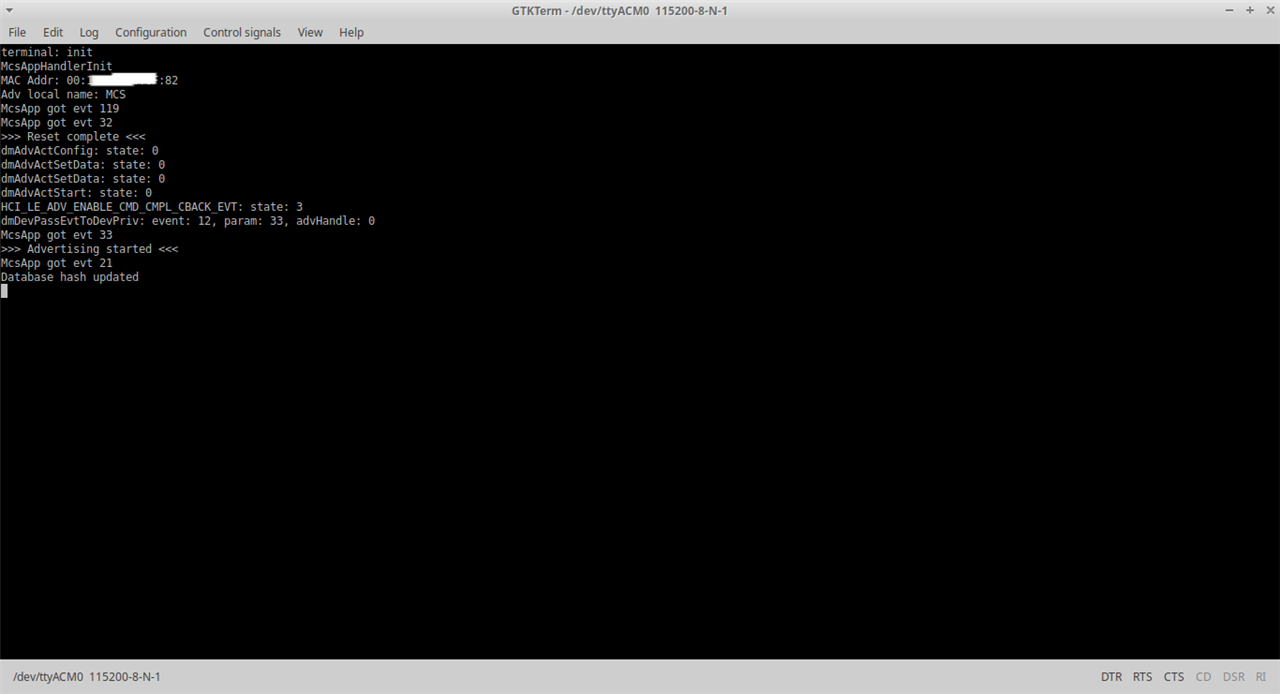

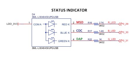

5) Now connect the USB cable from MAX32666FTHR to Ubuntu.It shows blue light blinking but the USB do not gets detected !
6) Now connect the ribbon IDC cable from MAX32666FTHR to MAX32625PICO and the USB cable from MAX32625PICO to Ubuntu.
7) Also, when MAX32625PICO is connected with USB to PC or laptop, whether standalone or with MAX32666FTHR, it gets detected and following is the content from 'DETAILS.TXT'

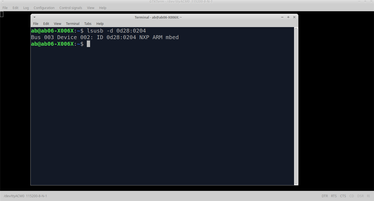

8) This MAX32625PICO, also gets detected by PC or laptop as below in the gallery
{gallery}maxoico

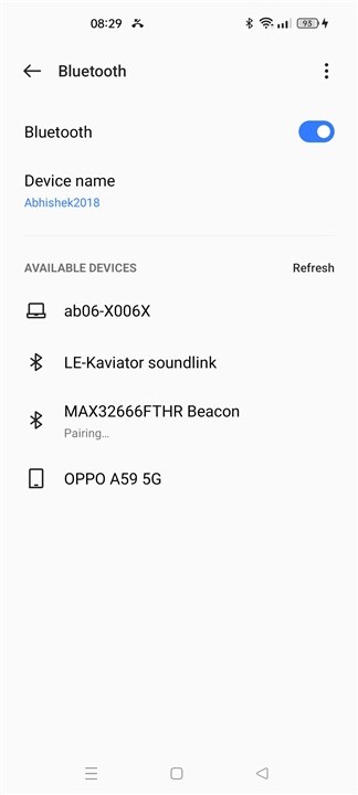

9) Lets also see the output of bluetooth
WIth just plug in of USB cable, bluetooth gets detected on Android Mobile but it does not get paired unless programmed or the board is open in IDE
{gallery}blue
The pairing and file transfer demo is shown in Project No. 8.

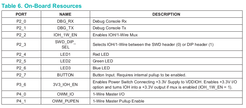

5.  Project 1
Project Title :  Welcome Message with LED toggling to RBG ON and OFF after 20 seconds with count
Description:   Welcome Message and the LED on MAX32666 switches ON after 20 seconds to RED and a messages is displayed on console, then this RED LED switches OFF after 20 seconds and second message is displayed on console, then after 20 seconds BLUE LED switches ON and a messages is displayed on console, then this BLUE LED switches OFF after 20 seconds and fourth message is displayed on console,  then after 20 seconds GREEN LED switches ON and a messages is displayed on console, then this GREEN LED switches OFF after 20 seconds and sixth message gets displayed on console,
Experimental Set Up:
Snippet :
//Author : Mr. Abhishek Bansal
//Company: New Era Consultancy Services
1000023c:   movs    r0, #1
1000023e:   bl      0x100003d0 <LED_On>
10000242:   ldr     r0, [pc, #116]  ; (0x100002b8 <main+188>)
10000244:   bl      0x1000177c <puts>
10000248:   mov     r0, r4
1000024a:   bl      0x100009d4 <MXC_Delay>
1000024e:   movs    r1, #2
10000250:   mov     r0, r5
10000252:   bl      0x100016b8 <printf>
10000256:   movs    r0, #1
10000258:   bl      0x10000414 <LED_Off>
1000025c:   ldr     r0, [pc, #92]   ; (0x100002bc <main+192>)
1000025e:   bl      0x1000177c <puts>
10000262:   mov     r0, r4
10000264:   bl      0x100009d4 <MXC_Delay>
10000268:   movs    r1, #3
1000026a:   mov     r0, r5
1000026c:   bl      0x100016b8 <printf>
10000270:   movs    r0, #2
10000272:   bl      0x100003d0 <LED_On>
10000276:   ldr     r0, [pc, #72]   ; (0x100002c0 <main+196>)
10000278:   bl      0x1000177c <puts>
1000027c:   mov     r0, r4
1000027e:   bl      0x100009d4 <MXC_Delay>
10000282:   movs    r1, #4
10000284:   mov     r0, r5
10000286:   bl      0x100016b8 <printf>
1000028a:   movs    r0, #2
1000028c:   bl      0x10000414 <LED_Off>
10000290:   ldr     r0, [pc, #48]   ; (0x100002c4 <main+200>)
10000292:   bl      0x1000177c <puts>
10000296:   mov     r0, r4
10000298:   bl      0x100009d4 <MXC_Delay>
1000029c:   movs    r1, #5
1000029e:   mov     r0, r5
100002a0:   bl      0x100016b8 <printf>
100002a4:   movs    r0, #0
100002a6:   pop     {r3, r4, r5, pc}
100002a8:   cmp     r5, #0
100002aa:   lsls    r1, r6, #4
100002ac:   strh    r0, [r5, #38]   ; 0x26
100002ae:   asrs    r0, r0, #32
100002b0:   strh    r0, [r7, #38]   ; 0x26
100002b2:   asrs    r0, r0, #32
100002b4:   strh    r4, [r0, #40]   ; 0x28
100002b6:   asrs    r0, r0, #32
100002b8:   strh    r0, [r7, #40]   ; 0x28
100002ba:   asrs    r0, r0, #32
100002bc:   strh    r0, [r3, #42]   ; 0x2a
100002be:   asrs    r0, r0, #32
100002c0:   strh    r4, [r5, #42]   ; 0x2a
100002c2:   asrs    r0, r0, #32
100002c4:   strh    r4, [r3, #44]   ; 0x2c
100002c6:   asrs    r0, r0, #32
Output on MAX32666FTHR :
  • At 0:27 seconds, RED light ON
  • At 0:47 seconds, RED light OFF
  • At 1:07 seconds, BLUE light ON
  • At 1:27 seconds, BLUE light OFF
  • At 1:47 seconds, GREEN light ON
  • At 2:07 seconds, GREEN light OFF
Output on Console, GTK Terminal :

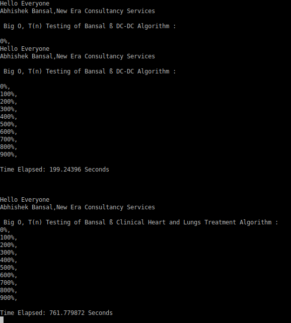

7. Project 3
Project Title :  Big O Computation Timing Analysis of Algorithm
Description:  Testing of computation time of algorithm on Analog Devices MAX32666FTHR - (a)  Testing (Big O, T(n)) of Bansal ß DC-DC Algorithm  (b) Testing (Big O, T(n)) of Bansal ß Clinical Heart and Lungs Treatment Algorithm
1) Dummy Algorithm 1 : Testing of Bansal ß DC-DC Algorithm
Time Elapsed: 199.24396 Seconds = 3 minutes 3207326667 seconds
Video : 00:00 - 03:21
2) Dummy Algorithm 2 :Testing of Bansal ß Clinical Heart and Lungs Treatment Algorithm
Time Elapsed:  761.779872 Seconds = 12 minutes 6963312 Seconds
Video :  03:22- 16:12

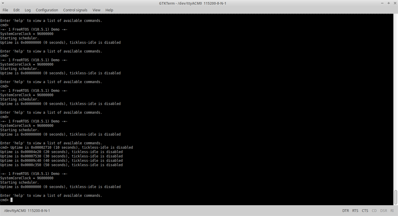

8. Project 4
Project Title :  Implementing Real-Time Operating System on Analog Devices MAX32666FTHR
Description:  This project implements FreeRTOS (https://www.freertos.org/) on Analog Devices MAX32666
Snippet :
#include "FreeRTOS.h"
#include "FreeRTOSConfig.h"
void vRegisterCLICommands(void);
SemaphoreHandle_t xGPIOmutex;
TaskHandle_t cmd_task_id;
unsigned int disable_tickless = 1;
mxc_gpio_cfg_t uart_cts = { MXC_GPIO0, MXC_GPIO_PIN_8, MXC_GPIO_FUNC_IN, MXC_GPIO_PAD_WEAK_PULL_UP,
                            MXC_GPIO_VSSEL_VDDIOH };
mxc_gpio_cfg_t uart_rts = { MXC_GPIO0, MXC_GPIO_PIN_11, MXC_GPIO_FUNC_OUT, MXC_GPIO_PAD_NONE,
void vAssertCalled(const char *const pcFileName, uint32_t ulLine)
void vTask0(void *pvParameters)
    TickType_t xLastWakeTime;
    unsigned int x = LED_OFF;
    xLastWakeTime = xTaskGetTickCount();
    while (1) {
        if (xSemaphoreTake(xGPIOmutex, portMAX_DELAY) == pdTRUE) {
            if (x == LED_OFF) {
                x = LED_ON;
            } else {
                x = LED_OFF;
             xSemaphoreGive(xGPIOmutex);
         vTaskDelayUntil(&xLastWakeTime, configTICK_RATE_HZ);
 async_read_req.uart = ConsoleUART;
    async_read_req.rxData = &tmp;
    async_read_req.rxLen = 1;
    async_read_req.txData = NULL;
    async_read_req.txLen = 0;
    async_read_req.callback = vCmdLineTask_cb;
    void WUT_IRQHandler(void)
    MXC_WUT_IntClear();
    NVIC_ClearPendingIRQ(WUT_IRQn);
volatile int i;
    for (i = 0; i < 0xFFFFFF; i++) {}
     MXC_GPIO_Config(&uart_cts);
    MXC_GPIO_Config(&uart_rts);
     MXC_GPIO_OutClr(uart_rts.port, uart_rts.mask);
    turnOffUnused();
     MXC_WUT_Init(MXC_WUT_PRES_1);
    mxc_wut_cfg_t wut_cfg;
    wut_cfg.mode = MXC_WUT_MODE_COMPARE;
    wut_cfg.cmp_cnt = 0xFFFFFFFF;
        MXC_GPIO_OutSet(uart_rts.port, uart_rts.mask);
     MXC_WUT_Edge();
    pre_capture = MXC_WUT_GetCount();
    MXC_WUT_SetCompare(pre_capture + wut_ticks);
    MXC_WUT_Edge();
    LED_Off(SLEEP_LED);
    deepSleep();
    LED_On(SLEEP_LED);
    post_capture = MXC_WUT_GetCount();
    actual_ticks = post_capture - pre_capture;
    LED_On(1);
    portENTER_CRITICAL();
    vTaskStepTick((actual_ticks / WUT_RATIO));
Output on MAX32666FTHR Board :

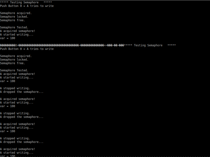

9. Project 5
Project Title and Description :  Testing Semaphore on ADI MAX32666FTHR

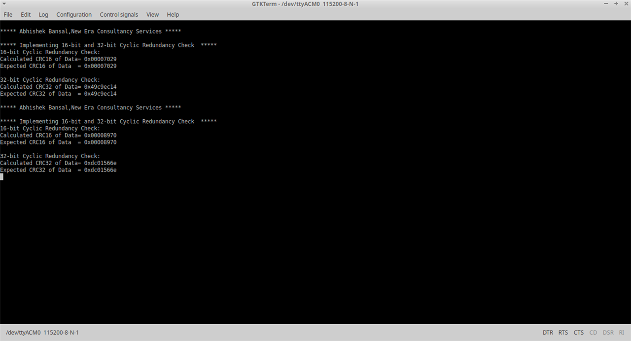

10. Project 6

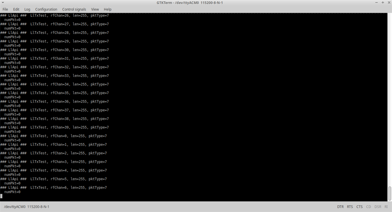

Project Title :  Implementing 16-bit and 32-bit Cyclic Redundancy Check
Snippet :
for (i = 0; i < len; ++i) {
        temp = (data[i] & 0xFF);
        for (j = 0; j < 8; ++j) {
            if ((temp ^ crcval) & 1) {
                crcval >>= 1;
                crcval ^= polynomial;
            } else { crcval >>= 1; }
            temp >>= 1;}}

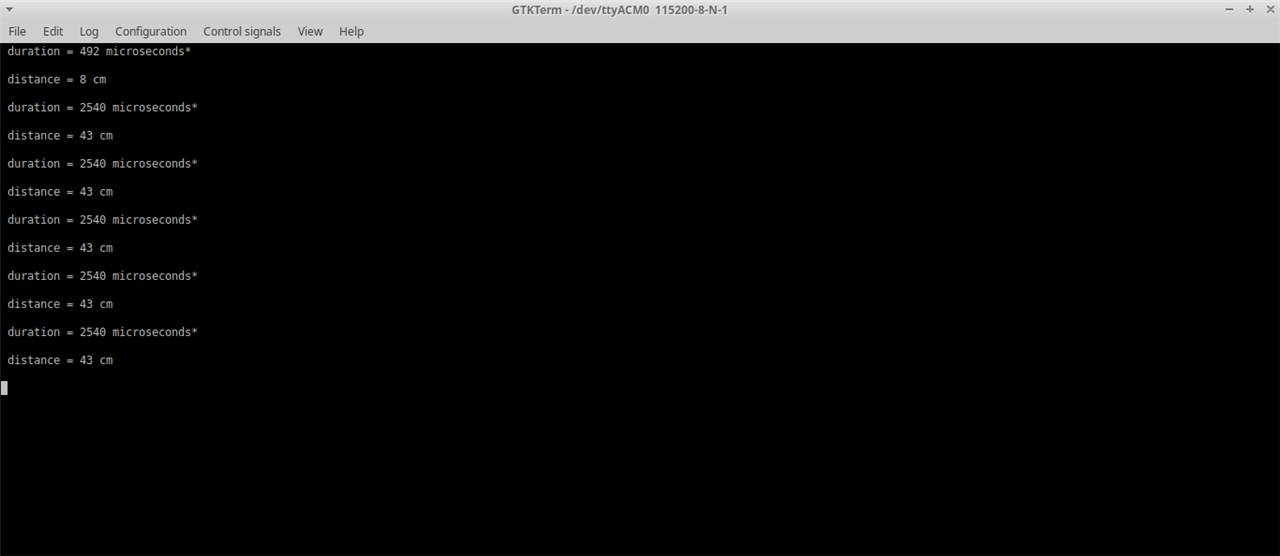

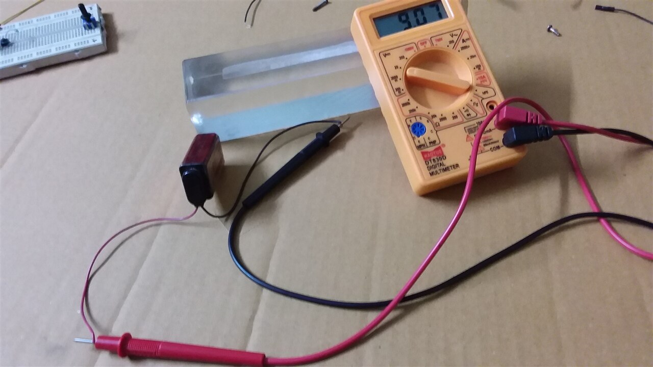

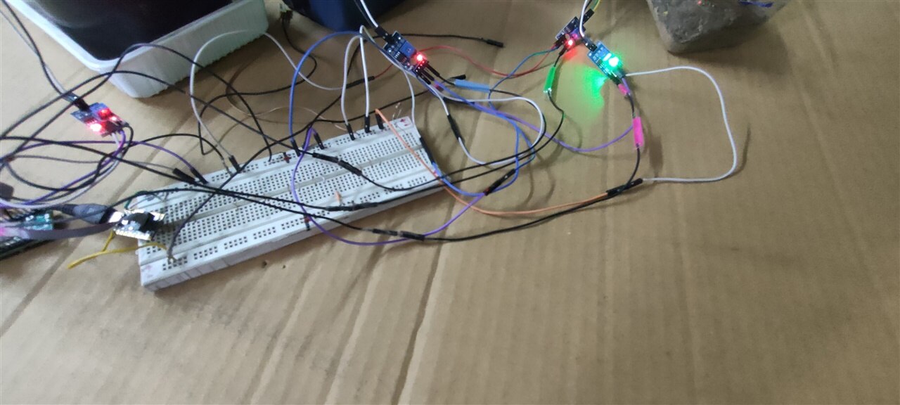

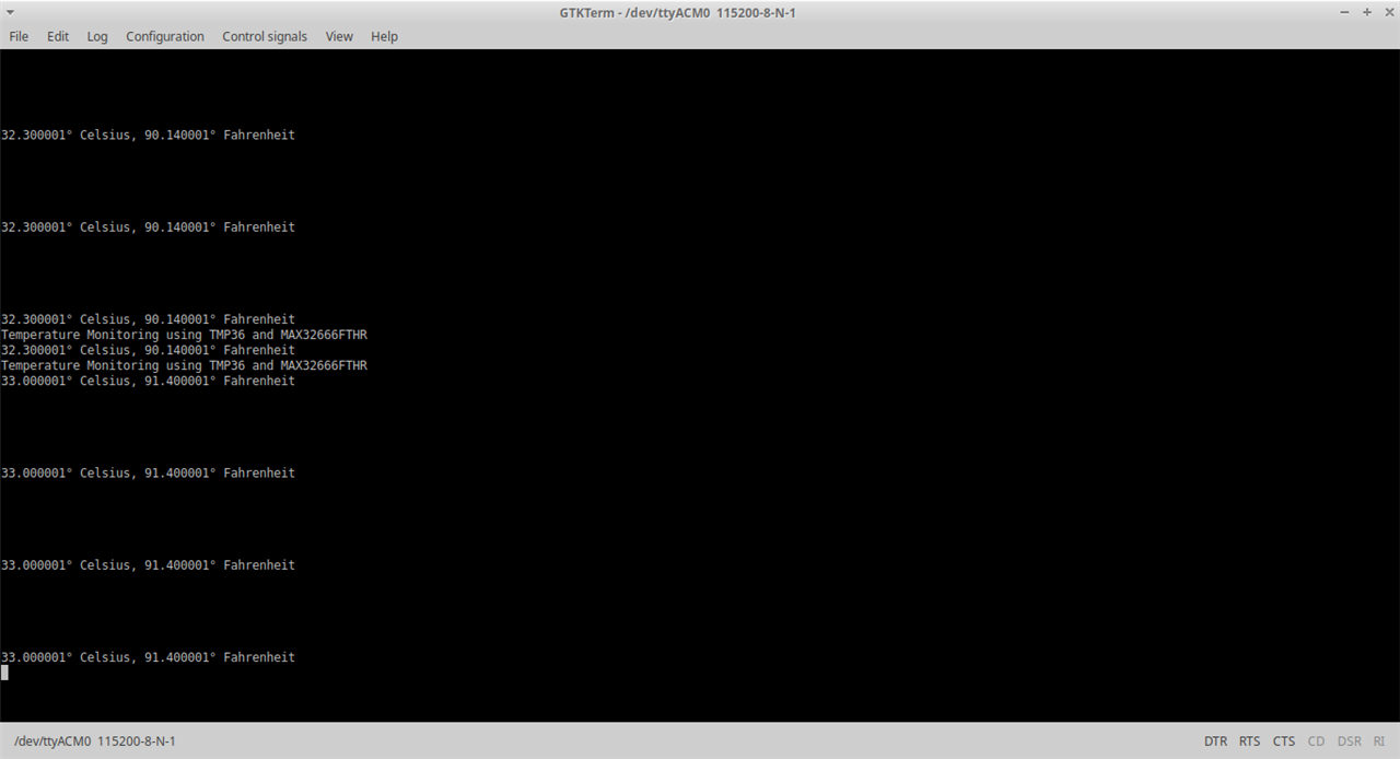

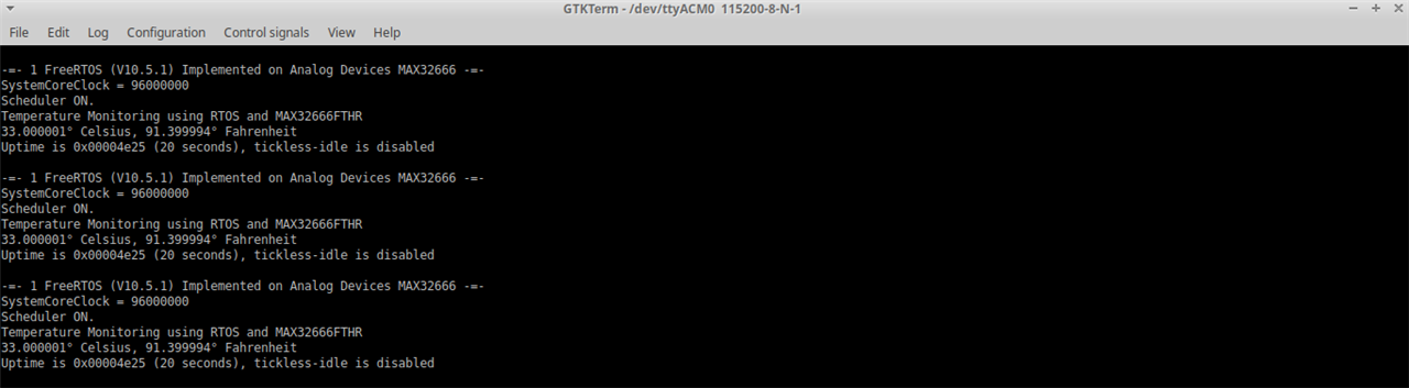

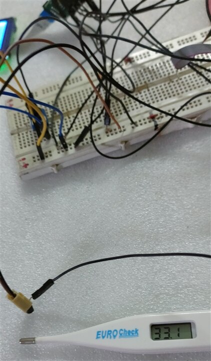

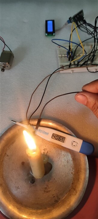

11. Project 7
Project Title : Testing Codes for Temperature Sensor TMP36 with ADI MAX32666FTHR
Description:  The temperature sensor TMP36 is interfaced with Analog Devices MAX32666FTHR at analog input of 10-bit ADC.
  1. Code 1 : Simple Interfacing, testing with extermal thermometer with the temperature displayed on GTK Terminal
  2. Code 2 : Repeating the same code and experimental setup as in (1) but now candle is used to increase temperature. Moreover, the development board MAX32666FTHR has RTOS (FREERTOS) implemented. So, this basicaly a RTOS based temperature measurement
Comparison by Thermometer and MAX32666 ADC Console, GTK Terminal :
1) Output of Code 1
A)
B)
2) Output of Code 2
A)
B)

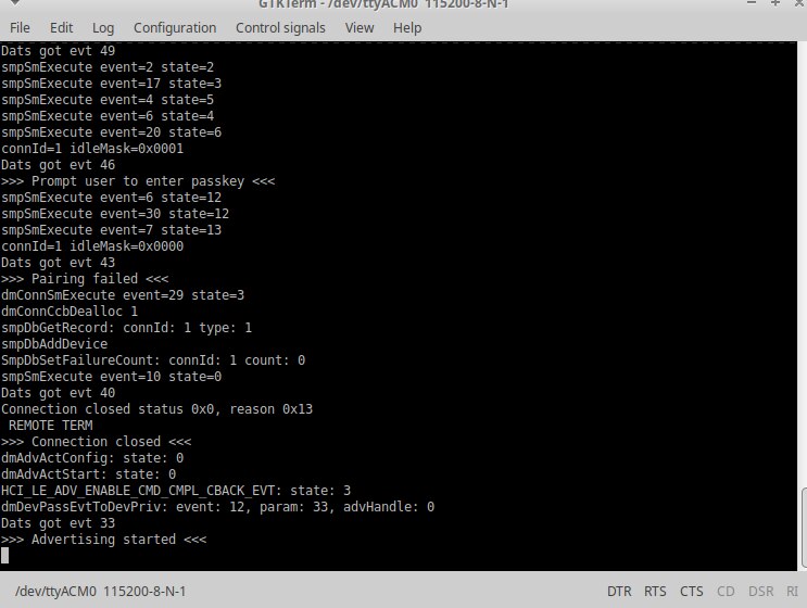

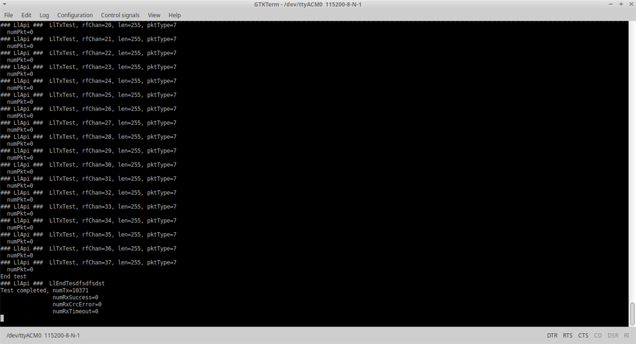

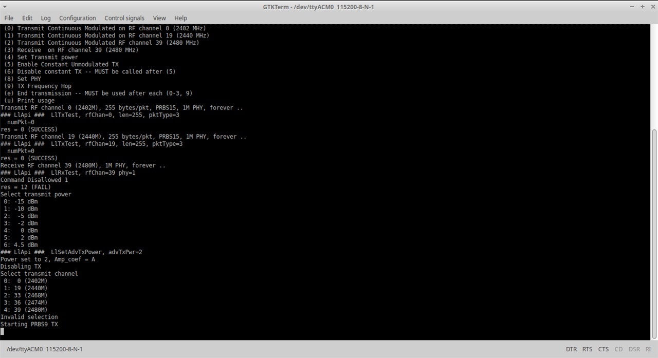

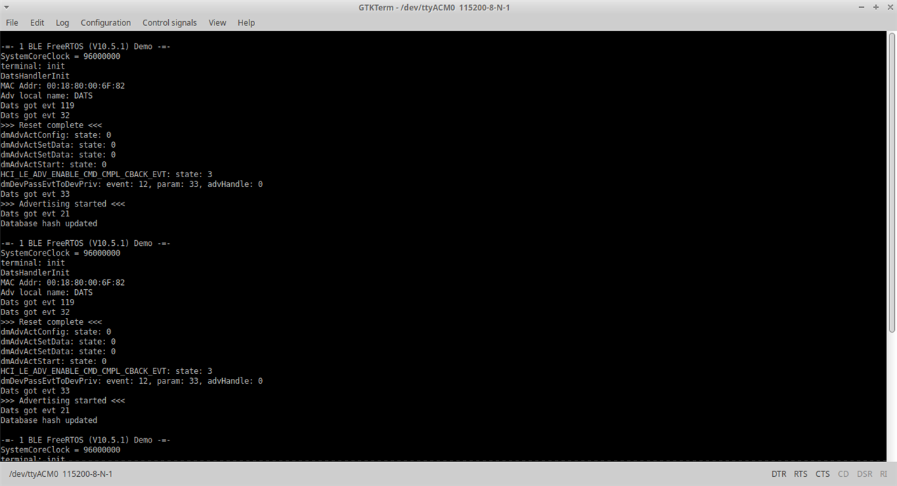

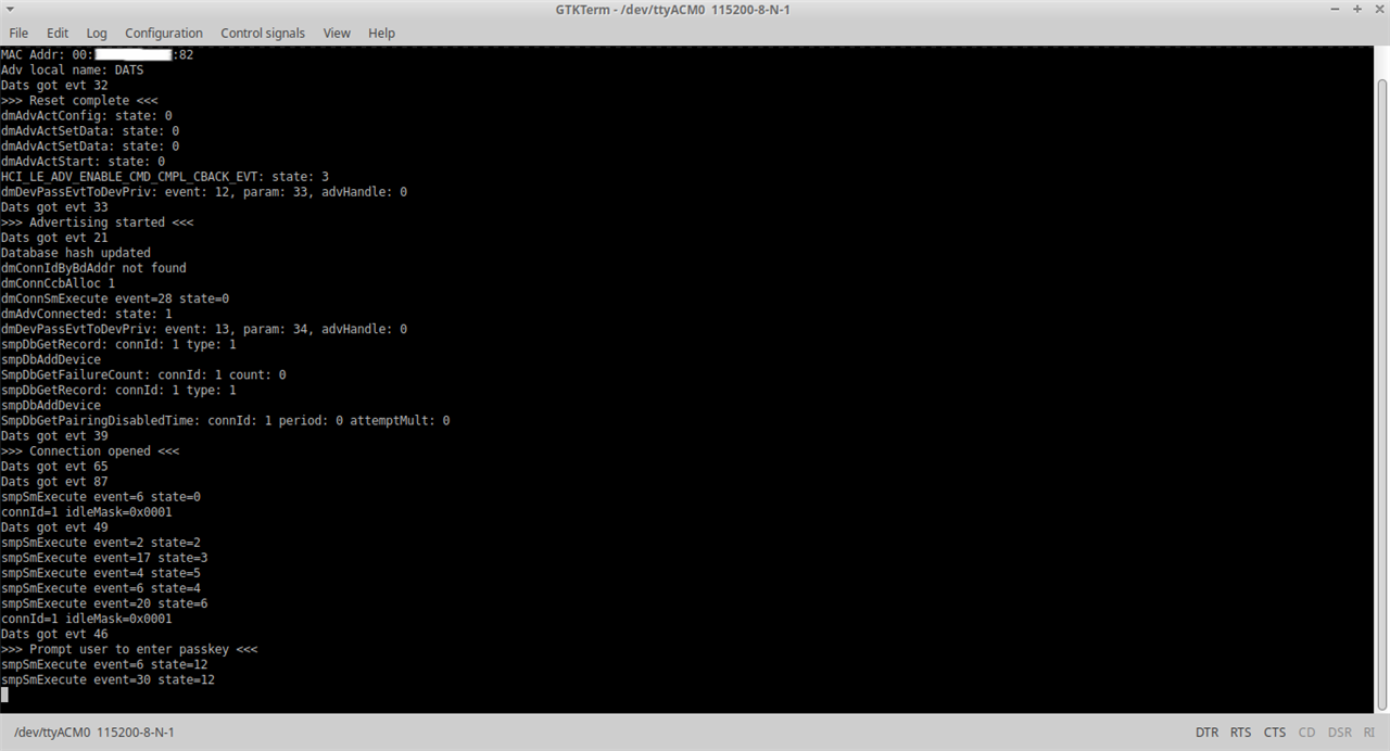

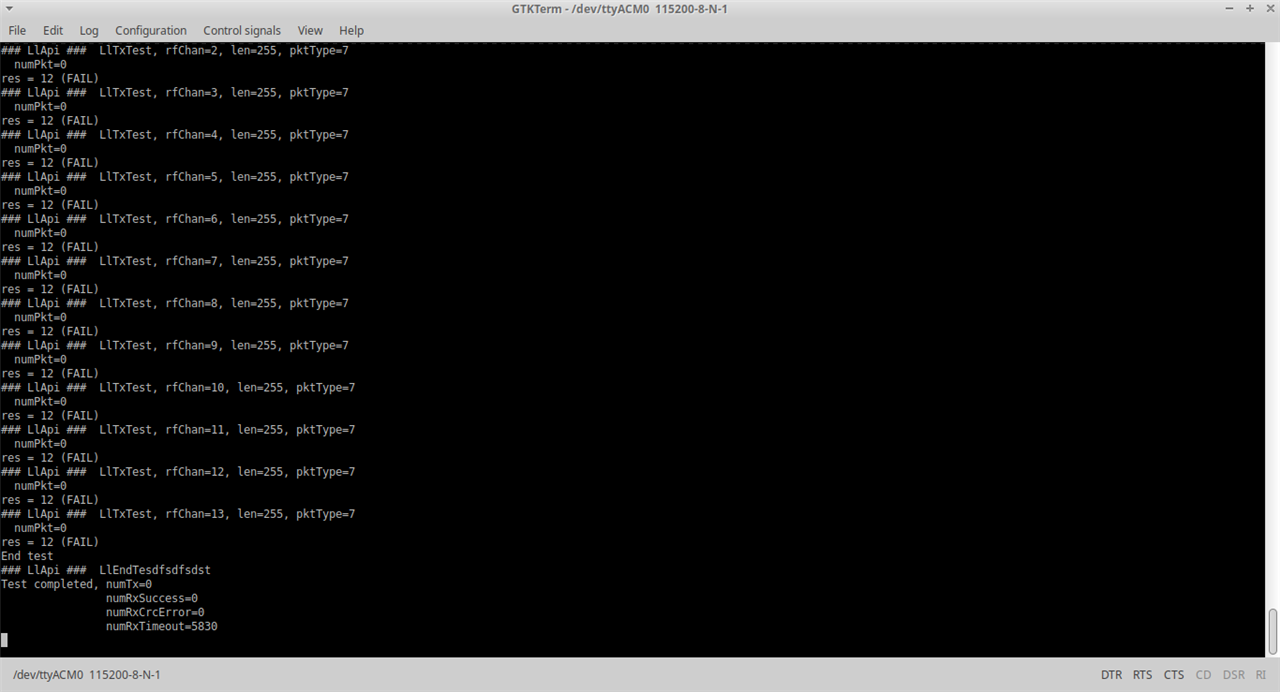

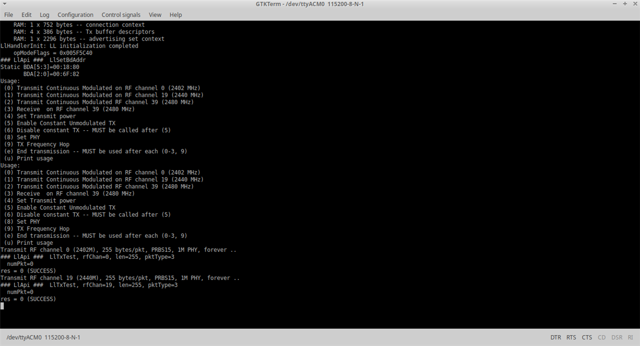

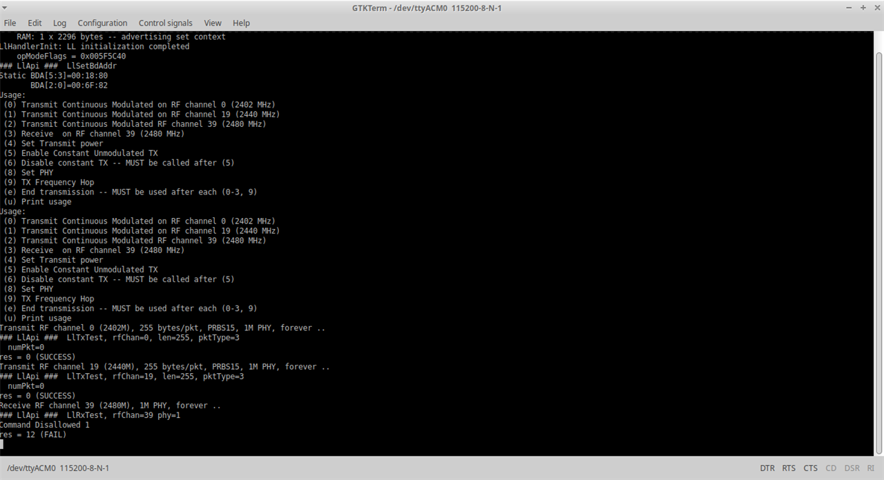

Project Title : Testing Codes On Inbuilt Bluetooth Surface Mount Antenna of ADI MAX32666FTHR
Description:  Testing different codes available on Internet (from Analog Devices) and seeing the output.
1) Output of Code 1
2) Output of Code 2
3) Output of Code 3, after Implementation of RTOS
4) Output of Code 4

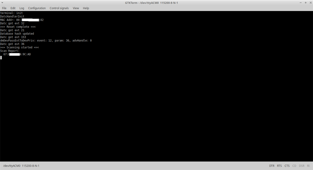

Here the Bluetooth name is not MAX32666FTHR but DAT, which can be seen in the screenshot - Adv local name
Detected but FAILED and not paired on Mobile Android
{gallery}BLUMAX32666

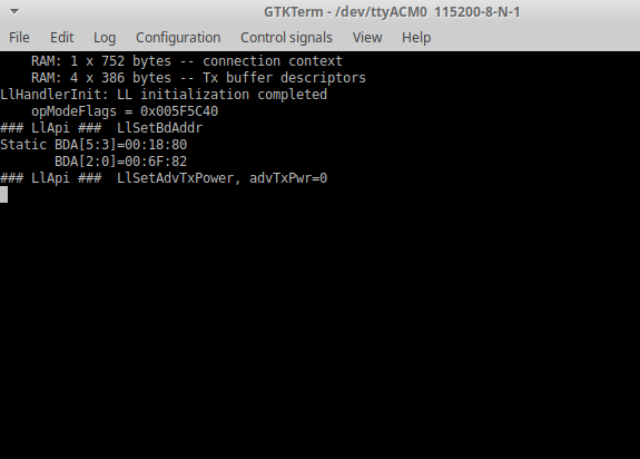

5) Output of Code 5
{gallery}blue5out

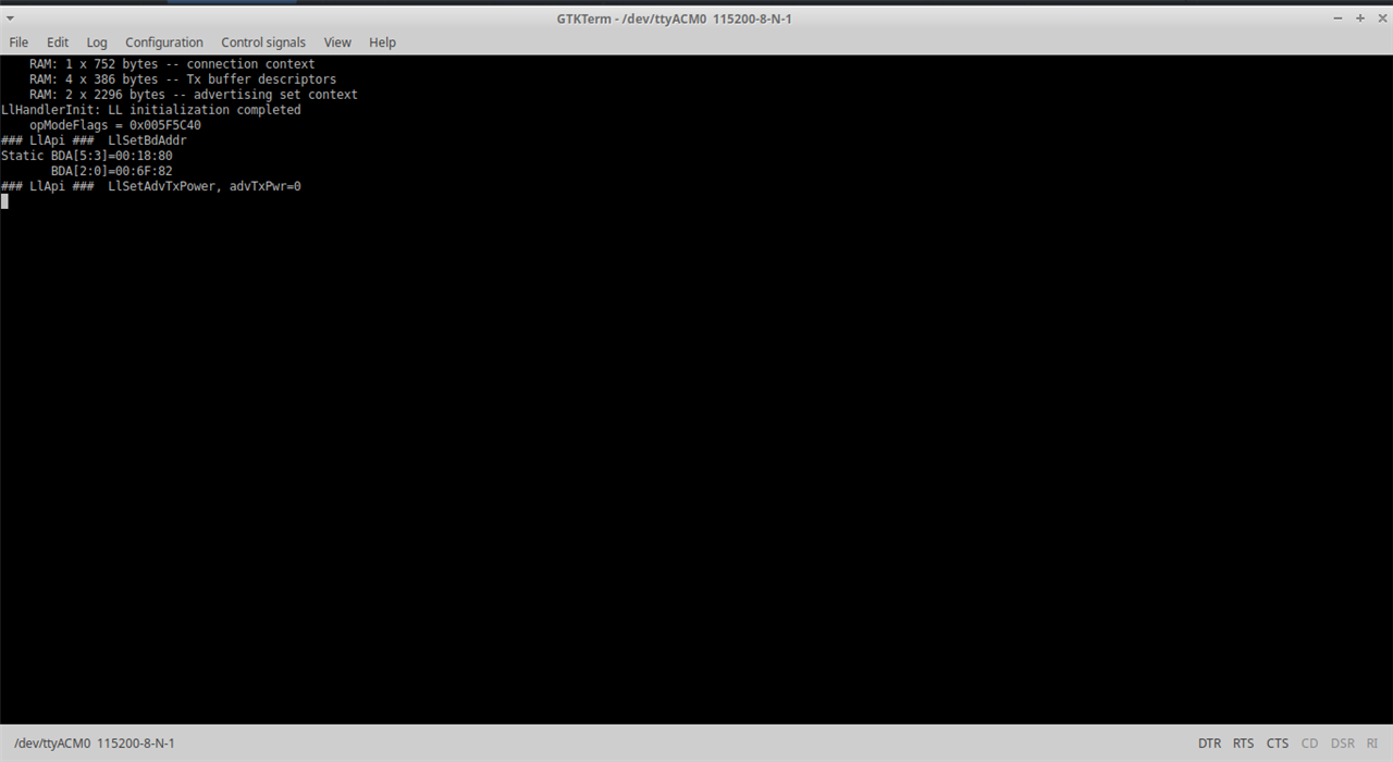

6) Output of Code 6
{gallery}b6ma

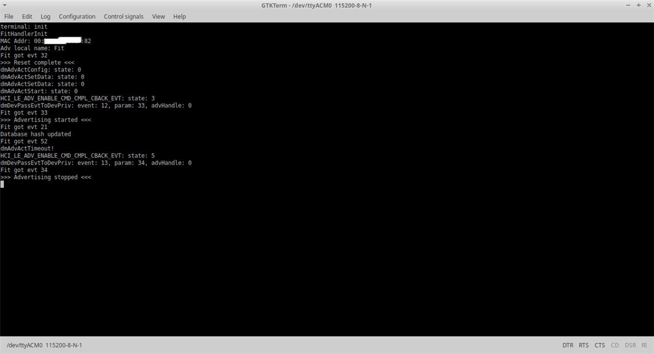

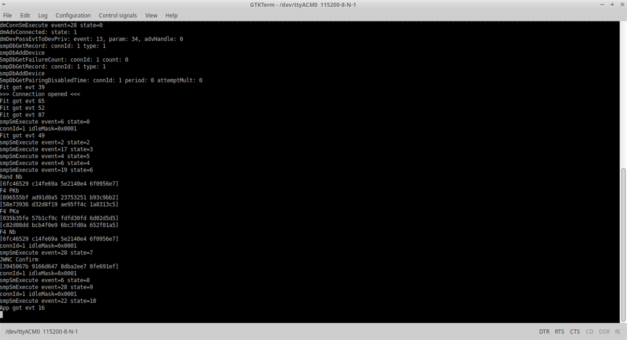

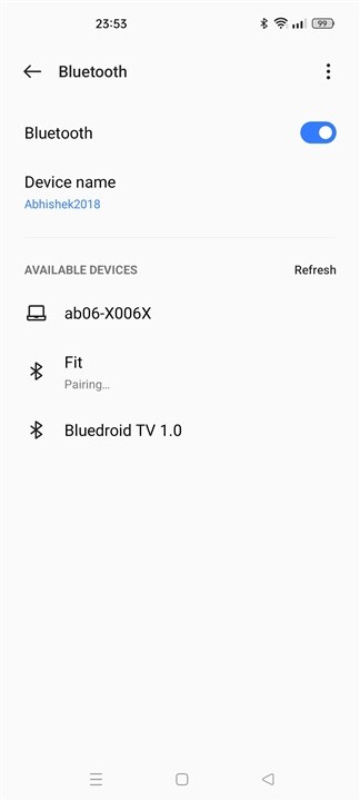

7) Output of Code 7
Here the Bluetooth name is not MAX32666FTHR but Fit, which can be seen in the screenshot - Adv local name
{gallery}B7BLU
SUCCESSFULLY PAIRED WITH ANDROID
{gallery}Bluetoothfit

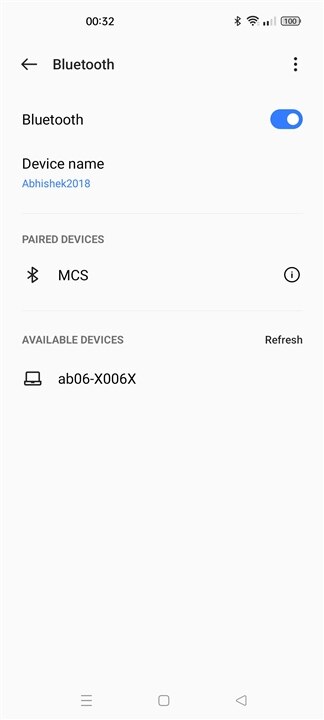

8) Output of Code 8

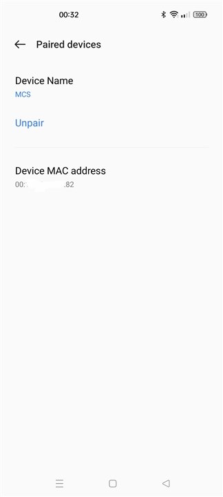

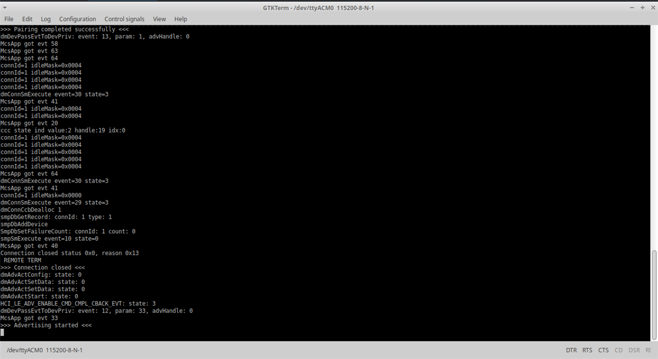

Here the Bluetooth name is not MAX32666FTHR but MCS, which can be seen in the screenshot - Adv local name
Code Snippet
#define PLATFORM_UART_TERMINAL_BUFFER_SIZE 2048U
#define DEFAULT_TX_POWER 0
#define BTN_SHORT_MS 200
#define BTN_MED_MS 500
#define BTN_LONG_MS 1000
#define BTN_1_TMR MXC_TMR2
#define BTN_2_TMR MXC_TMR3
enum {    MCS_APP_GATT_SC_CCC_IDX,
    MCS_APP_BT_CCC_IDX,
    MCS_APP_NUM_CCC_IDX};
    typedef union {
    wsfMsgHdr_t hdr;
    dmEvt_t dm;
    attsCccEvt_t ccc;
    attEvt_t att;
} mcsMsg_t;
static wsfBufPoolDesc_t mainPoolDesc[] = { { 16, 8 }, { 32, 4 }, { 192, 8 }, { 256, 8 } };
static void mainWsfInit(void)
{const uint8_t numPools = sizeof(mainPoolDesc) / sizeof(mainPoolDesc[0]);
    uint16_t memUsed;
    WsfCsEnter();
    memUsed = WsfBufInit(numPools, mainPoolDesc);
    WsfHeapAlloc(memUsed);
    WsfCsExit();
    WsfOsInit();
    WsfTimerInit();}
{gallery}MCS
{gallery}mcsconncted

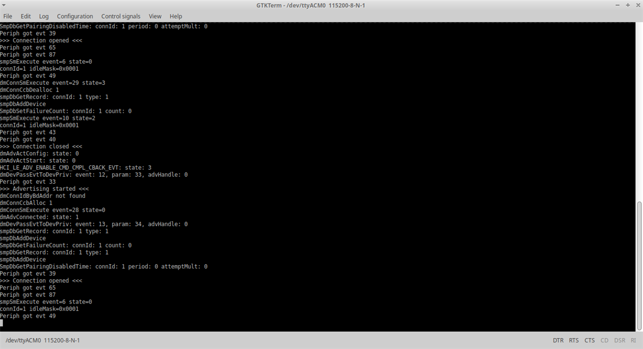

9) Output of Code 9

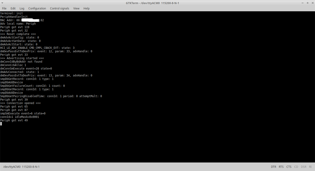

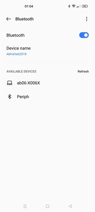

Here the Bluetooth name is not MAX32666FTHR but Periph, which can be seen in the screenshot - Adv local name
{gallery}peirph2
{gallery}perih2

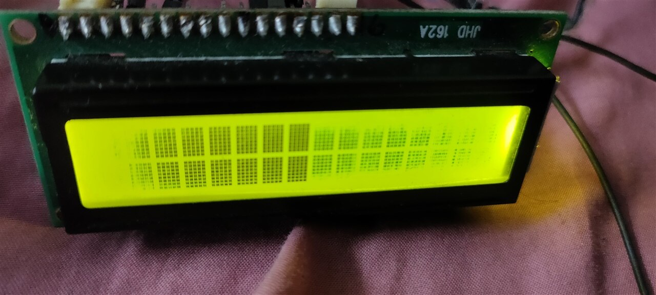

Project Title : 16x2 LCD on Analog Devices MAX32666
16x2 LCD setup on Analog Devices MAX32666
1) Output of Code 1
2) Output of Code 2
16. Project 12

Project Title : Voltmeter with ADI MAX32666FTHR vs DMM Voltmeter
Voltage using DMM(Digital Multimeter)
The error of 0. 93 Volts is due to voltage divider.

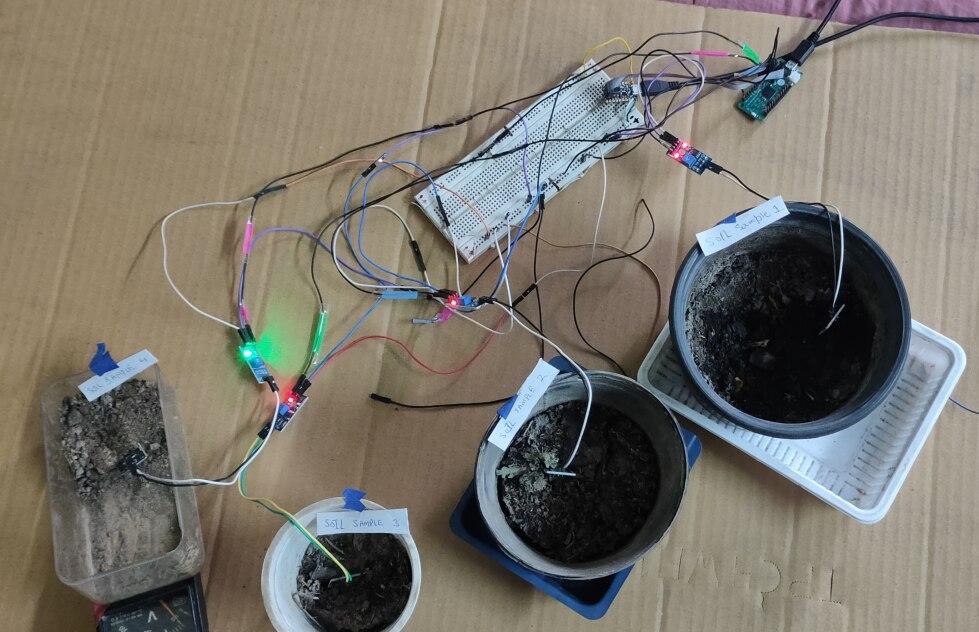

Project Title : Soil Moisture Percentage and Level in Four Soil Samples Using ADI MAX32666FTHR
{gallery}soilexp

Project Title : Interfacing HC-SR04 with ADI MAX32666FTHR
1) Output  1
2) Output  2
The distances are not correct !
